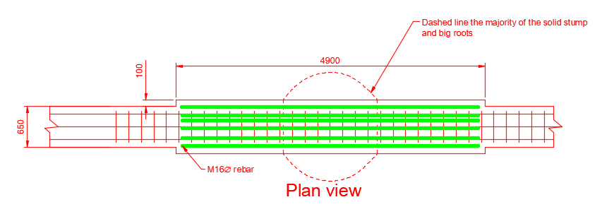

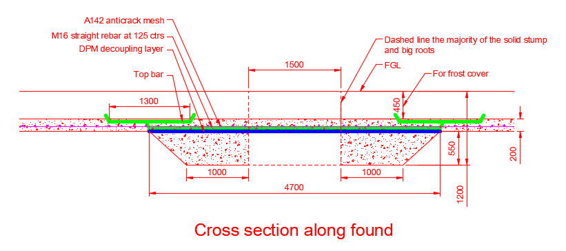

On 30/04/2023 at 11:51, Deejay_2 said:
I assume engineer designed would mean piles, so if I employ a SE he may be "duty bound" to say piles are necessary because of the requirements of NHBC.
No an SE is not "duty bound". A lot of the NHBC information is for guidance. If you can show that the site conditions require a different approach and you can as an SE justify that then no problem.
I made a long post before about the things you need to consider. If it was me and things looked promising I would have a look at something along the lines of the very rough sketch below and start to tweak the design to get it just right. I have not shown the top bars on the plan view.
Key ponts are:
1/ The concrete is all cast in the one pour with the same mix of concrete. You pour the deeper trench fill bit under the blue line which is bit of DPM plastic. Smooth that off, go and pour concrete around the rest of the found.
2/ At the same time drop in the A142 mesh over the stump area and the M16 bars.
3/ Finish pouring the found over the stump area dropping in the top bars when you go. By that time the trench fill bit will have taken up a bit.
4/ The DPM decouples to some extent the reinforced part of the found from the deeper "trench fill" looking bit below. This means you don't have to follow for example the rules for steps in founds and if the deeper thicker concrete shrinks more than the rest of the found the shrinkage stress is less likely to be transferred to the strip or vs versa.
5/ Make the bar length so you can cut them from stock lenghts. Here the bar length are base on a stock length of 6.0 m
6/ The short 1.3m top bars are there in case the trench fill bit works too well and creates a hard spot that would cause the found to crack where the trench fill comes up to meet the rest of the strip found.
7/ The found is widened locally a bit just to reduce the bearing stress on the ground below.
