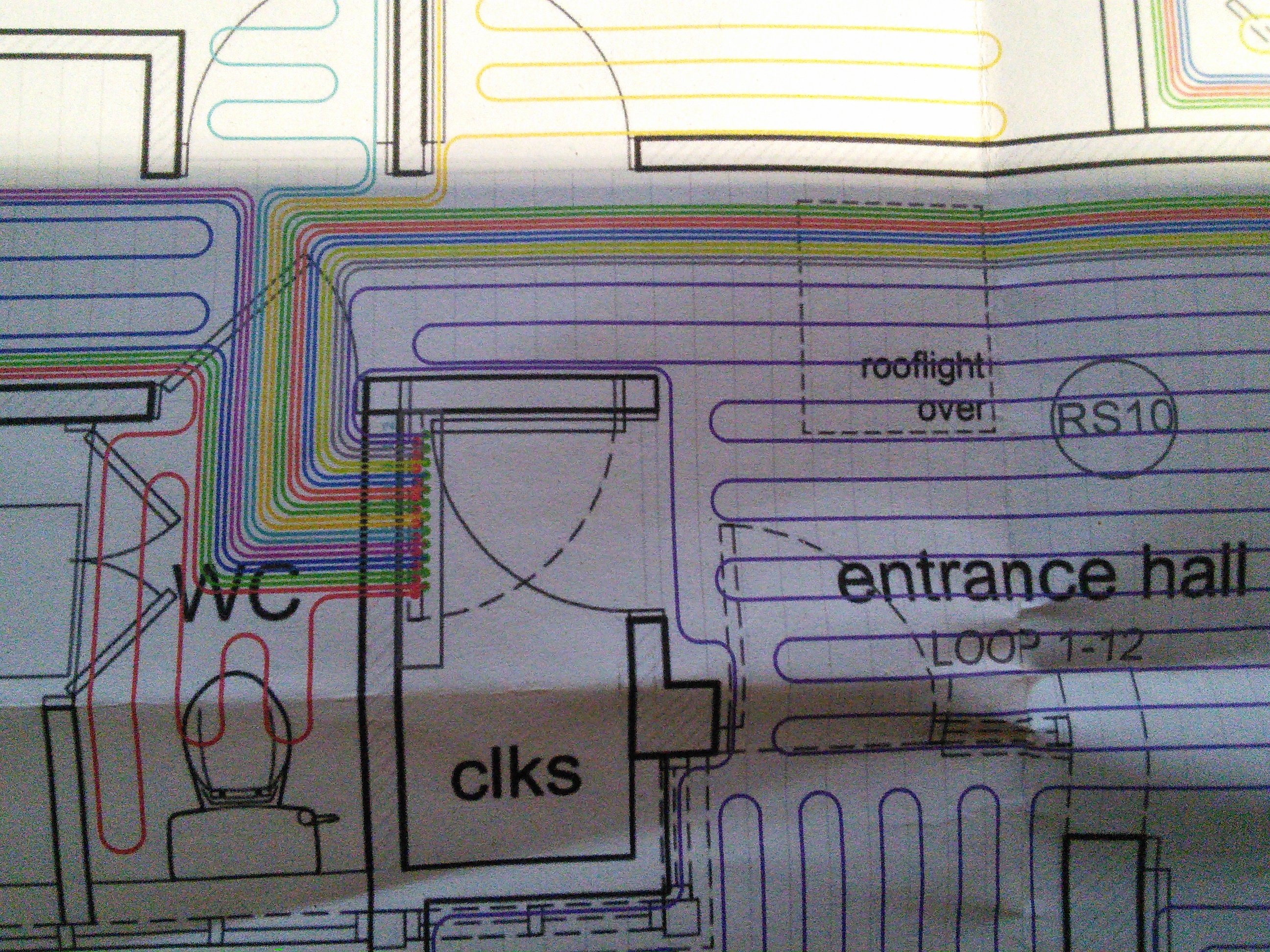

So I have started laying the pipework for my 12 port manifold. Areas are getting pretty congested with the feed and return pipework.
As you can see from the pics, the WC room is worse than the M25 on a bank holiday. So it may get a bit warm in there...
Should I try and space them out equally and as mush as possible? What is the optimal min distance?
Or should I "just insulate every other pipe in the congested areas with
9mm wall armorflex" a la @Nickfromwales? Only hesitation is I'm not sure whether I have sufficient room to insulate every other pipe. Also I'd need the slitted stuff which looks a bit pricey too. I also don't wanto end up with a very thick diameter as my concrete slab is only 100mm thick. Also, 16mm pipes are cable tied to A142 mesh.
I have some long feeds and return legs as well, and I am tempted maybe to leave 30-40mm between the pipes. I don't mind a bit of 'overheating' along the peripheries of some rooms (see entrance hall) as long as there are no implications for the concrete slab.

A WC is an extracted room for MVHR so whilst it may get a bit warm it should be fine.
You could go via your cloakroom on that picture - is that where the manifold is ..?
This was mine - got as close as I could using the stick on pipe rails. I've got some spare if you want them ..?
Just one thought, which I am sure you have thought through, in the WC pipework you have the heat / pipe under the pan and most pans are fixed down with screws so extra care needed when drilling the fixing holes! An alternative, given the other pipework in the room as @PeterW says heating the WC area, you could delete that section of the loop or at least ensure no pipework is anywhere near where a drill might be used to fix down the pan.

If the WC is congested you could route the right hand set of feed and returns under the door of the cloakroom.

Bit of a strange one...Wunda screwed up with their plans. My intended location for the manifold was in one of the hallway cupboards and despite me sending them scaled drawings in was only much later that they admitted the manifold would be too big to fit their. So I had to come up with another central-ish location. Cloakroom still has the old slab in situ, so I have had to conduit the pipework through the base of the wall/slab floor and up the wall to where the manifold is now located.
Thanks for the piperails, but I've got the mesh in place already, but can use the pipe rail spacing as a guide then.Is that approx 25mm spacing?
Hi Mike, yes, I was suddenly forced to start looking at toilet options/designs and started looking for templates as to where exactly the screw holes would go. I then tried a few layouts when I was laying the pipe and rather risk anything, I have opted to go for a wall hung toilet. A bit more expensive but easier for me right now! And it's a small room, so a wall hung will hopefully make it appear a bit larger. I've always wanted a urinal actually, but the boss doesn't like that idea, despite there being a WC next door in the bathroom.

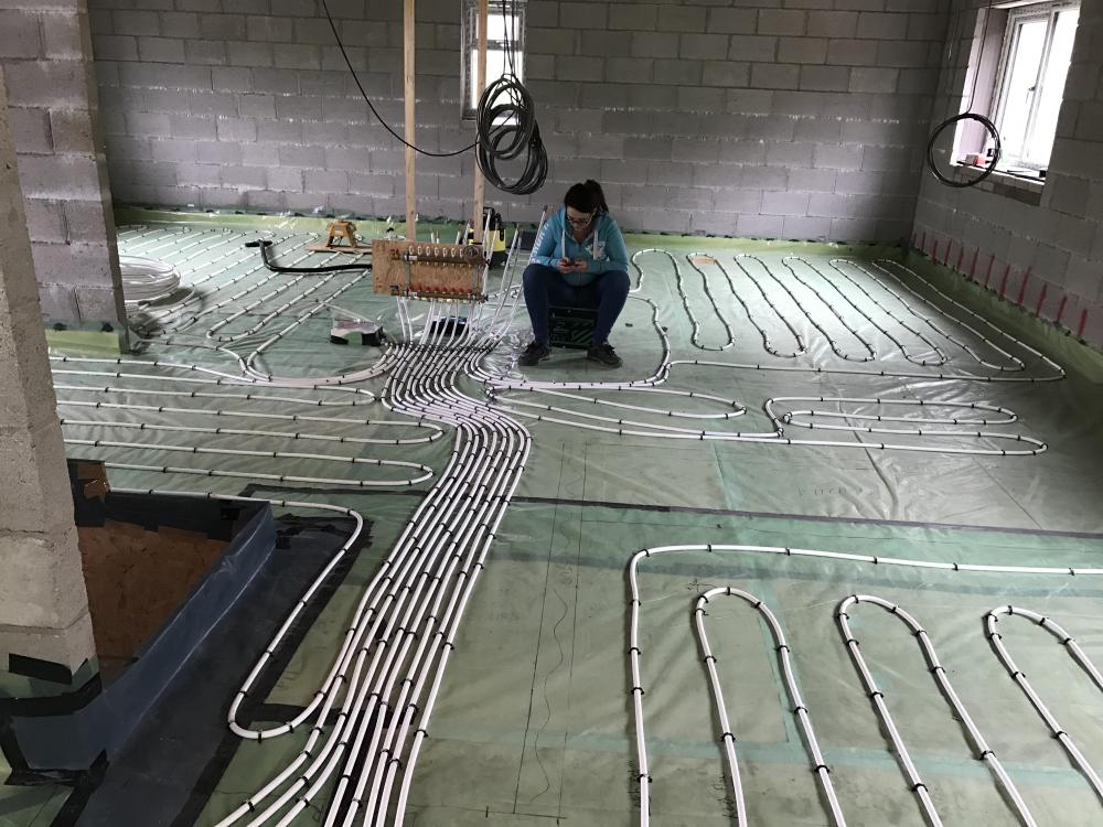

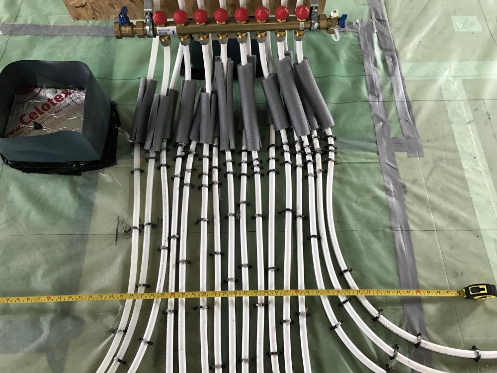

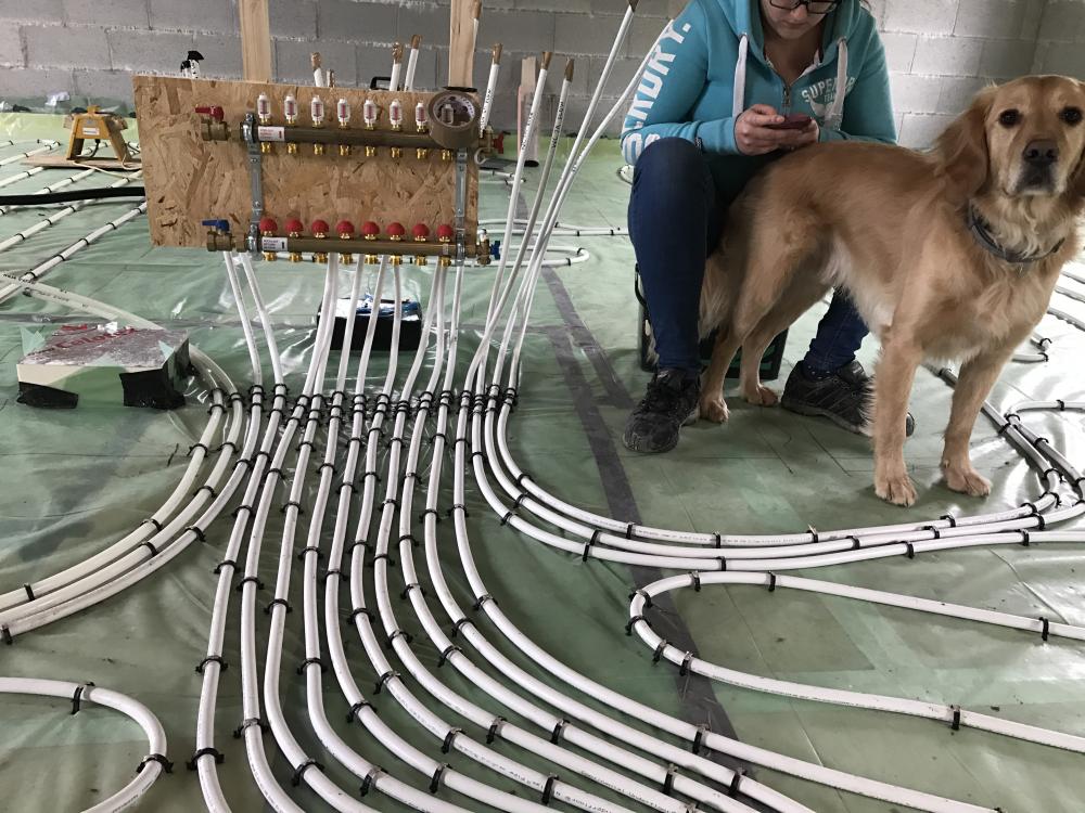

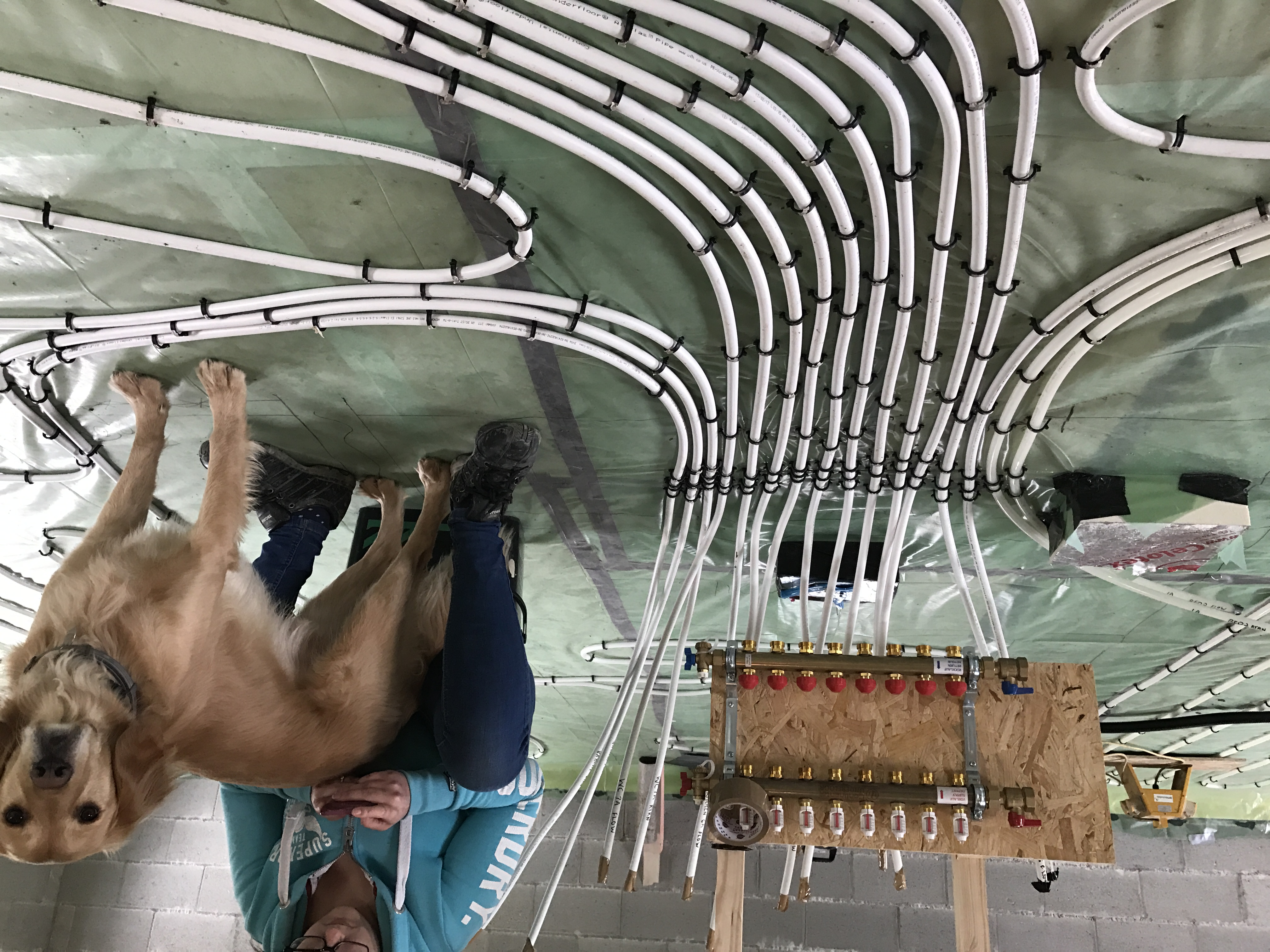

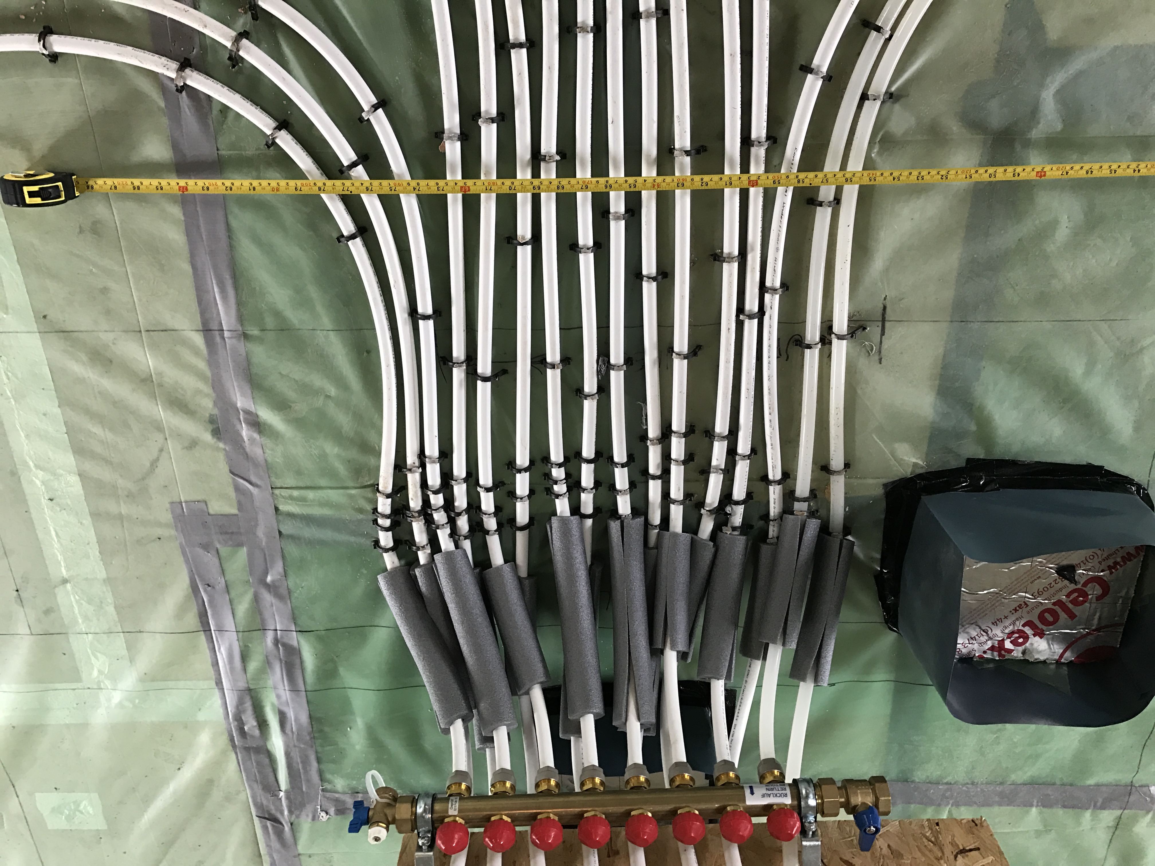

Here's mine, congested yes. Note I only added a bit of Insulation lagging as a suggestion from the liquid screed guy to buy myself a little bit of play when I adjust the position of the manifold / board.
Thanks for the pics. Mine is beginning to look like that now. Good to see you had plenty of help there though!

All too late. Cloakroom is the only room that has not had the original slab removed -  with wall on slab. I'm halfway through putting the pipework in and the manifold ain't movin'! I was seriously peed off that Wunda screwed up with their inability to realise that their manifold (circa 1000mm)  would be too big for my 850mm hall cupboard. So what I have now is as good as it gets locations.
It's all looking a bit like I've dropped a giant's plate of spaghetti in that room at the moment. Pic to follow. Better start labelling those pipes before I forget....

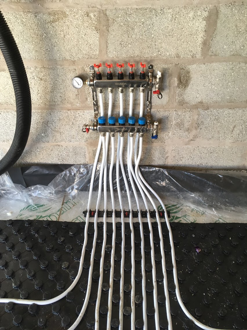

I've got one of these Polypipe panels spare (plus a few off cuts) if that would help space things:
https://www.tdlonline.co.uk/Heating/Polypipe-Underfloor-Heating/Polypipe-Solid-Floor/4100-/Polypipe-Floor-Panel-12m-x-1m-PB08576
Thanks, but I'm 1/2 way there now. I don't think the panel would actually fit this particular space in the WC. I have 24 pipes fighting for space.
100mm minimum with these panels:
2017-08-05_09-21-55
You can cut them into strips if it helps elsewhere, I used the multitool:
20170805_091339
Think I said elsewhere they are only about 30mm thick but that gets taken out of the 100mm slab depth and each "bulge" is about 90mm dia.
20170805_091356
Tbh with so many pipes that close together I don't think I'd want to compromise the slab there in the bathroom in any way.
Going thru the cloak and out that door gets my vote, you'd halve your problems.
You'll probably find the track mentioned by @PeterW useful then.
