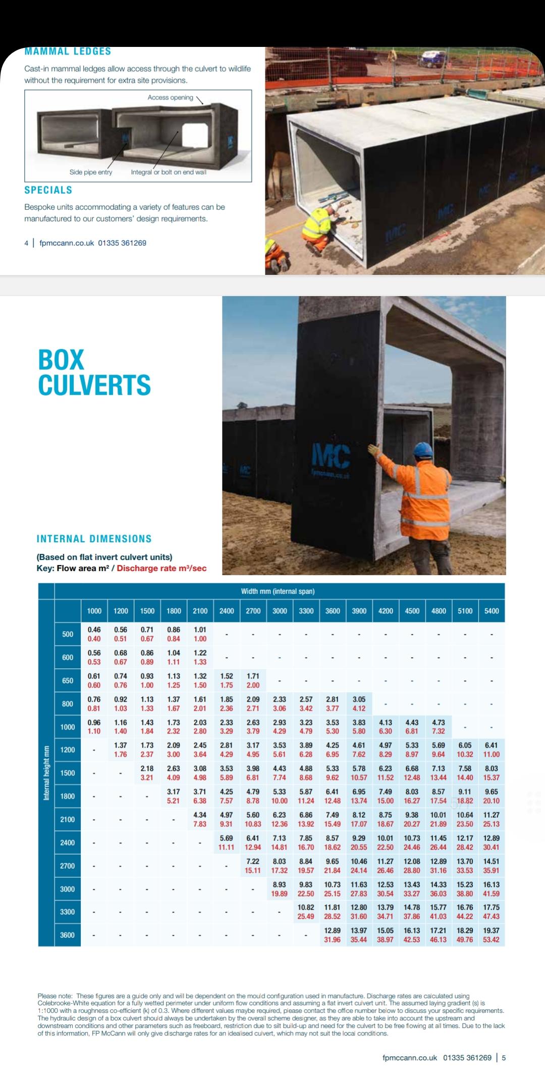

Iceverge Posted April 28, 2023 Posted April 28, 2023 As an off the wall idea you could use a precast box culvert turned on its side. Either dig a hole and drop it into it or....... And I like this idea.... Lay it the ground and start digging the soil out from around it, gradually allowing it to sink into the earth until the desired level is reached. Using the culvert as a trench box shutter should be pretty safe too. Pour a concrete floor with a sump and pump and you're done.
