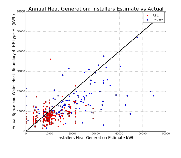

JohnMo Posted April 27, 2023 Share Posted April 27, 2023 There are only three complications to a heat pump, that a normal plumber needs to get his around. Everything else should be normal stuff. 1. Sizing the heat pump, for a retrofit taking the energy consumption for December and or January, will give you a good place to start, just a matter of a simple calculation and possibly a loading factor to make the average more realistic and representative of peak loading. 2. Radiators, as said give two options cheap and simple install, little or no changes, or more suitable install of correctly sized rads. 3. Hot water, keep existing cylinder, if one exists, heat via existing coil, top up with immersion. Or new cylinder. Or hot water on demand electric heater. A set of guidelines in plain English for the customer to tune weather compensation, which should really mandatory, to enable during commissioning, so the heat pump always operates at the lowest temp possible. 1 Link to comment Share on other sites More sharing options...
RichardL Posted April 27, 2023 Share Posted April 27, 2023 2 hours ago, JohnMo said: . Sizing the heat pump, for a retrofit taking the energy consumption for December and or January, That rule of thumb, if reasonable, is so much easier than the current MO of analyse heat loss in all rooms etc. I'm sure the latter is accurate, but if the former is close enough and based on real world heating requirements - thats the sort of thing any customer can also do to ball park the install size. IMHO That sort of - I can double check the 'expert/trader' & in my own mind confirm its the correct product process massively helps take-up. Link to comment Share on other sites More sharing options...
JohnMo Posted April 27, 2023 Share Posted April 27, 2023 I just calculated the following and it gives a close estimate to the heating demand I have. 3700 (total gas usage for Jan and Feb including DHW) / 1488 (number of days x 24) x 150% Gives around 3.7kW. Which fairly close to my heat demand at -9 (which we had over a couple of weeks during the period). The realistic ASHP would be 5 to 6kW. I have chosen a 6kW one as it happens. Link to comment Share on other sites More sharing options...
Roger440 Posted April 27, 2023 Share Posted April 27, 2023 1 hour ago, JohnMo said: I just calculated the following and it gives a close estimate to the heating demand I have. 3700 (total gas usage for Jan and Feb including DHW) / 1488 (number of days x 24) x 150% Gives around 3.7kW. Which fairly close to my heat demand at -9 (which we had over a couple of weeks during the period). The realistic ASHP would be 5 to 6kW. I have chosen a 6kW one as it happens. Im on oil. So no meter. So no easy way to tell. I can tell you annualmconsumption, but thats not really useful But, not that many oil installs, so i guess only a minor issue. Link to comment Share on other sites More sharing options...
Radian Posted April 27, 2023 Share Posted April 27, 2023 3 hours ago, JohnMo said: 1. Sizing the heat pump, for a retrofit taking the energy consumption for December and or January, will give you a good place to start, just a matter of a simple calculation and possibly a loading factor to make the average more realistic and representative of peak loading. In the quest for automation: For installations with a DCC feed from a smart meter, all you need is the owner's permission to read the GUID/MAC/EUI off the back of the IHD, along with their postcode and you've got a treasure trove of data to work with potentially covering several years. A single bit of code could take this info as input and spit out a sizing while you wait. Link to comment Share on other sites More sharing options...
JohnMo Posted April 27, 2023 Share Posted April 27, 2023 (edited) But you really only need to do do a room calculation of heat loss for sizing emitters, a whole house will be fine for sizing the overall heat demand, such as the calculation spreadsheet on building (and work out floor, wall and roof U values) @Radian posted just before me Edited April 27, 2023 by JohnMo Beaten to the post Link to comment Share on other sites More sharing options...
JamesPa Posted April 27, 2023 Author Share Posted April 27, 2023 (edited) 2 hours ago, RichardL said: That rule of thumb, if reasonable, is so much easier than the current MO of analyse heat loss in all rooms etc. I'm sure the latter is accurate, but if the former is close enough and based on real world heating requirements - thats the sort of thing any customer can also do to ball park the install size. Actually there is ample evidence to suggest that a room by room analysis is not at all accurate. See this report https://assets.publishing.service.gov.uk/government/uploads/system/uploads/attachment_data/file/606834/Report_on_compliance_with_MCS_installation_standards_v32.pdf and in particular this graph My distinct feeling is that whole house sizing based on experimental measurement may be a much more accurate than trying to do the fabric calculations. Of course I believe the physics of the calculations, but there are quite a few real uncertainties and, if my personal experience is anything to go by, surveyors ignore too many important factors. Edited April 27, 2023 by JamesPa 1 Link to comment Share on other sites More sharing options...
Radian Posted April 27, 2023 Share Posted April 27, 2023 3 minutes ago, JamesPa said: My distinct feeling is that whole house sizing based on experimental measurement may be a much more accurate than trying to do the fabric calculations. Of course I believe the physics of the calculations, but there are quite a few real uncertainties and, if my personal experience is anything to go by, surveyors ignore too many important factors. "As built" is rarely as good as "as designed". Sloppy detail, airtightness etc. make a spreadsheet analysis liable to inaccuracies. 1 Link to comment Share on other sites More sharing options...

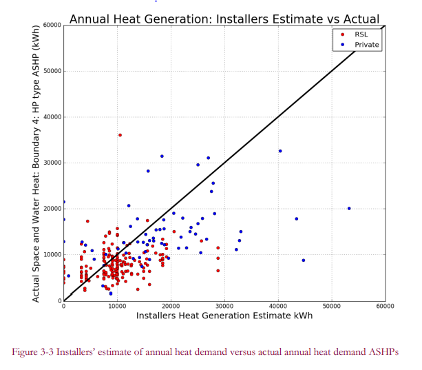

JamesPa Posted April 27, 2023 Author Share Posted April 27, 2023 (edited) 8 minutes ago, Radian said: "As built" is rarely as good as "as designed". Sloppy detail, airtightness etc. make a spreadsheet analysis liable to inaccuracies. The above data shows that the installers usually overestimate the demand, by a significant, one might say shocking, margin. I must say that is also my personal experience. 16kW estimated by MCS surveyors (2 off), 10.5kW by me using MCS assumptions, 7.5kW actually measured. In a sense it doesn't matter whether they over estimate or under-estimate, the differences shown in the plot are too significant to ignore and have a major impact on system design. I feel it makes a good, possibly excellent, case for discontinuing the practice of doing the whole house sizing by adding up the room by room calculations. I accidentally pasted the wrong plot (the one I posted includes GSHPs), but the correct one (below) is not much different Edited April 27, 2023 by JamesPa Link to comment Share on other sites More sharing options...

SteamyTea Posted April 27, 2023 Share Posted April 27, 2023 3 hours ago, JamesPa said: I accidentally pasted the wrong plot (the one I posted includes GSHPs), but the correct one (below) is not much different That looks a pretty good statistical fit to me considering the 'rules' say that a heating system has to cope with almost all the worse scenarios. As it is all at the lower end of the scale, a double of very little i.e. estimated at 10 to 30 MWh and the actual is 10 to 10 MWh seems pretty reasonable, especially considering that it includes DHW and I suspect most of the houses are larger, two occupancy places i.e. retired people. Link to comment Share on other sites More sharing options...
