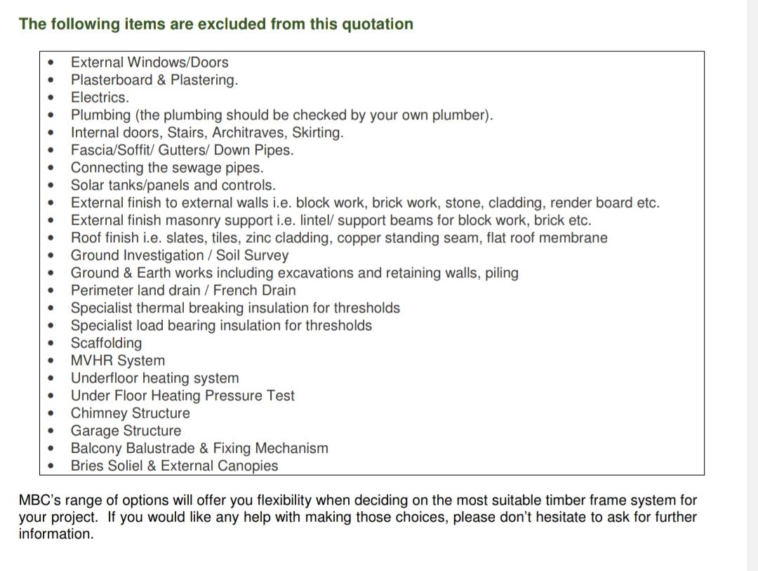

MBC were about £390/m2 in 2019 but that excludes quite lot. With the twinwall frame they have the best thought out system I know of however.

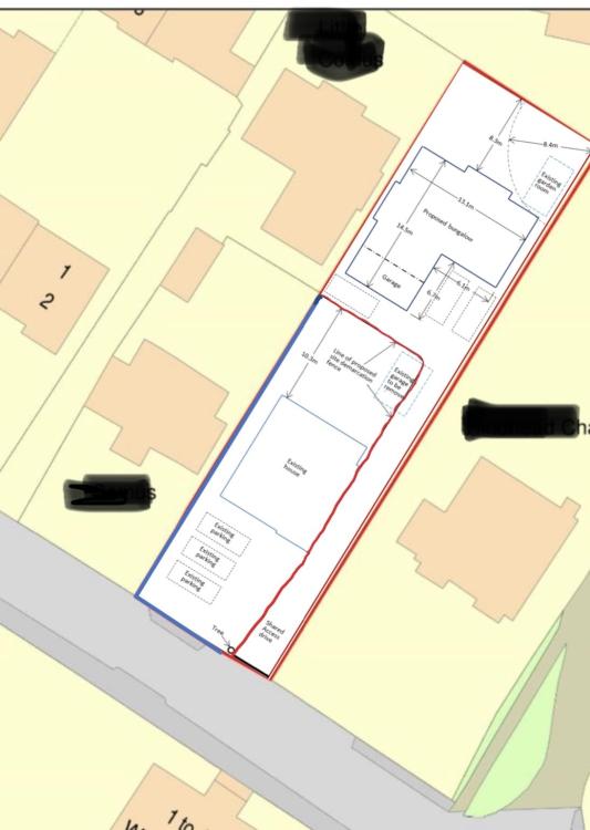

I’ve drawn some basics site plans which essentially just mirror the nextdoors property footprint onto our plot (as it’s an identical plot) and drafted a D&A statement just to put the feelers to planners before committing to money on an architect!

in terms of copying neighbours, I certainly don’t mean building the same as them (it’s a horrible retirement bungalow), but more the footprint. It’s actually just the most sensible shape and maximises the house size whilst keeping a sensible shape garden and avoid a root protection area. It also allows for a turning circle as cars need to be able to leave in a forward gear.
If anyone’s interested I’ll happy pm the site plan over for you to take a look at but would prefer to keep out of the public domain at this stage!
