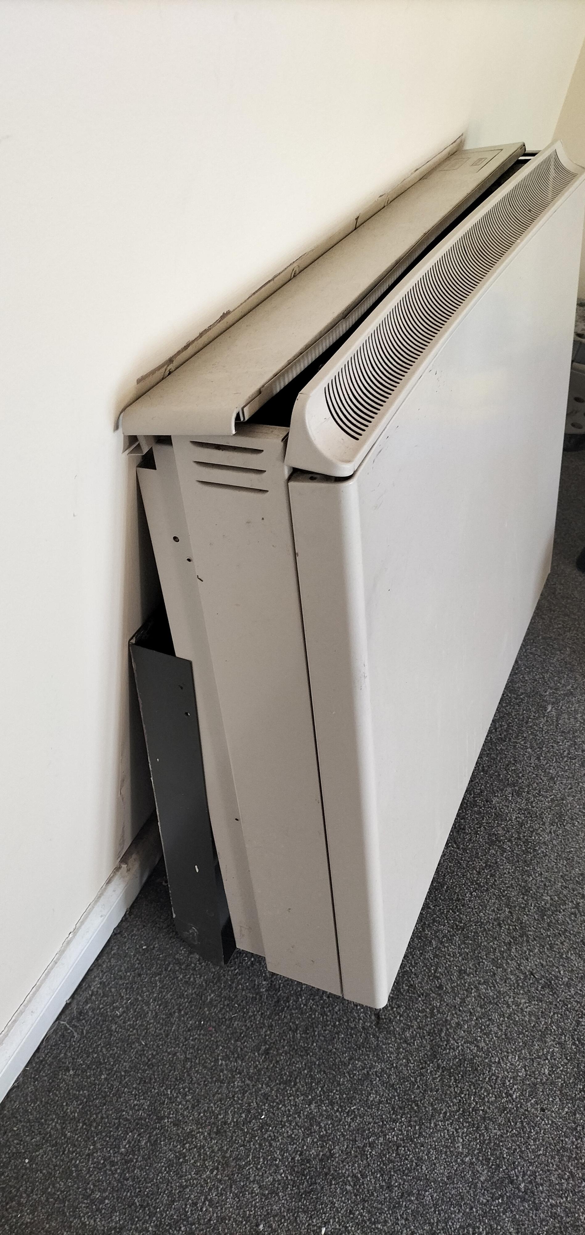

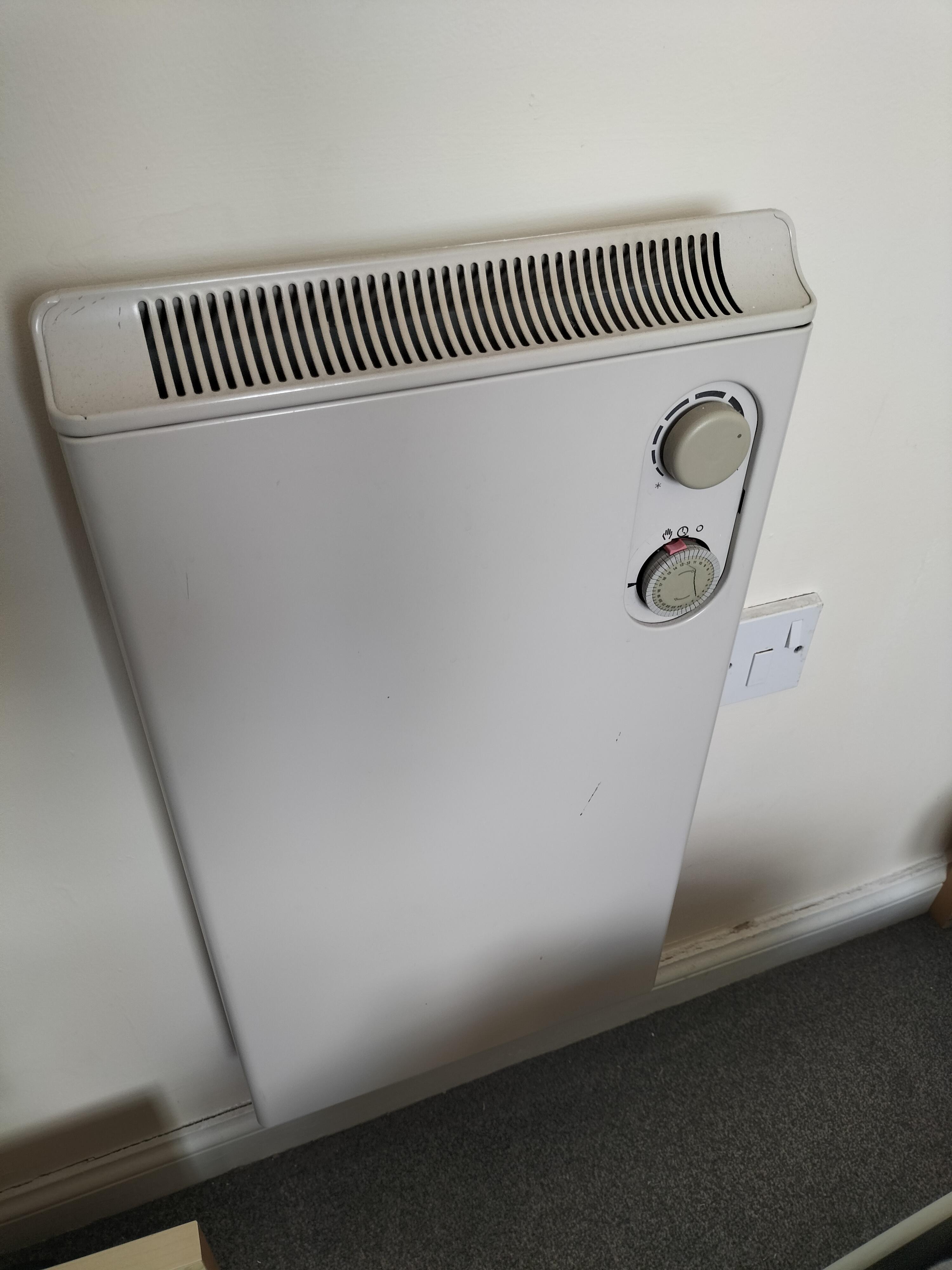

Could someone tell me what are these electric radiators worth?
Hi, I have a few electric radiators in my flat which I'm looking to replace with modern, more energy efficient ones. These might not be too bad on energy consumption but there's better and they don't look too nice.
The bigger ones are very heavy, all of them are powerful and heat up quickly.
Does anyone have an idea of what type/ model they are and how much I might be able to sell them for? Thanks!

I think you have a mixture of Economy 7/10 storage heaters ( filled with heavy thermal bricks ) and lighter panel heaters ( heavy ones sit on the floor obvs ).
Search eBay / other to compare what these are selling for, but courier / transport costs will be a big issue for the storage heaters. Typically these go in the skip with me, due to the problem of getting someone to collect, even if offered up for free.

There might be reason to change them for something that looks nicer, BUT there are lots of BUT's
Anyone that tells you their electric heater is more efficient than another one is telling LIES.  They are all 100% eficcient, no more, no less, you put 1kW of electricity in, you get 1kW of heat out no more no less, the posh snake oil ones will be just the same.
The other but, is yours have old fashioned nice simple controls, if they break they can be fixed, they are easy to understand and easy for you to set them to operate how you want.  Modern replacements will have electronic controls thanks to an EU directive that we still seem to be abiding by even though we don't have to, so even if they are storage heaters, they will decide when to charge, whether to use peak or off peak electricity, not you.  And that is more to go wrong, harder and more expensive to fix.
Your choice, but please don't be scammed into buying something you have been assured will be "more efifcient"

Night storage heaters have zero value.
However for gardeners with a greenhouse, my tip of the week is this.
Salvage the thermal bricks and use them as plant supports. They absorb heat during thd day and release it in the evening, keeping the plants warmer.
