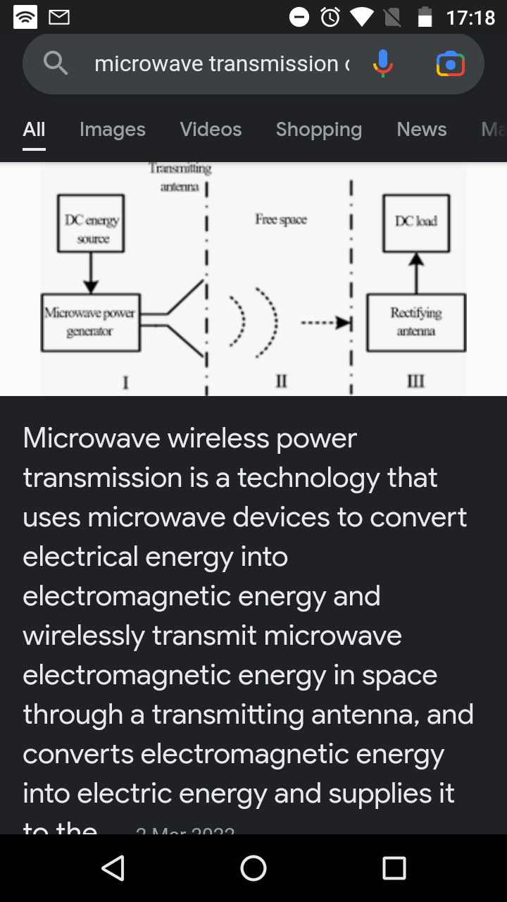

Radian Posted April 11, 2023 Posted April 11, 2023 10 minutes ago, Onoff said: Too easily dissipated by intervening structures e.g. people! The wireless power transfer I built (in the video above) uses purely magnetic coupling at around 1mHz so goes right through most stuff that's likely to get in the way. 1
Onoff Posted April 11, 2023 Posted April 11, 2023 1 hour ago, Radian said: Too easily dissipated by intervening structures e.g. people! The wireless power transfer I built (in the video above) uses purely magnetic coupling at around 1mHz so goes right through most stuff that's likely to get in the way. So yours is two Induction loops?

Radian Posted April 12, 2023 Posted April 12, 2023 20 hours ago, Onoff said: So yours is two Induction loops? Yes, the self-oscillating power driver is incredibly simple (a couple mosfets, capacitors and inductors) and the same circuit can synchronously rectify at the receiving end. In fact, it's totally bi-directional - you can put DC in at either end and get it out at the other! Great for wirelessly charging drones which could also drop-off power at another station. If you notice there's another passive loop sitting on the floor 0.9m below with a blue LED. That's also receiving power. The CD case loop uses copper foil but that's a bit more lossy than the copper tube. The optimum coupling distance is in the order of the size of the transmitting loop so a wall-sized loop could light a floor lamp from a few m away. 18 hours ago, SteamyTea said: Milli Hertz ? My bad. Megahertz.
