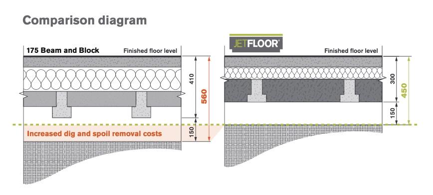

There are various beam & block systems which use polystyrene blocks instead of concrete blocks inbetween the beams. Then there's another layer of polystyrene and then a "structural topping".
Systems include Jetfloor or Warmfloor Pro.
Essentially they reduce the overall floor buildup thickness by moving some of the insulation layer thickness between the beams, as well as potentially using the "structural topping" to reduce the beam size necessary. If I have understood correctly.
This diagram is from Jetfloor literature:
Where they argue the Jetfloor system is more cost effective than a conventional B&B buildup. They compare a Jetfloor system with 150mm beams vs conventional using 175mm beams. They both achieve the same U-value.
It implies that you might save 100mm of ground excavation. However, if you only need 150mm beams in the first place, that's down to 75mm.
I'm wondering if anyone has any experience where using an insulated-block type system really did save any costs. Especially on small jobs, because usually it's best to stick with something that most builders are familiar with.

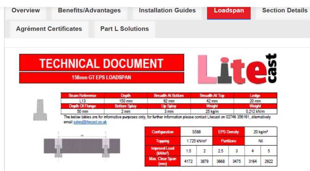

I wondered if it was possible to make your own insulated "blocks" from thick sheet insulation.
check out litecast. Thats what I will be using. I'm not sure if they deliver to where you are.
I'm assuming you are using their "Litecast GT" or "Litecast XT" systems?
For you, what swung the decision to use something like this, rather than conventional beam & block?

yes the GT12. Those concrete blocks are heavy and then you need to add lots of insulation before screeding. I’ve used them on a few sites now and they are a doddle. Oh and you can get your UFH and floor screed in early and carry on with the build.

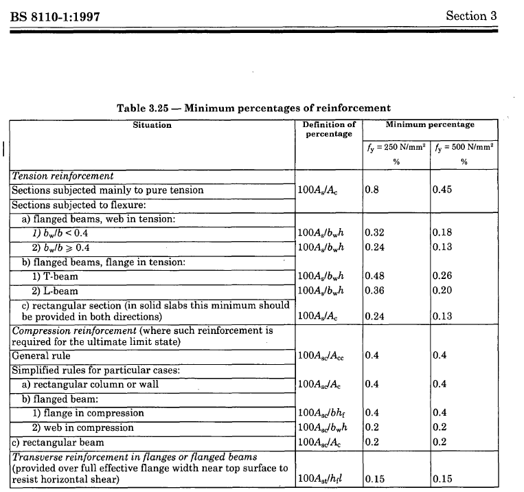

Thanks, my engineers spec is a 150mm reinforced slab with a single layer of a393 to the base. No spans greater than 4m for the slab so I would need to add another footing to help there. We may need to add some reinforcement to the top of the slab above these footings for ‘hogging’.  I imagine I would need to add an extra footing for b&b to break up larger spans.
I originally planned on a ground baring slab to be used as our ff with underfloor heating within. With the added complexity of reinforcing the slab and potential hogging, does using the slab as a ff seem un realistic with the amount of crack potential. We have several dividing walls we can use crack control joints at but in the larger kitchen/diner it would be a shame to use control joints. My aim was to reduce the need for a screed buy polishing the slab (another discussion has already been had on this)
Sounds like the options are:
Reinforced slab with void formers (potential crack issues).
Block and beam with screed.
Timber suspended floor.
Beam and block comfortably spans 4m.
Polishing the slab is ok, but a bit specialist for domestic. I prefer concrete screed, pir, screed with ufh. Control.
Or b and b, then pir and screed.
150 slab with 1 bottom layer of mesh is a surprise as a suspended slab. That will require great precision.
