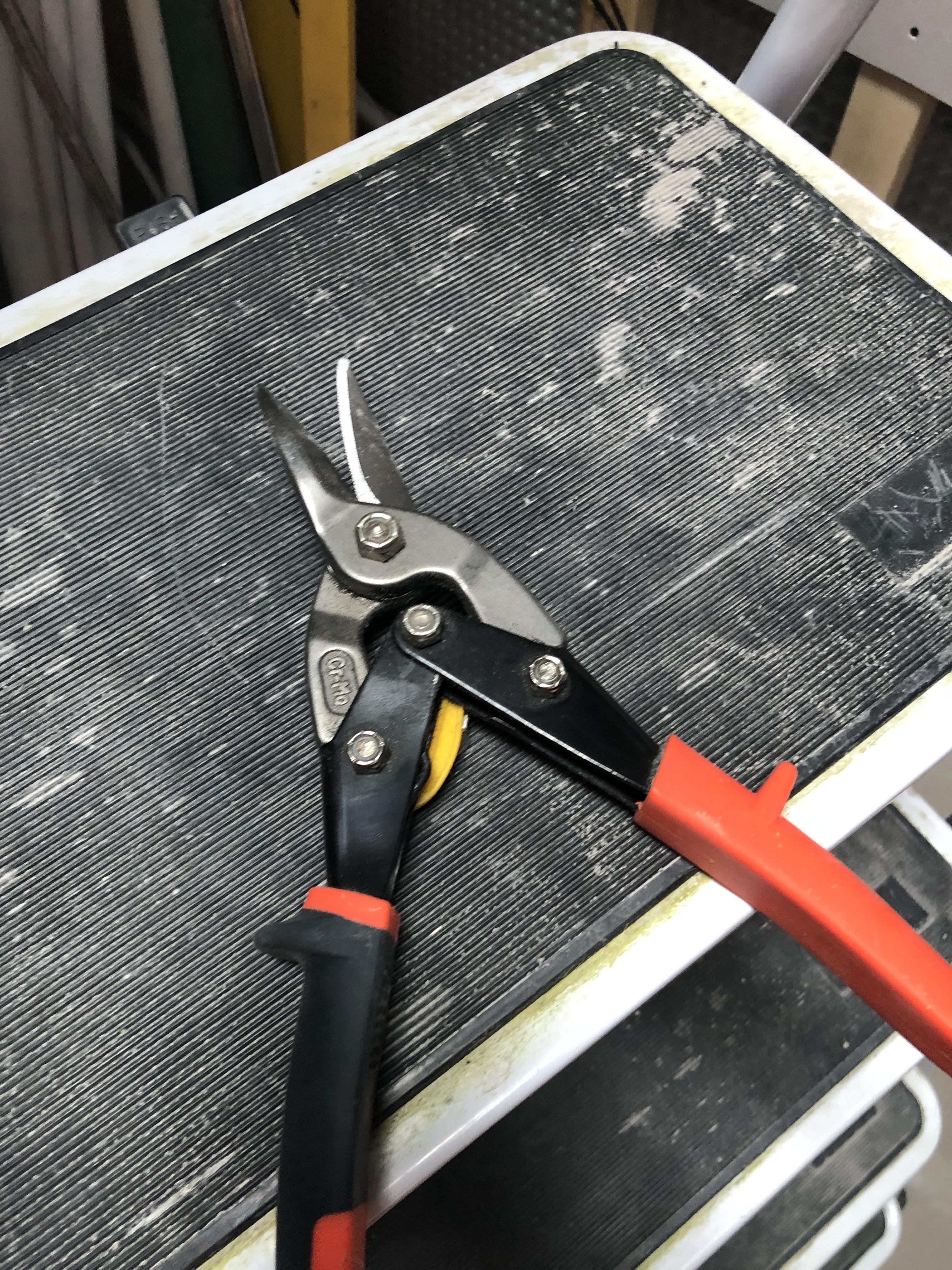

Pocster Posted April 5, 2023 Share Posted April 5, 2023 Trying to cut this think steel trim . Have these snips ( assume they are right for the job . But they bend / warp the steel and don’t seem to cut neat . Better instrument for the task ? ( avoiding using the word tool ! ) Link to comment Share on other sites More sharing options...

saveasteading Posted April 5, 2023 Share Posted April 5, 2023 19 minutes ago, Conor said: fine 1mm INOX blade in a small grinder, low rpm While clamping the metal very tightly. A pro metal worker (or tiler for trims) uses RH, LH and straight snips. It is still a skill with the right kit. 1 Link to comment Share on other sites More sharing options...

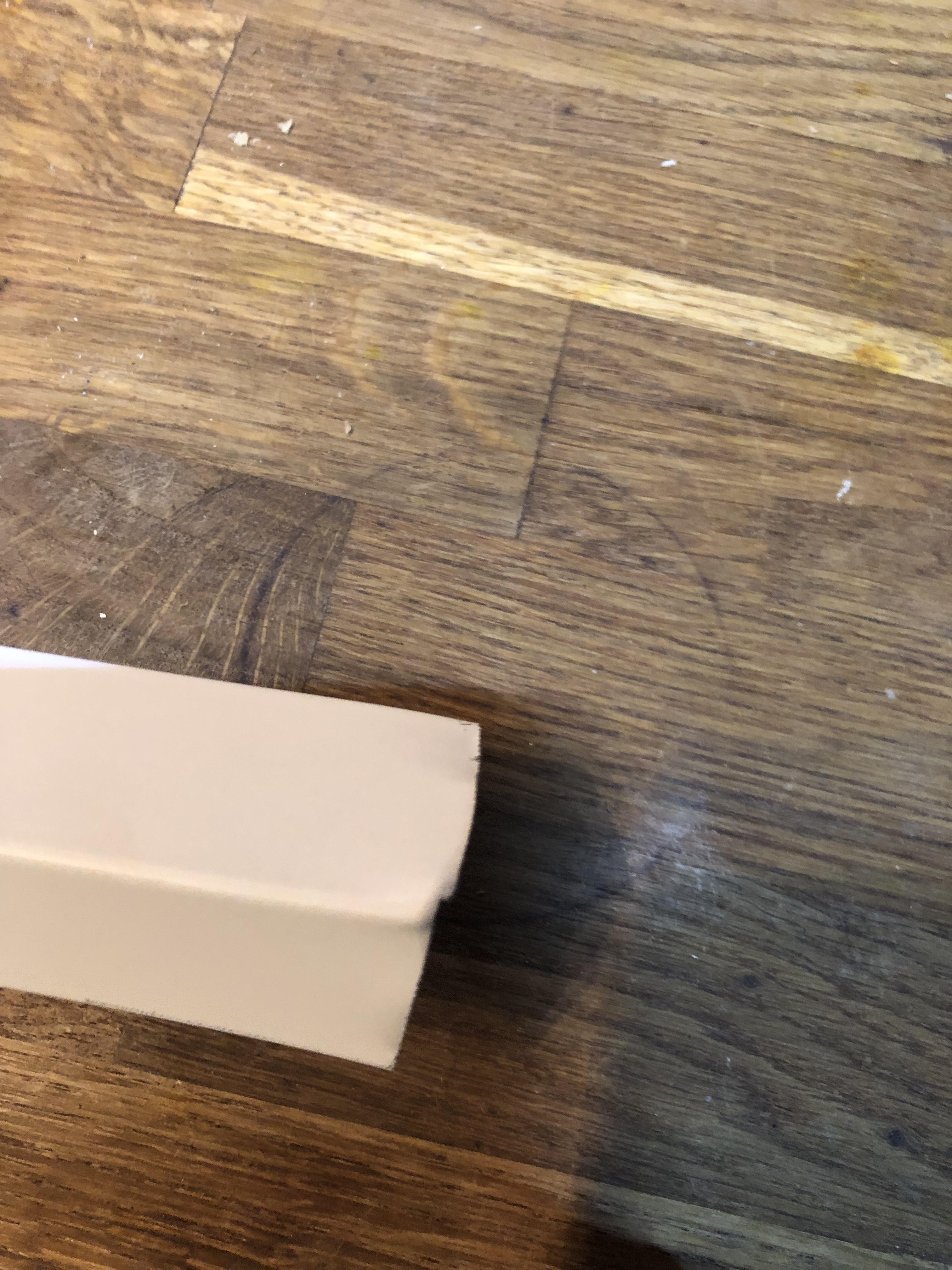

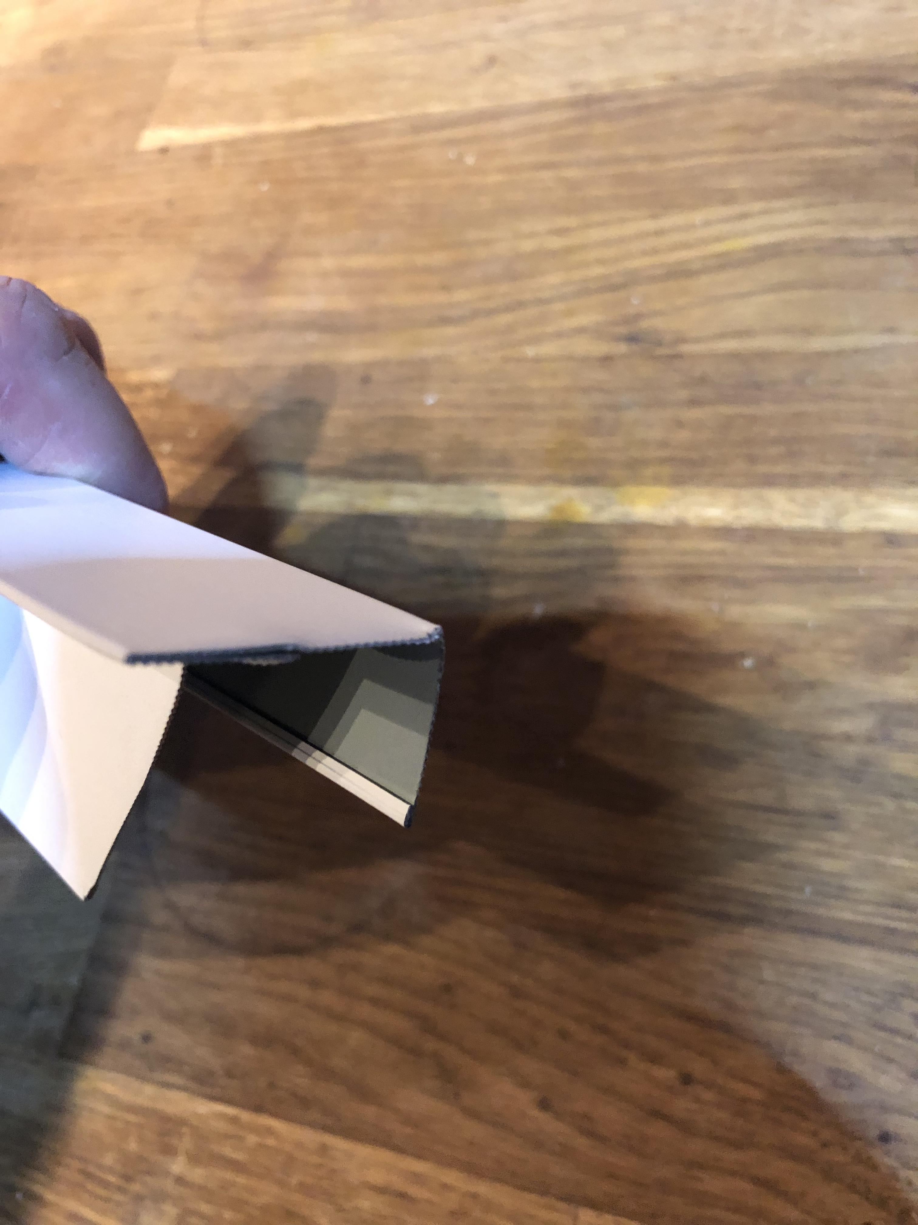

Pocster Posted April 5, 2023 Author Share Posted April 5, 2023 2 hours ago, Miek said: Better to cut that cold if its coated in paint zinc or plastic . Make a piece of wood that fits inside as a support and cut with a TCT chop saw or table saw. Hacksaw if its sharp but again a support block really helps. Metal but plastic coated . Tried to cut with angle grinder - no good just burrs Link to comment Share on other sites More sharing options...

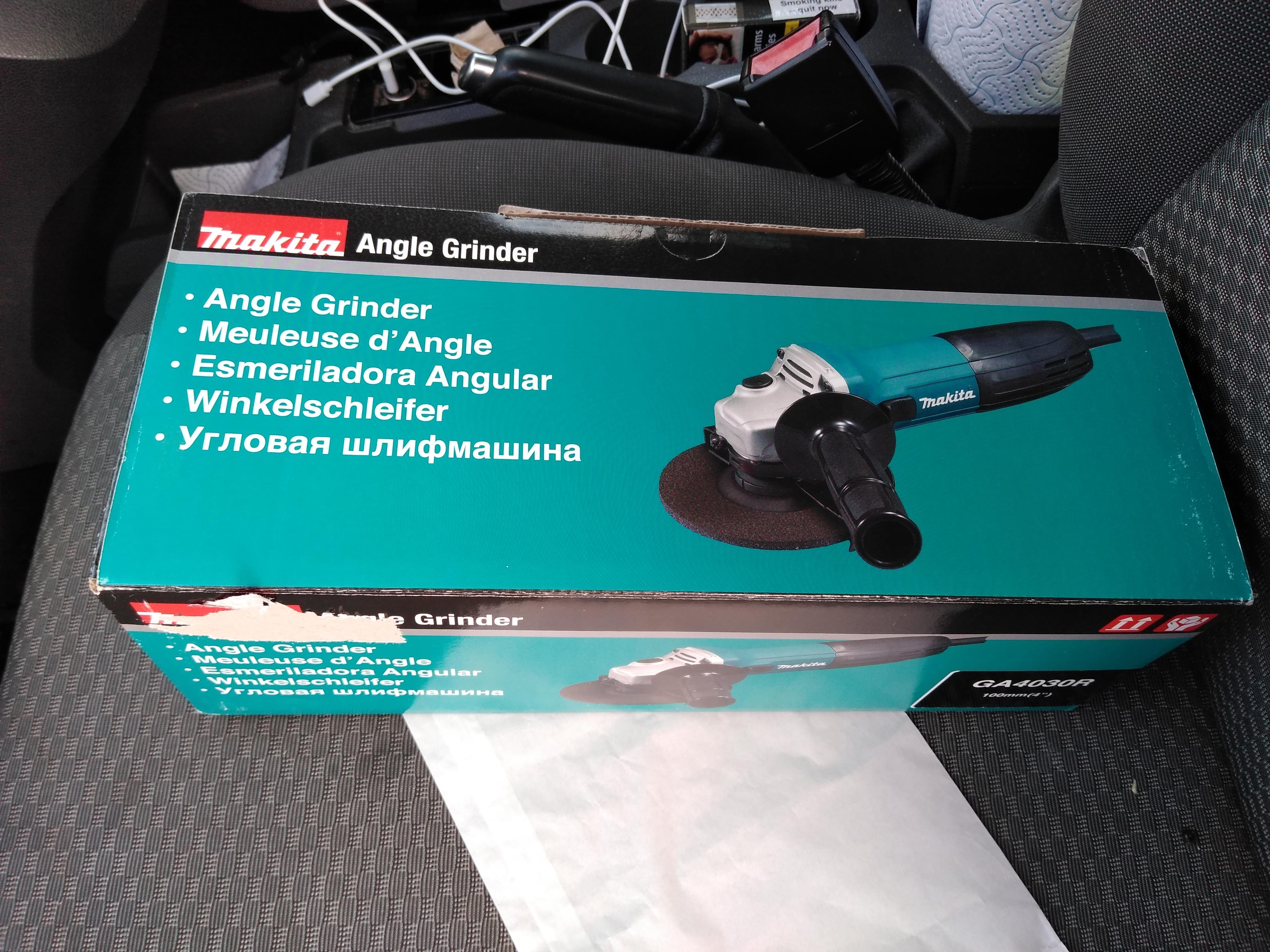

SteamyTea Posted April 6, 2023 Share Posted April 6, 2023 34 minutes ago, Conor said: It's quite astonishing how good a 5" cordless grinder is Here is my new one, not cordless mind you. Unlike my larger ones, I can keep it switch on permanently. Much safer to use. Link to comment Share on other sites More sharing options...
