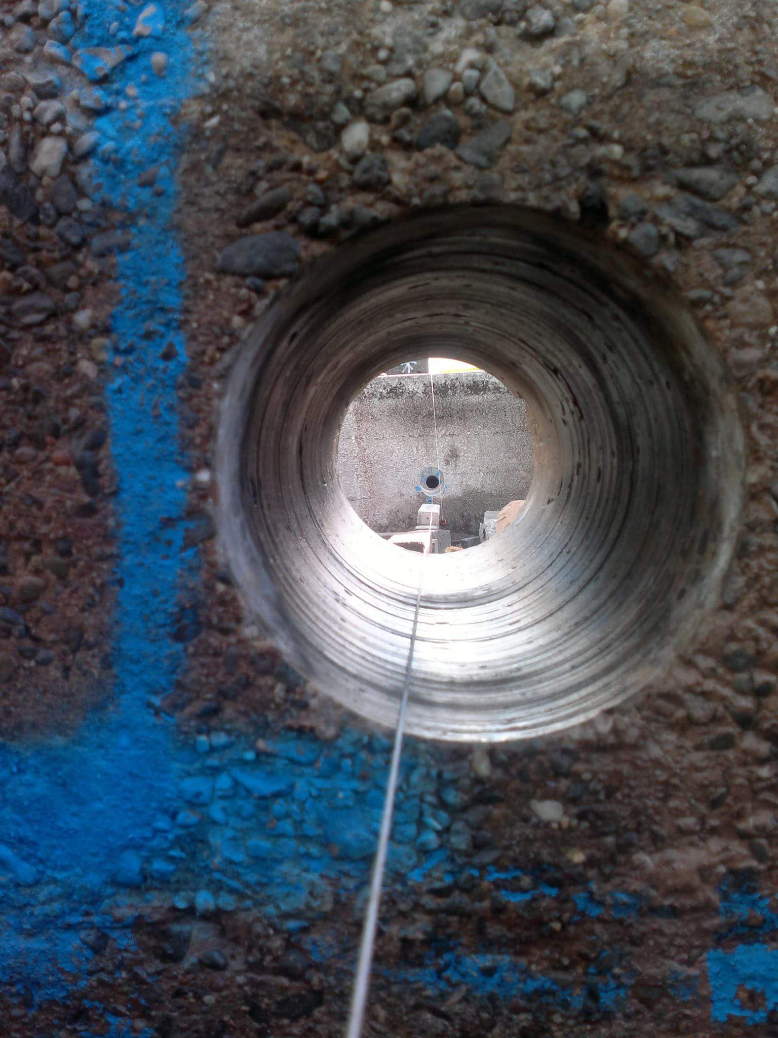

jamiehamy Posted August 2, 2017 Share Posted August 2, 2017 Hire a core cutter and you'll have it done in a day. If you can do it from the outside the have an assistant pour water on it to make it much more pleasant. If no rebar then around 15-30mins each? I'll dig out some pics for you - we had to do 5 through heavily reinforced concrete, one wall being 500mm thick... Goggles and ear defenders an absolute must. 1 Link to comment Share on other sites More sharing options...
jamiehamy Posted August 2, 2017 Share Posted August 2, 2017 Ah yes - something I hope never to have to do again! 60year old concrete with copious amounts of rebar! 2 Link to comment Share on other sites More sharing options...
