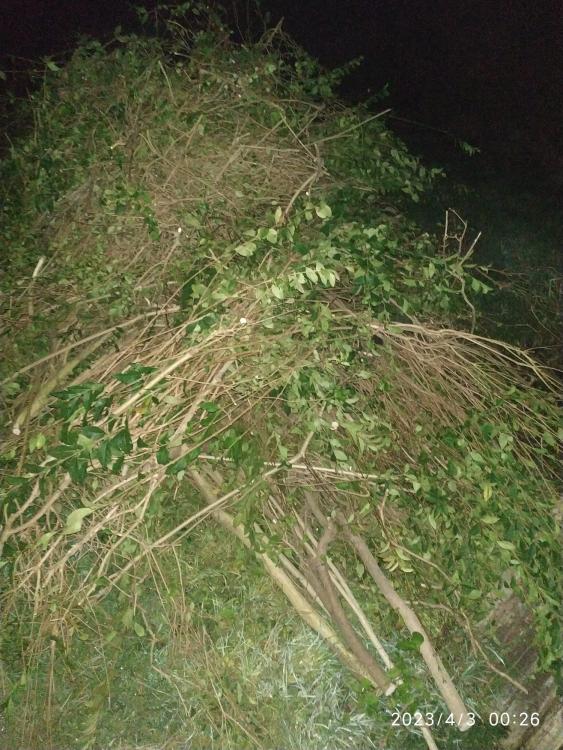

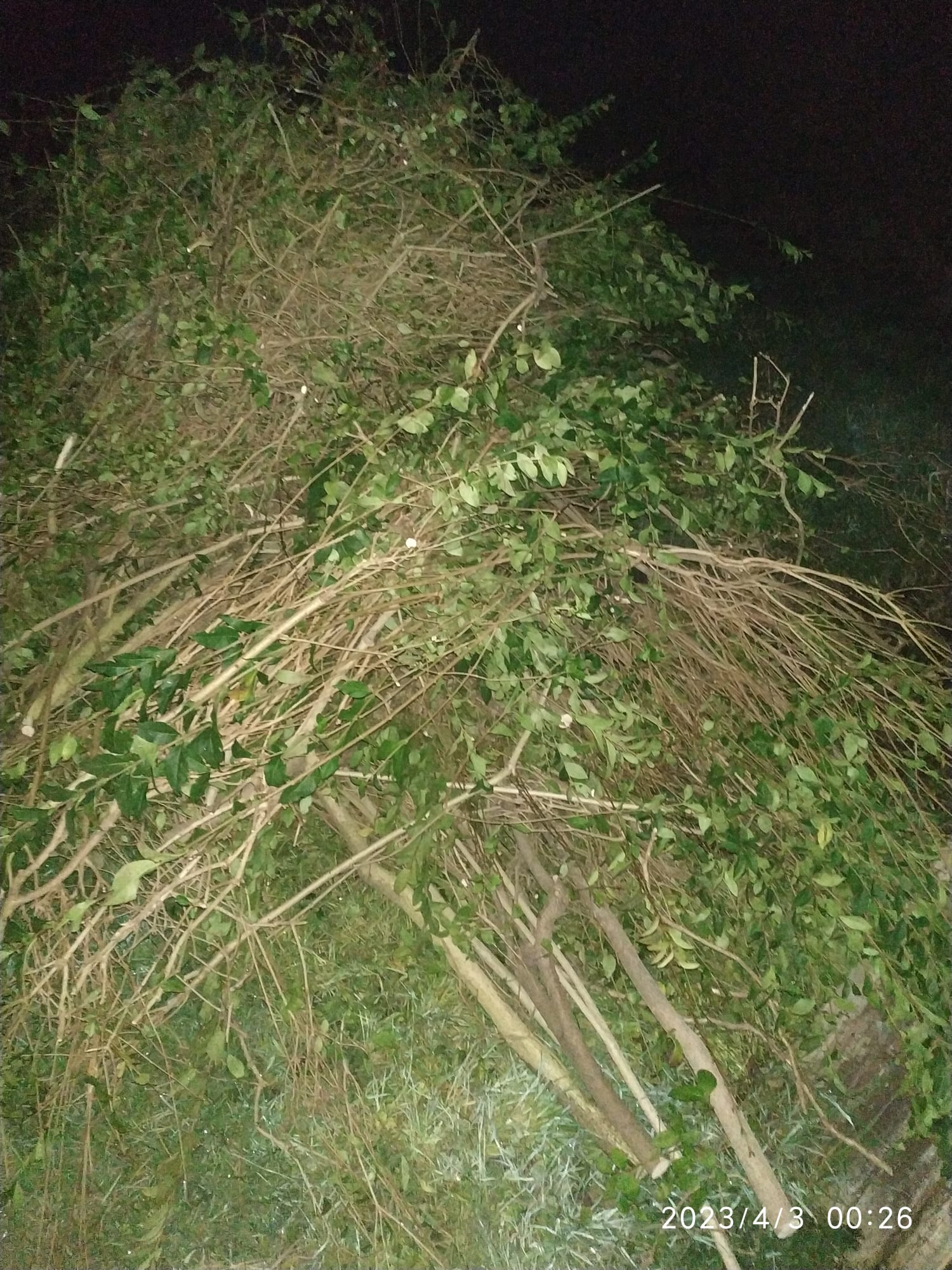

JohnBishop Posted April 3, 2023 Share Posted April 3, 2023 Hi All, I have some of it to shred. I am going to compost it and leave the bigger bits for my fire stove. Someone has put a video of a quiet shredder that was going through that kind of stuff pretty easily but I cannot find that video. Best Link to comment Share on other sites More sharing options...

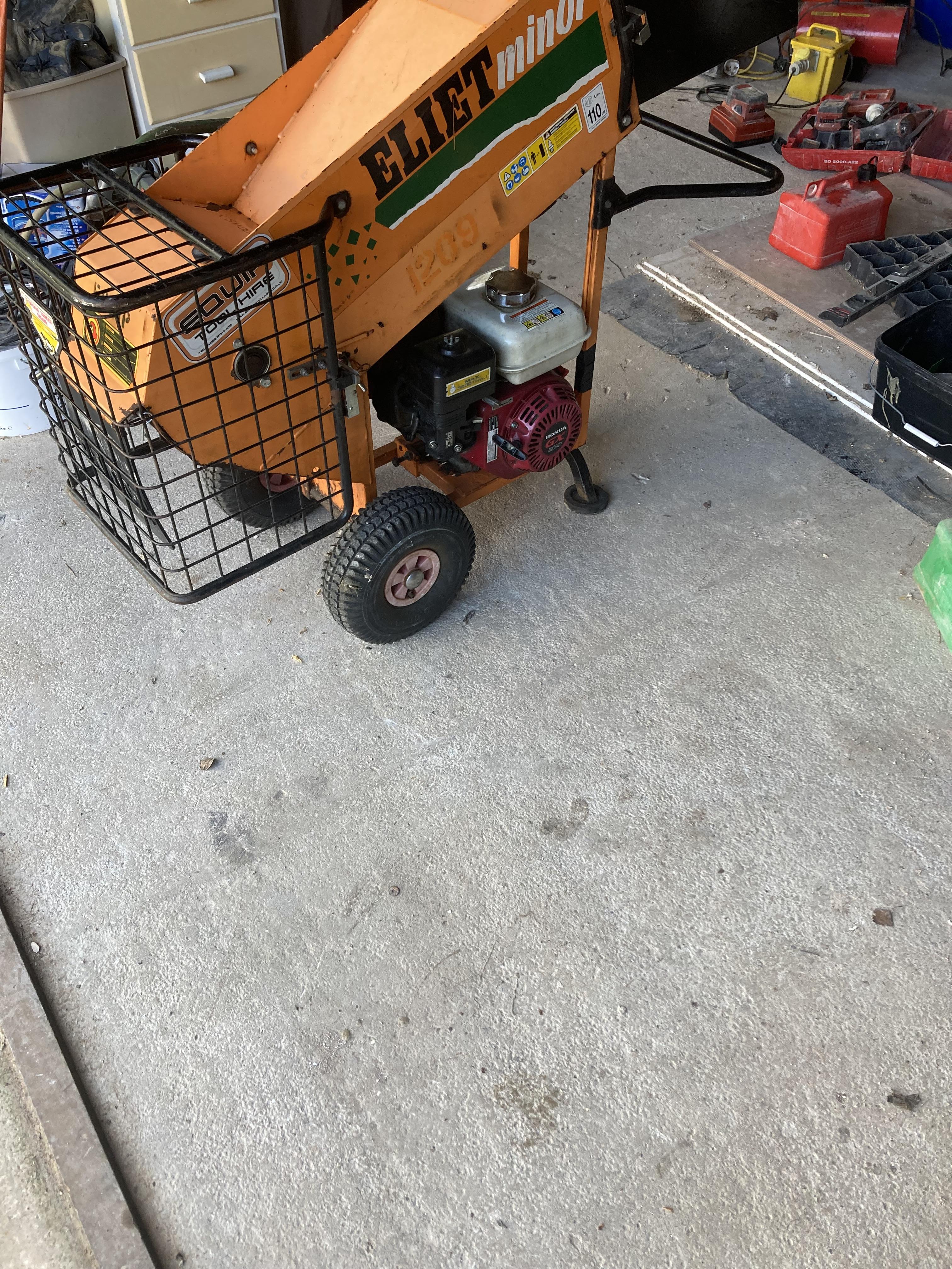

nod Posted April 3, 2023 Share Posted April 3, 2023 I’d hire one my wife’s just bought this x hire shredder The smaller ones soon block 1 Link to comment Share on other sites More sharing options...
Russell griffiths Posted April 3, 2023 Share Posted April 3, 2023 Anything electric will be awful. Petrol one like nod picture is about as small as you want to go. 1 Link to comment Share on other sites More sharing options...
saveasteading Posted April 3, 2023 Share Posted April 3, 2023 I've got an electric Bosch worm drive one that handles the mid sized sticks you are describing, and usefully drags the rest of a branch through behind it. No good on wet stuff. I converted a pile of shrub of about 3m3 (mostly air obv) into firewood and bean poles plus about 0.5m3 of mulch and 1 brown bin of messy ends. Slow though with one stick at a time. Allow 2 hours for your pile. I have had it at least 10 years, and it still seems to be top in Gardeners World report. Also have a borrowed one that is a spinning blade. Only good for big sticks and very noisy. Havent used it and giving it back. Link to comment Share on other sites More sharing options...

JohnBishop Posted April 3, 2023 Author Share Posted April 3, 2023 (edited) 5 hours ago, nod said: I’d hire one my wife’s just bought this x hire shredder The smaller ones soon block this creates a dilemma for me because I would rather do it in stages than hire and do a whole lot, I mean a lot more but I would have to trim the hedge on the boundary first which would create 20+ piles like that. On the other hand you are right the electric is slower and keeps blocking. I should go after the hedge and then shred it. In the meantime pile all the stuff in the right location so I don't have to keep moving stuff around. I don't know how safe is the process of unblocking an electric one but I reckon if I have to do it like 100 times then the risk of losing a hand increases. Edited April 3, 2023 by JohnBishop Link to comment Share on other sites More sharing options...

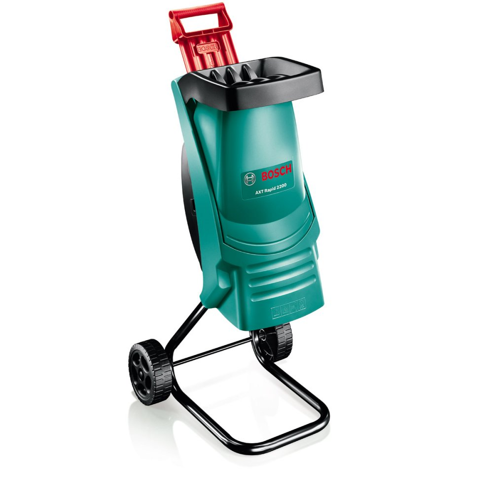

saveasteading Posted April 3, 2023 Share Posted April 3, 2023 1 hour ago, JohnBishop said: model of this Bosch I will look in the shed to see if it still has any markings. Looks similar to this. I suspect the innards have not changed 1 Link to comment Share on other sites More sharing options...

saveasteading Posted April 3, 2023 Share Posted April 3, 2023 AXT 2000-HP. It won't take sticks more than about 30mm, but those get lopped into kindling so it suits me. The big thing it does is, being a worm drive, it drags the stick through...you can walk away, and it takes the twig and leaf stuff with it. It just gets dragged in. That saves ages. With too much wet stuff it can stall, so I keep some dry sticks aside which will always engage and take the bits with it. 1 Link to comment Share on other sites More sharing options...
