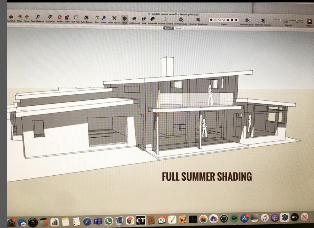

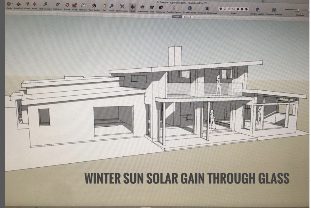

Iceverge Posted April 2, 2023 Posted April 2, 2023 (edited) What direction is it facing? North, no problem. Anything else will get too hot. Solar glass is a bit of a half solution. It can compromise the view and then not work perfectly well either. Overhangs work well for South facing windows but not so much for East West. External blinds work well but block the view. If it is outside the thermal envelope you can simply shut the heat/cold out from the main house like @joe90 did on his house. My personal opinion is that very large glazed areas only work when you have a very large heating and cooling budget or a very scientifically skilled design. Edited April 2, 2023 by Iceverge 1

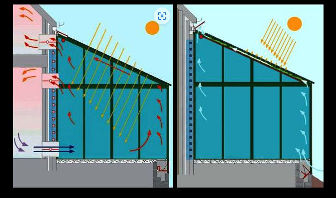

SteamyTea Posted April 3, 2023 Posted April 3, 2023 13 minutes ago, Gill said: Last month we probably had at least 7 days where the temperature in there was over 20. Doesn't take much sun for the temperature to climb quickly. It will get any sun unobstructed morning through to early evening. Pretty good really. Makes me wonder why we don't fit a glass panel over 'daylight' walls and pump the thermal energy around the house. A posh trombe wall, but not using the wall as storage so much. 1
