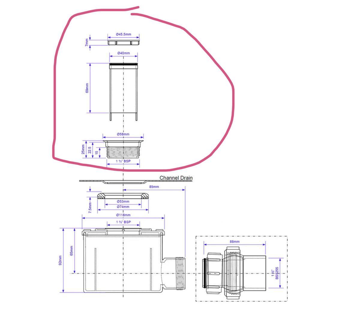

Adsibob Posted April 18, 2023 Author Share Posted April 18, 2023 21 minutes ago, markocosic said: Share a link / photo. The traps on these slot drains are usually removable from the top. This sort? https://www.youtube.com/watch?v=XL4XEZcmXWI It's usually a right pain to slide that grey part out and even more of a pain to slide it back in again. (tends to want to "pop out" again unless you get everything spotless) Ours has a strategically placed bottle cap wedged between the grey part and the wall of the drain to hold it into the pipe. If there's a second trap / alternative trap that's only accessible by cutting into the ceiling from underneath then that's a bit of an f-you move by the plumber. Cut in an access hatch as you'll be needing to de-wife / de-daughter that trap regularly. (short hair, pubes, soap etc sail though; it's long hair that twirls around itself then gets all kinds of non-rinsable conditioners and whatnot attached to it that really block these) I'm not at home now, but this is the product we installed. If you scroll across the diagrams at the bottom, you'll see this: So it seems that it should be possible to access some of the bits by unscrewing the top parts. Not sure how i'll get much purchase on it, the pieces are small and fiddly for my fat fingers. Link to comment Share on other sites More sharing options...

Marvin Posted April 18, 2023 Share Posted April 18, 2023 the first two parts in your diagram just pull upward Link to comment Share on other sites More sharing options...

Adsibob Posted May 26, 2023 Author Share Posted May 26, 2023 (edited) Finally got around to unblocking this, having received the bendy plastic fishing tool with jagged edges from Mr Bezos a few weeks ago. Without doubt the most revolting maintenance job I’ve done so far. Fished out handfuls and handfuls of SWMBO’s hair out of the drain. It was actually quite a sophisticated drainage system. What I thought was going to be a long 40mm pipe, was actually only about 9cm long before it hit what was effectively a bowl. All the hair was stuck in this tube. The tube could be pulled out altogether (wish I’d discovered this at the beginning of the task, rather than at the end). So I think the way it works is water fills the bowl, and only once the bowl is overflowing does it drain to the actual waste pipe. The advantage of this system is that any blockage should mostly stay very local. Though it did make me wonder whether there is a permanent cesspit of stagnant water (fermenting SWMBO’s shed hair) within that bowl. Edited May 26, 2023 by Adsibob Link to comment Share on other sites More sharing options...
dpmiller Posted May 26, 2023 Share Posted May 26, 2023 you understand how a water trap works, yes? Link to comment Share on other sites More sharing options...
Adsibob Posted May 26, 2023 Author Share Posted May 26, 2023 (edited) 24 minutes ago, dpmiller said: you understand how a water trap works, yes? I know how a typical sink and toilet trap work. But this appears different, though I guess it’s the same principle. And looking back at the drawing of the waste system which I posted earlier in the thread, it all makes sense now. Edited May 26, 2023 by Adsibob Link to comment Share on other sites More sharing options...
Adsibob Posted May 27, 2023 Author Share Posted May 27, 2023 I sometimes wonder if my DIY efforts are cursed. First shower after I successfully unblocked the drain: SWMBO sticks her head around the bathroom door and says “turn it off, it’s leaking into the utility room”. I thought I had been gentle with my fishing, and looking back at the diagram posted above, I cannot see what damage I couldd have done. But unless this is a massive coincidence, the laws of temporal logic suggest my unblocking has indeed caused the leak. Link to comment Share on other sites More sharing options...

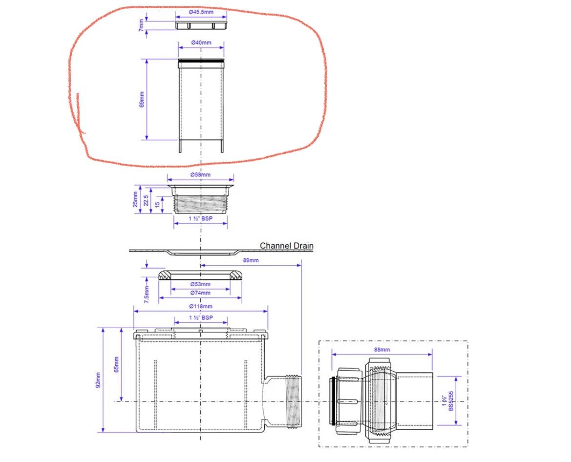

Nickfromwales Posted May 27, 2023 Share Posted May 27, 2023 OK. Did you unscrew the top threaded part out of the waste fitting that resides under the tray? You should have been unscrewing.......................nothing. Link to comment Share on other sites More sharing options...
Adsibob Posted May 27, 2023 Author Share Posted May 27, 2023 16 minutes ago, Nickfromwales said: OK. Did you unscrew the top threaded part out of the waste fitting that resides under the tray? You should have been unscrewing.......................nothing. Nope. Only thing I did was prise off the top item of the two circled below, fish around for 15min, remove hair, then realised I could pull out the second item circled below, so pulled that out too (it came out really easily with no resistance, which made refocusing hair much easier. Then I returned everything, to how I thought it was. But apparently not. Any ideas? Link to comment Share on other sites More sharing options...

Adsibob Posted May 28, 2023 Author Share Posted May 28, 2023 1 hour ago, dpmiller said: were you rodding hard enough to push a joint apart? No, i don’t think so. Also, the implement I was using was very thin and bendy, so it’s just bizarre that it would have the rigidity to do any damage. I can only conclude that the installation of the shower waste was pathetically bad, such that 15 minutes of fishing for hair had damaged it. Completely ridiculous that I deliberately avoided using the acid products, because I didn’t want to damage the pipe work, and yet I’ve ended up in this position. Link to comment Share on other sites More sharing options...
Nickfromwales Posted May 28, 2023 Share Posted May 28, 2023 It’s not a soft option. Sounds like you have pushed the compression fitting enough to have moved the seal. Time to start cutting the ceiling I’m afraid. Don’t try cutting a small section out, it’s pointless. You’ll need to remove prob 600mm square to be able to physically get in and carry out a repair. Preserve the bit of board you take out, and reinstate it. Box clever and cut down the centre of the timbers and find the plasterboard screws with a small string magnet. Utilising the section you cut out will mean very little filling and sanding etc. Or, buy a hatch and cut to that dimension? Link to comment Share on other sites More sharing options...
