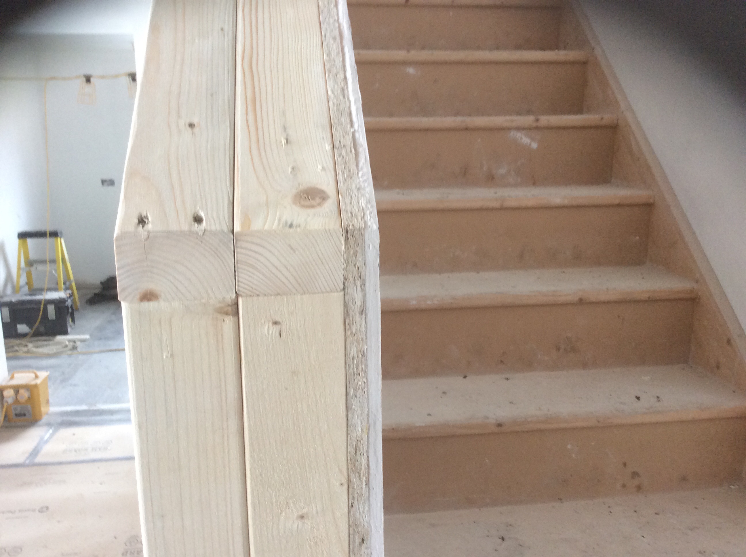

markocosic Posted March 20, 2023 Posted March 20, 2023 Glue a piece of wood to the face of the plasterboard with some goo: Glue and a screw. https://www.soudal.co.uk/diy/products/fix-all/fix-all/fix-all-turbo That will carry all shear loads AND any torsional loadings on the fastener that "wiggle it in the hole" and make it loose over time. Then clamp the wood to the plasterboard using your choice of "drill a bighole and wedge a thingamy behind it then screw into the thingamy. This will prevent the wood from peeling away from the plasterboard. (a pure tension fixing) You'll only need one at the top generally. That's how you hang huffing great 1600 x 700 T22 rads on plasterboard without them falling off when they're supplied with two brackets only. 🙂 Not my boarding but shows the idea: If you need to use one of those "wedge a thingy behind shove a screw in it fixings you can do worse than gobbing some carberfix style PU bubble glue on the fixing before fitting it. That'll then stick to the back of the plasterboard and you can remove / replace the screw later. 🙂
