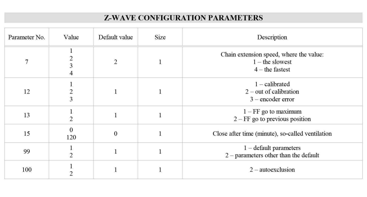

Nick1c Posted March 17, 2023 Posted March 17, 2023 We went for Fakro as their 3G unvented units were cheaper than the equivalent Velux, 2 are motorised to allow for cross-ventilation. The motor in them is slooow relative to the Velux ones we had in a previous house, but the rain sensors work well. One of the motors stopped working a year after we moved in, but slightly over the 2 year warranty period since they were bought. It had been used less than 20 times in that period. Fakro’s technicians were great over the phone trying to find the fault, but once it was determined to be FUBAR they came back with a quote for replacing the motor of £600 - £300 each for parts & labour!! I pushed quite hard to get this reduced, the only ‘concession’ I managed to get was that someone would talk me through fitting the motor myself as it is apparently a simple operation. On the basis of my experience with their product support I would not recommend them.

Blooda Posted March 17, 2023 Posted March 17, 2023 (edited) 5 hours ago, Nick1c said: The motor in them is slooow relative to the Velux ones we had in a previous house, but the rain sensors work well. @Nick1c We have the Fakro ones as well, and the motor is slow, however the manual for the motor does suggest there is a programmable parameter to change the speed. NC 814-GB_ZWS12_19.08.06_FAKRO mobile (gofakro.com) manuals-backend.z-wave.info/make.php?lang=en&sku=ZWS12 RU&cert=ZC10-18036065 Tried to sort this out when we installed, but never really got on with sorting out programming the controllers, only adding the blinds, as we had other jobs to do like... finishing a house !! Maybe I will take another look. Stuff I don't understand from another forum Indigo Domotics • View topic - Fakro Roof Windows - Zwave Function Edited March 17, 2023 by Blooda
jack Posted March 17, 2023 Posted March 17, 2023 39 minutes ago, Blooda said: Tried to sort this out when we installed, but never really got on with sorting out programming the controllers, only adding the blinds, as we had other jobs to do like... finishing a house !! Interesting. We installed a Fakro roof light with electric opener during construction in 2015. It worked with the supplied remote control when first installed, but as soon as we tried to get the hardwired Z-wave module to work with it (and our home automation system), everything including the remote control stopped working. We put it to the side and I've never actually gotten around to sorting it out. As a result, it's never been opened since we moved in!
