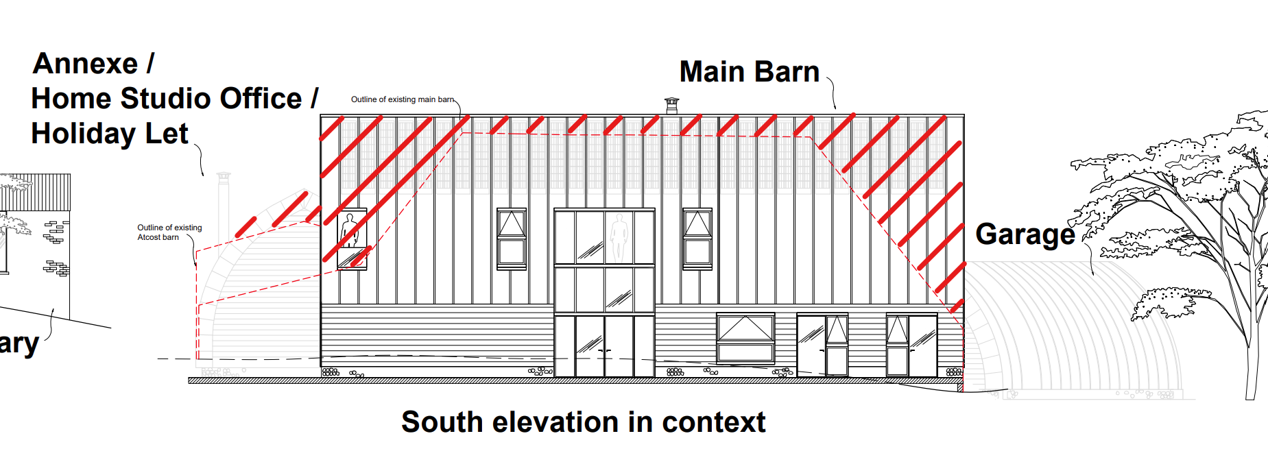

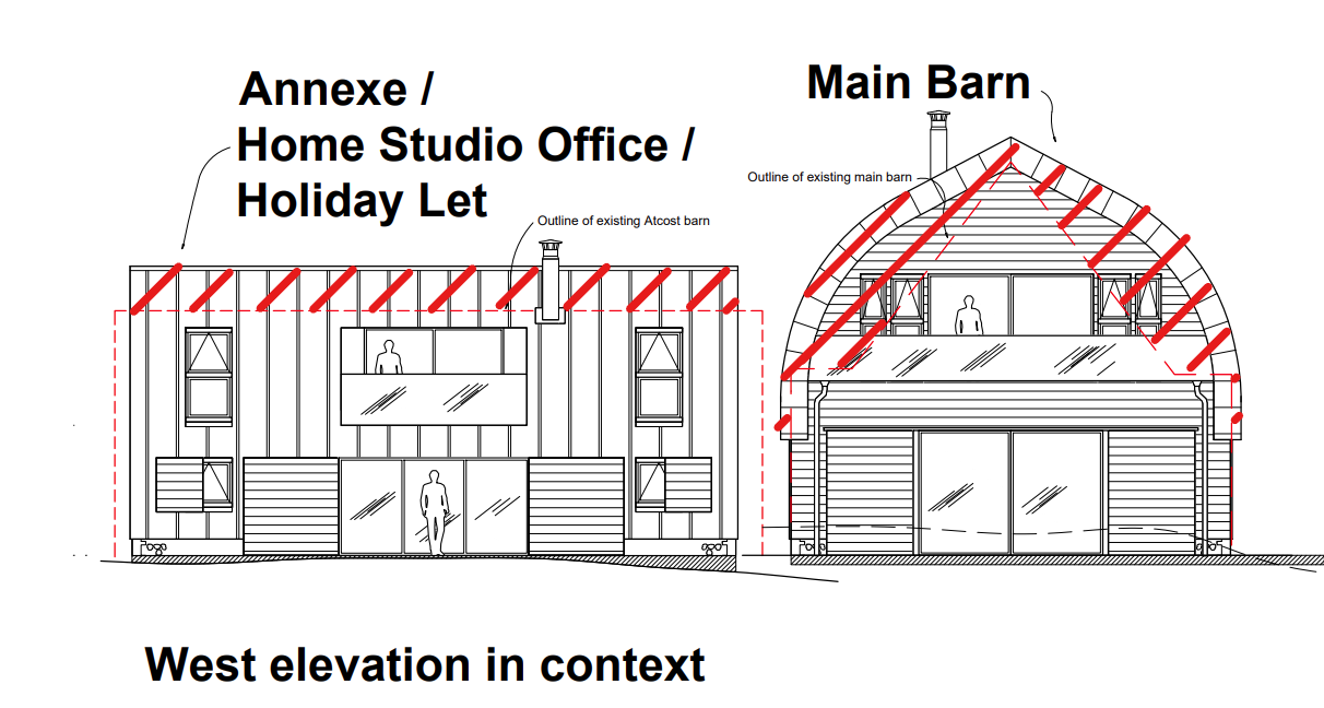

Drellingore Posted December 12, 2023 Author Posted December 12, 2023 I'll send a highlight email out to all the committee members. Here's a first draft: Hi, My name is Daniel Jones and I'm the applicant for planning proposal 22/01353. It's an eco self-build barn conversion in Drellingore, near Alkham, that's due to be discussed at this week's planning committee. I wanted to take the opportunity to present some highlights of the scheme ahead of the hearing. I can imagine that wading through all those reports must be quite time-consuming! High-end design eco self-build family home by Kent residents, converting a dis-used and dilapidated pair of barns Residential conversion and holiday let principle already established in 2018 Annexe for eco-tourism holiday let/accommodation for elderly grandparents Built using carbon-negative, super-insulating, fire-resistant, locally-sourced straw bales Generates more energy than it will use Biodiversity net gain triple that required even of larger sites - wildflower areas, replanted heritage orchard, wildlife ponds, bat and bird boxes, reptile shelters All public commenters support the scheme, including county councillor Martin Scherer, and the farmer who was born and lived on the site Described in public comments as "unexpectedly sensitive," "aesthetically pleasing," and "wonderful design [...] that will enhance its immediate area and the valley" Plans commit to retain the core, historic timber frame Historic fabric will be retained, salvaged and re-used wherever possible Previous building outlines will be preserved through design features We're pretty excited by the scheme, and have been waiting a full year for this hearing. If approved, we intend to reach out to the folks at Grand Designs to see if they'll cover it. I gather that having a great local pub is key factor in their decision-making, so it's lucky that we have the Marquis Of Granby up the road!
SimonD Posted December 12, 2023 Posted December 12, 2023 Can you provide that drawing in colour? That would would make more impact. At our committee meeting our architect hand sketched a colour drawing that went down a storm with the committee members.
Drellingore Posted December 12, 2023 Author Posted December 12, 2023 20 minutes ago, SimonD said: Can you provide that drawing in colour? That would would make more impact. At our committee meeting our architect hand sketched a colour drawing that went down a storm with the committee members. Sadly I've already sent that email out. We've only got one 3D render that was a bit cheap, and looks it. I did try using various AI doobreys to try taking the 3D render and make it appear more intentionally lo-fi, but the AI took too many artistic liberties I do agree with your point though!

Drellingore Posted December 15, 2023 Author Posted December 15, 2023 (edited) 28 minutes ago, joe90 said: Sorry to hear that, can you be more specific on what was rejected, what do you need to modify? The threshing barn is a non-designated heritage asset. We proposed changing the external appearance, basically wrapping the core timber frame (the 'goal posts' that are characteristic of threshing barns) in curved crucks so we can use straw bales in the walls and roof, kinda like the stone arch in a bridge. We pledged to retain those core, historic members of the timber frame, but we weren't specific enough on what exactly would be kept. If we had been more specific, they probably would have still rejected it. We didn't provide an engineer's report, for a few reasons. First, we actually forgot to submit the one we'd paid for! It was however quite vague, and not terribly optimistic. The second reason is that the prior structural survey from the previously-approved scheme was tediously detailed, and we kinda thought it might not be necessary to supersede it (it did however accuse the rafters and purlins of being worthy of retention, when they're all modern softwood). Finally, our preferred oak framer basically said "you can say that you'll retain this, that and the other, but until we actually get in there we just won't know." I know it sounds a bit daft not supplying it, but we did provide around 40 documents, and I triple-checked my document submissions. Only problem is that I didn't double-check that the checklist was correct 🙄 We'd need to modify the entire scheme, not changing the roof or shape, which in turn precludes the Huff Puff straw bale construction method. Hence the next application will be radically different. We've received pre-app advice on the next scheme, and it's not been great - the Ministry Of No were on full power that day. The danged AONB seemed insistent on getting us to put Kent Peg clay tiles on, despite the building not having had them for decades. Meanwhile, we're not allowed to reinstate the hipped wagon porch because it's been absent for decades 🤷♂️ TBH, it's all getting a bit awkward with the fact that if we ever get to build anything, the kids will soon be too old to live with us. We've not discussed what we want our lives to be once the kids move out. We've been putting off spending on holidays and stuff to save for the build, so the kids have been missing out for the sake of a building that they might never get to live in ☹️ Edited December 15, 2023 by Drellingore

IanR Posted December 15, 2023 Posted December 15, 2023 (edited) Sorry to hear the outcome, it's a long wait to hear a rejection and then feel you are starting again. I didn't want to post previously and bring negative comments about your scheme just as you were going to committee. I did feel however it is over-developed for the plot, and I know my LPA would have rejected it out of hand against their interpretation of the NPPF rules. My feeling was that you had overdone the massing and scale with your proposal, and not traded off anything else within the site to mitigate it. The extra width on front and side elevations, to achieve a full height second floor, does lead to a tangible increase in massing that I feel would be considered as harmful to the openness of the countryside by most LPAs. I've not watched the linked videos or read the Officer's report, so perhaps they've not rejected it on that basis, but it stood out to me. To get around those rules you are in Para 80 (e) territory, where you need to demonstrate: Quote e) the design is of exceptional quality, in that it: - is truly outstanding, reflecting the highest standards in architecture, and would help to raise standards of design more generally in rural areas; and - would significantly enhance its immediate setting, and be sensitive to the defining characteristics of the local area. Which is a high bar to pass. Edited December 15, 2023 by IanR 1
