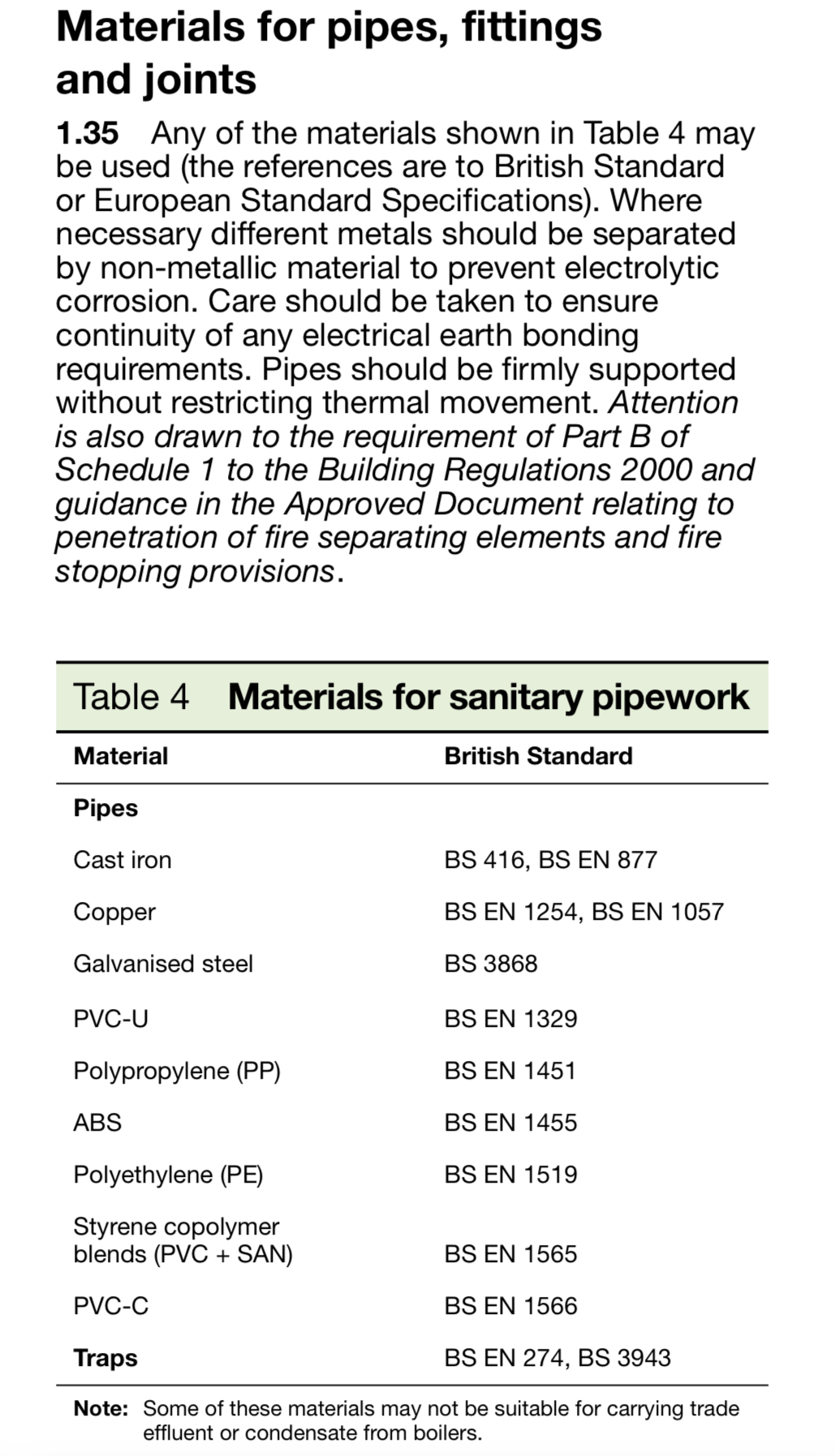

Internet Know How Posted March 9, 2023 Posted March 9, 2023 Hi All, When running soil pipe internally in a new build, is it ok to use the Orange pipe which would normally be sold as an underground? I wasnt sure whether from a regs perspective there was any mandated type here Thanks C
Big Jimbo Posted March 9, 2023 Posted March 9, 2023 I have used the orange internally before. Building inspector did not have a problem. They won't like you using the black stuff outside underground.

PeterW Posted March 10, 2023 Posted March 10, 2023 2 hours ago, Dave Jones said: all depends if its a warranty inspection as well. They very anal on those and getting worse as soo many warranty claims due to poor workmanship on the big sites. no they aren’t - warranty claims are down and NHBC aren’t paying out for a lot of issues that they used to. It’s an insurance policy and they will find every way not to pay. There is nothing in BS 13598 that states you cannot use the pipes above ground if adequately protected, nor in BS-EN 1329 or any of the others listed in Part H of the Building regulations as long as the pipe is manufactured within the standards. 2 1
