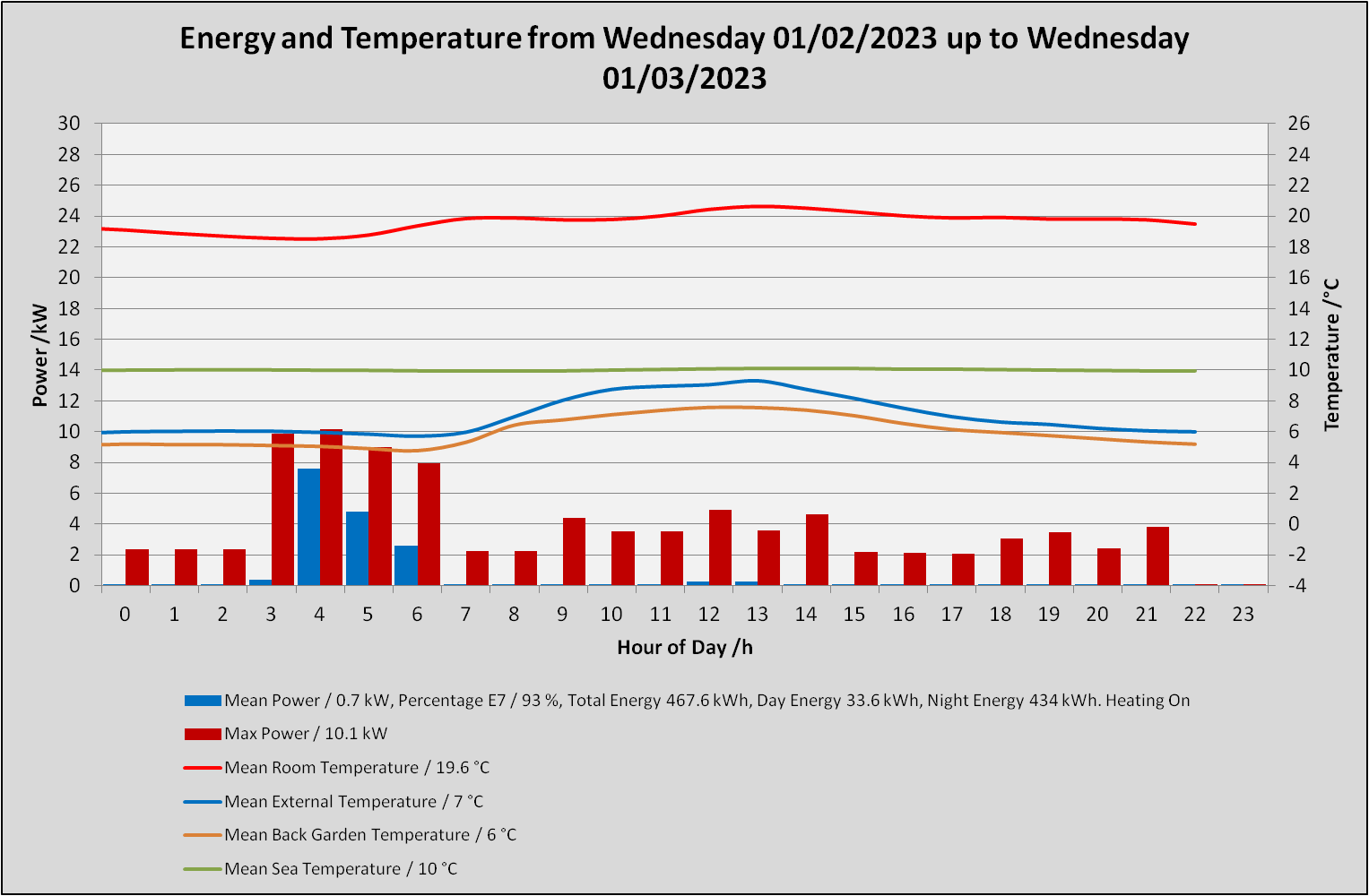

SteamyTea Posted March 9, 2023 Share Posted March 9, 2023 (edited) 11 hours ago, TerryE said: If you have an energy-efficient house which has a long thermal time constant (e.g if I was to lose heating now my house temp drops around 1-1½ °C per day) so it doesn't really when you pump the heat during the day, just that you pump enough day-to-day to balance out overall heat losses. And you don't need a slab weighting tonnes. My storage mass is less than 100 kg. Pump the heat in between 4 AM and 7 AM, job done. Edited March 9, 2023 by SteamyTea Link to comment Share on other sites More sharing options...
