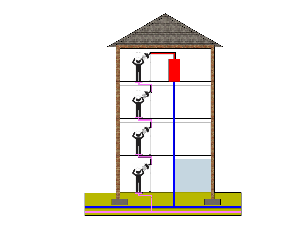

Iceverge Posted March 8, 2023 Share Posted March 8, 2023 I just had a genius idea so did a quick sketch. 300l Cylinder. No problems 4 Link to comment Share on other sites More sharing options...

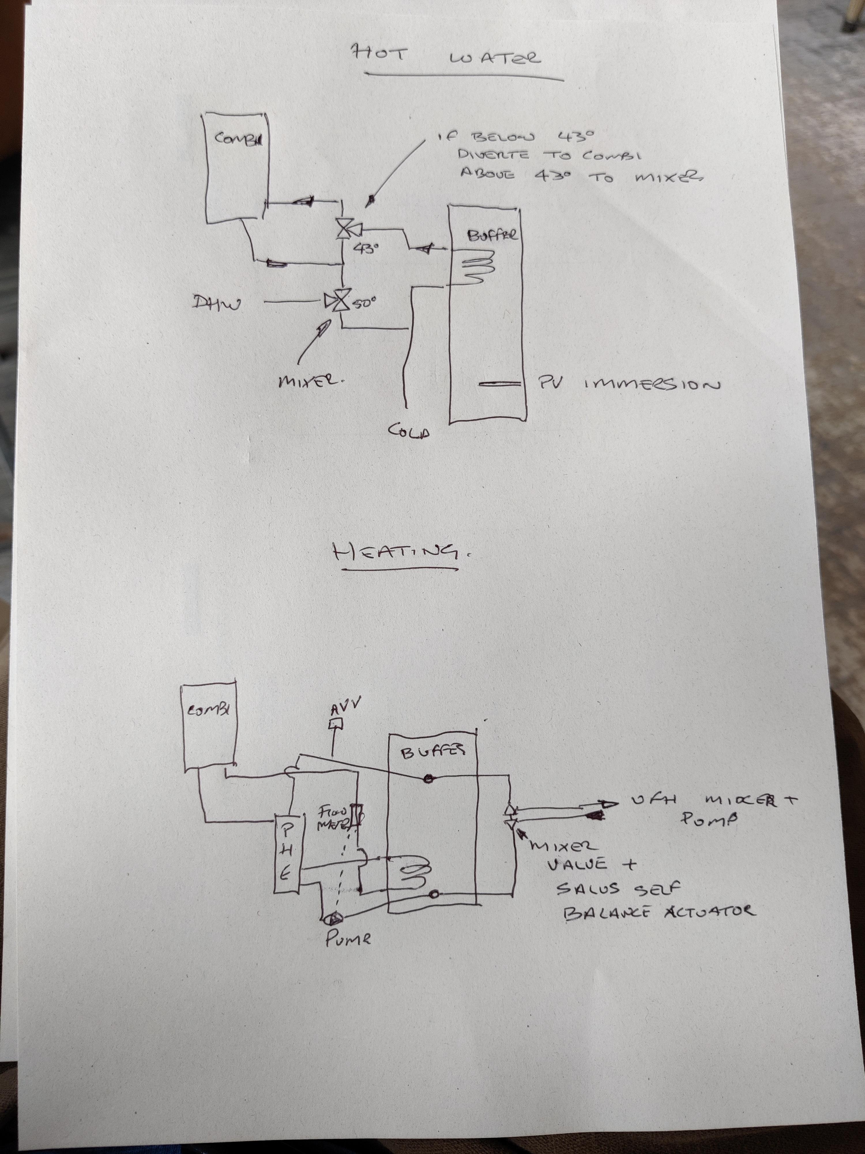

Nickfromwales Posted March 8, 2023 Share Posted March 8, 2023 3 hours ago, JohnMo said: Yes a Combi boiler and a combi-nation of components Ok, then does the combi not fire DHW to all outlets via the buffer? Eg when any hot water tap is run, the combi diverts to DHW mode? Link to comment Share on other sites More sharing options...
Nickfromwales Posted March 8, 2023 Share Posted March 8, 2023 1 hour ago, Iceverge said: I just had a genius idea so did a quick sketch. 300l Cylinder. No problems You have WAY too much spare time on your hands! PMSL. Link to comment Share on other sites More sharing options...

Onoff Posted March 8, 2023 Share Posted March 8, 2023 1 hour ago, Iceverge said: I just had a genius idea so did a quick sketch. 300l Cylinder. No problems Presumably you could do similar with WC pans and soil pipe runs? 1 Link to comment Share on other sites More sharing options...
JohnMo Posted March 8, 2023 Share Posted March 8, 2023 15 minutes ago, Nickfromwales said: 4 hours ago, JohnMo said: Yes a Combi boiler and a combi-nation of components Ok, then does the combi not fire DHW to all outlets via the buffer? Eg when any hot water tap is run, the combi diverts to DHW mode? The buffer is the combi thermal store. Cold water goes through the upper coil, all the time, if buffer is warm or hot, cold water is pre-heated, if above 43 degrees a diverter valve sends all preheated water to a mixer valve, if below 43 it all goes to combi boiler for heating then and gets mixed with cold via the mixer. Combi boiler water temp is set to 65, this gives the best gas usage overall. Multiple taps and showers at same are no issue. Link to comment Share on other sites More sharing options...
