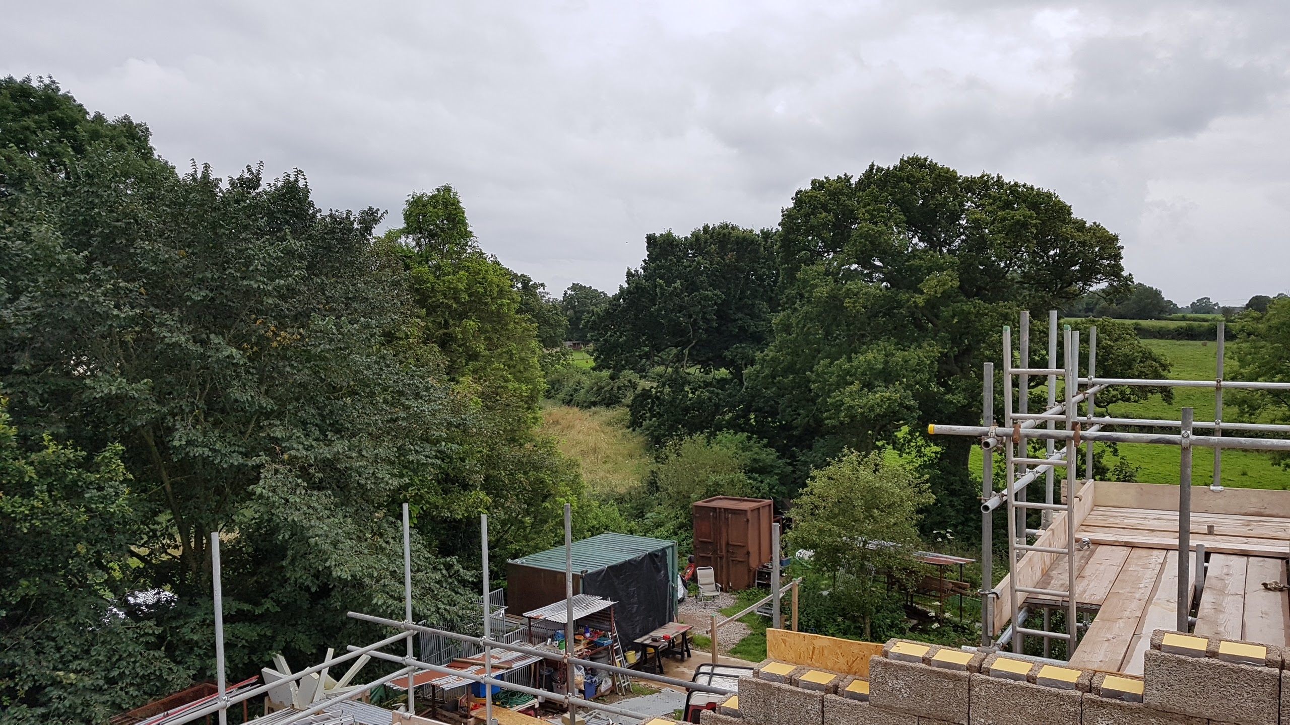

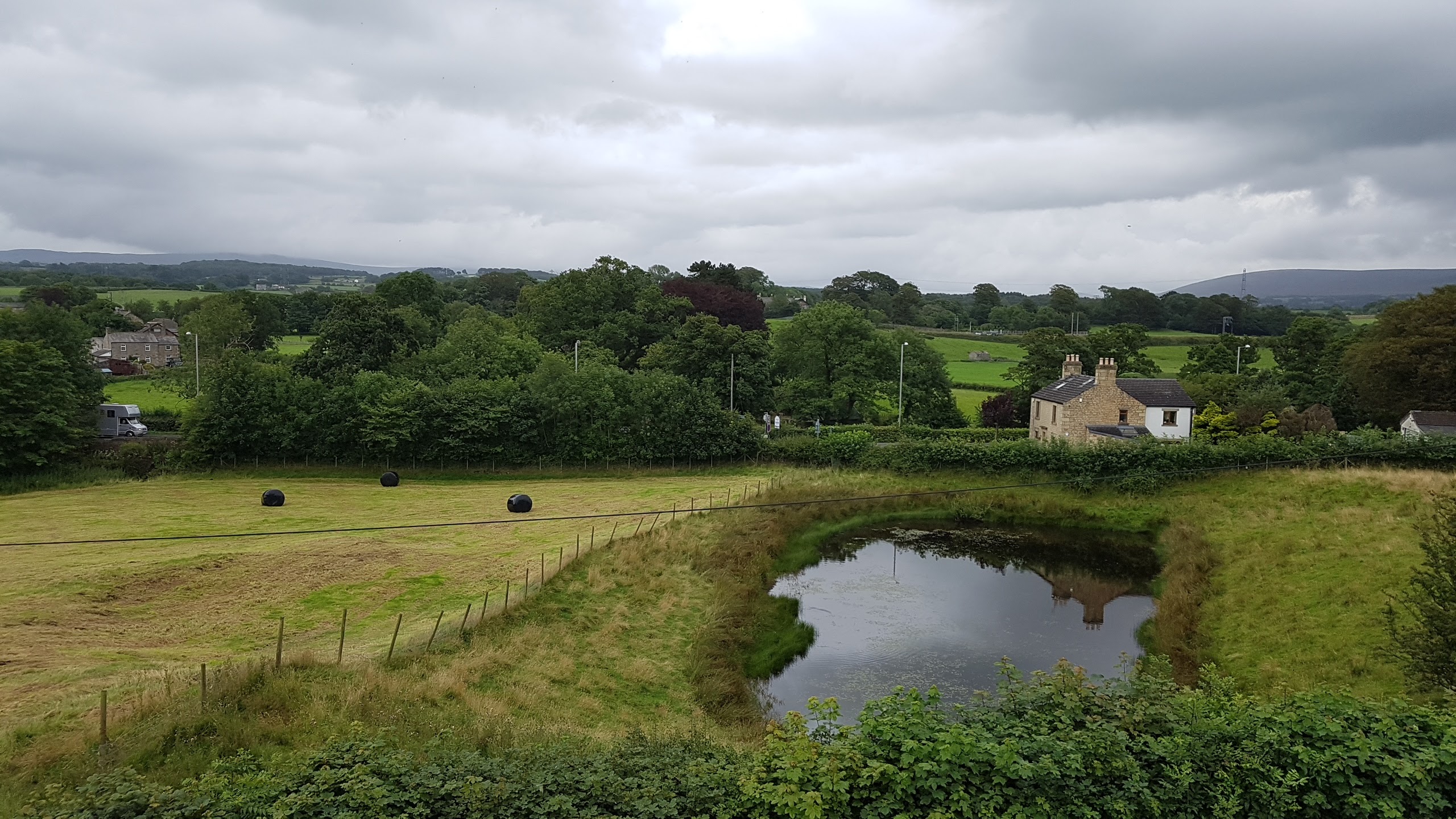

ToughButterCup Posted July 27, 2017 Share Posted July 27, 2017 Time for a calm analysis of what happened here. If you haven't read the original post, please do so now: it explains a good deal of what I say below. The weather. That night, it was foul. 30mph+ steady wind and gusting up to 50. I know that at low level it was gusting at 40 + because our plastic guttering rattles at that speed or thereabout. In addition, there's a hiss in the phone wires which (I have tinnitus) is very very close to the pitch I hear in my head all the time. So, background noise instead of cancelling out (or distracting from) my tinnitus was accentuated for the odd second or two in the heavier gusts. The key determinant in the collapse was direction. Here's the view due east (from the top of the scaffold looking eastward) Those hills are the Pennines. Looking to the skyline on the right thats 100 meters away from Forton Services on the M6. The gap in the hills is the Trough of Bowland. The Hills on the left are Clougha and Ward Stone. The wind was from the east that night. Just out of sight between the pond and the hedge is a steep slope. Perfect to create a pressure wave suitable for a slope-soaring glider. By contrast look at our view West The view from the site westward. Four fields away is Morecambe Bay. Look at those wonderful energy absorption systems. Trees. I make this post because of what happened last night. Sailors, hill walkers, glider pilots, GA pilots will understand this all too well. A vicious thunderstorm went through at 21.30 last night. Preceded by a gust front from the west that would have done justice to a small jet engine. It hit the house with a sickening thud, instantly rattled the guttering, and I shot out of bed. Still half asleep I stumbled out into the rain hail and thunder with Debbie's calm words ringing in my ears.. "What do you think you can do about it?" Rushed into the container, dug out my laser plumb line and set it up to see if the blocks were moving. By the time I had fiddled, cursed fallen over, smacked my cheek on the door, trodden on the cat (bless him) woken the dogs and got the laser setup, the wind was abating, but it was hissing down hard. I could see the back edge of the front clearly delineated out to the west in the last of the failing sunlight. Standing out in the open in front of Salamander Cottage hardly a breath of air on the ground, the tops of the trees' west side were still rattling loudly. 10 minutes later, not a breath of wind anywhere. Wind direction matters. Wind strength matters. Local topography matters. Especially when a builder doesn't see the wider picture. Link to comment Share on other sites More sharing options...
