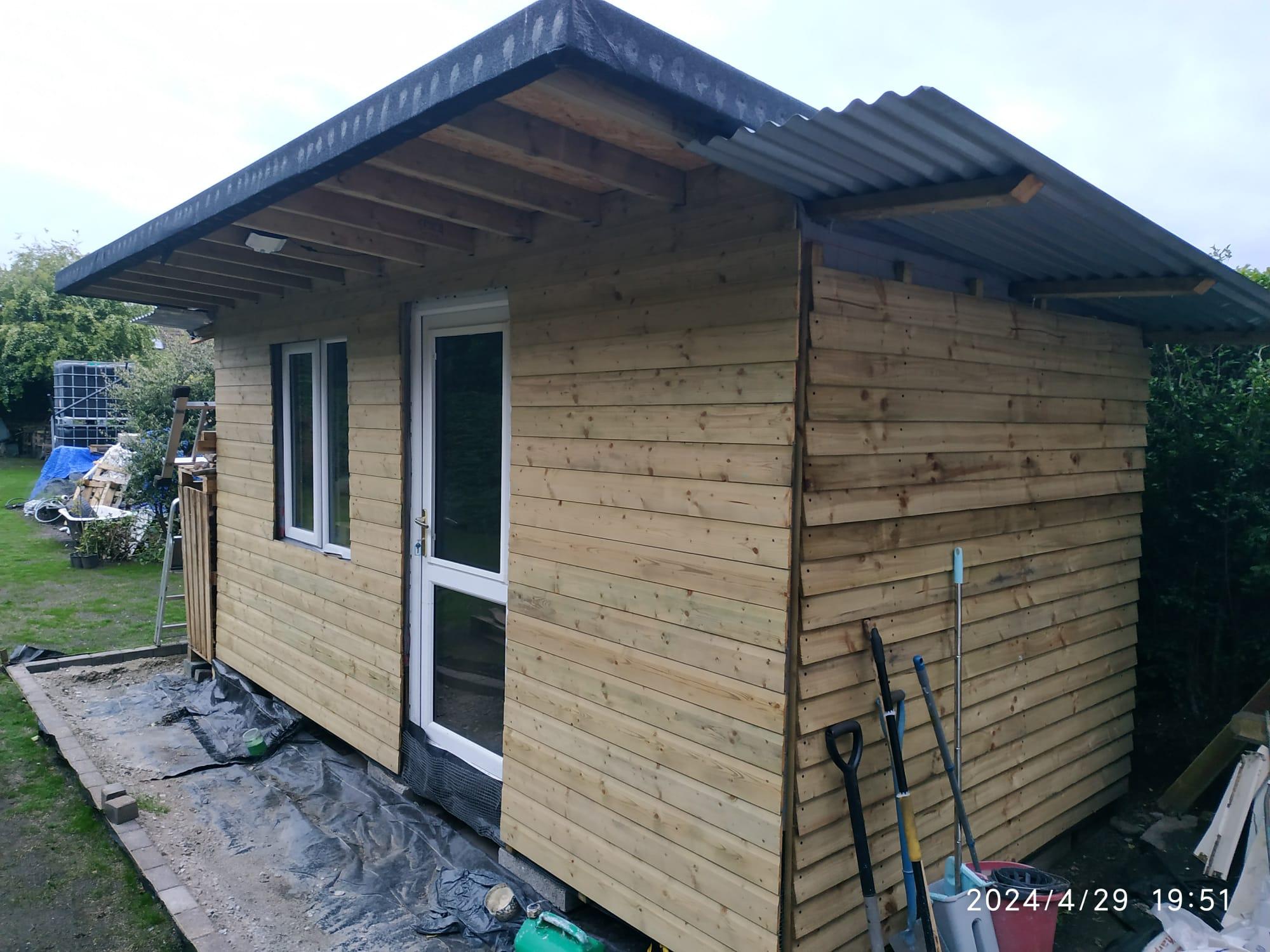

JohnBishop Posted April 29, 2024 Author Share Posted April 29, 2024 Just another picture of the shed. Not finished yet but done the cladding, just need to finish of some bits and pieces. 4 Link to comment Share on other sites More sharing options...
