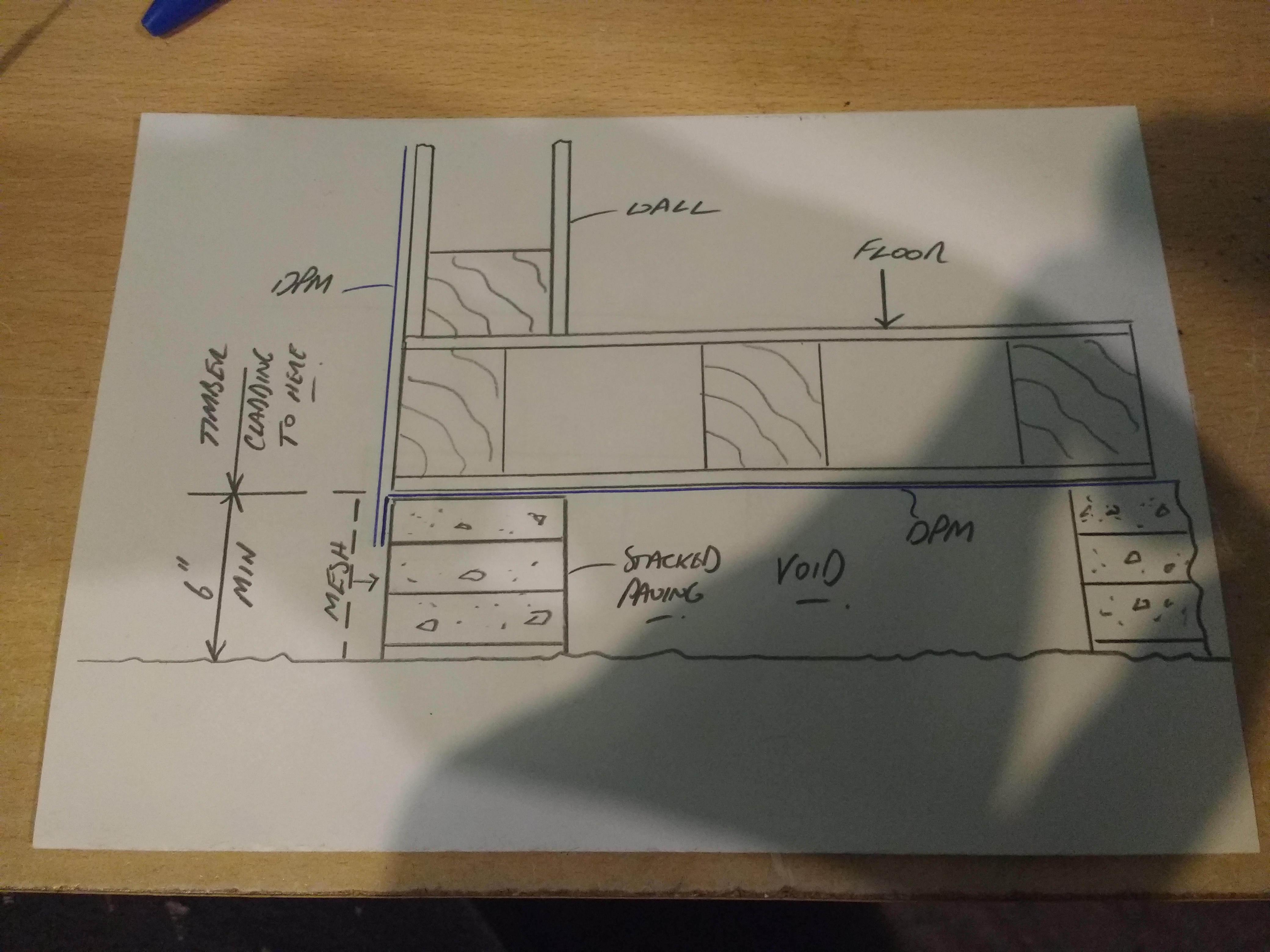

Hi All,
I am preparing to build a shed from EUR pallets. These are very strong with 22mm planks.
I want to put anti-weed membrane on the ground then concrete blocks.
What concrete blocks should I use that will last?
Please advise.

Any dense concrete block will last. Don’t go for celcon or any other insulation block. Reclaimed paving slabs would be ideal for this sort of job.
if I use paving slabs do they have to cover the whole area of the shed or just provide support for the pallets?
I understand I should wrap the pallets from underneath with DPM.
No need to cover entire area, would be a pain to level and pallets not rocking. Whole or part slabs stacked to support corners of pallets would work well

Quick, fag packet thoughts:
Thinking leave the void but use a strip of rodent mesh around the perimeter. You could over clad with say uPVC or asbestolux type cement board...paint it black...

Erm, no I haven't used any paving, only ever built sheds on slabs. I just sketched it as you said that's the way you want to go.
3 2" council slabs would raise you 6" if you could get them for nothing/cheap. Or 140mm 7N dense concrete blocks. Cast your own plinths from knocked up timber boxes. Loads of options.

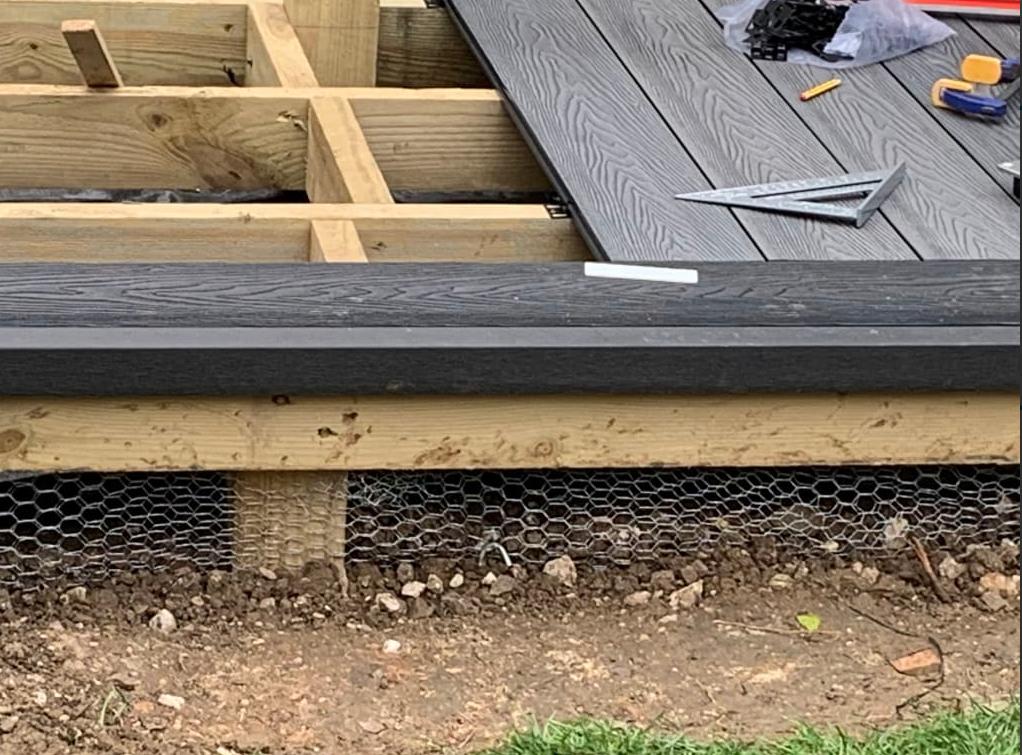

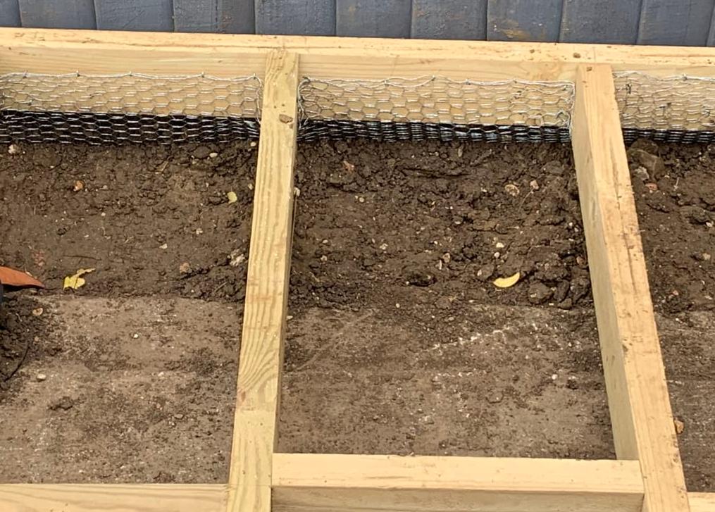

Do you think this chicken wire mesh is sufficient to prevent rats?
I don't think it prevents mice though.
Rats have strong teeth that curve slightly inward. Consequently they can chew through quite a lot of stuff if they can get their teeth into it. Google rodent proof mesh. It’s stainless steel woven mesh with varying hole sizes.
They are also burrowing critters so you want the mesh to be buried about 10” and formed in an L shape facing away from whatever you’re protecting. The only reason I know this is because when you start off rodent proofing stuff it becomes a battle of wills and escalation as the various things you try don’t work. 😂
