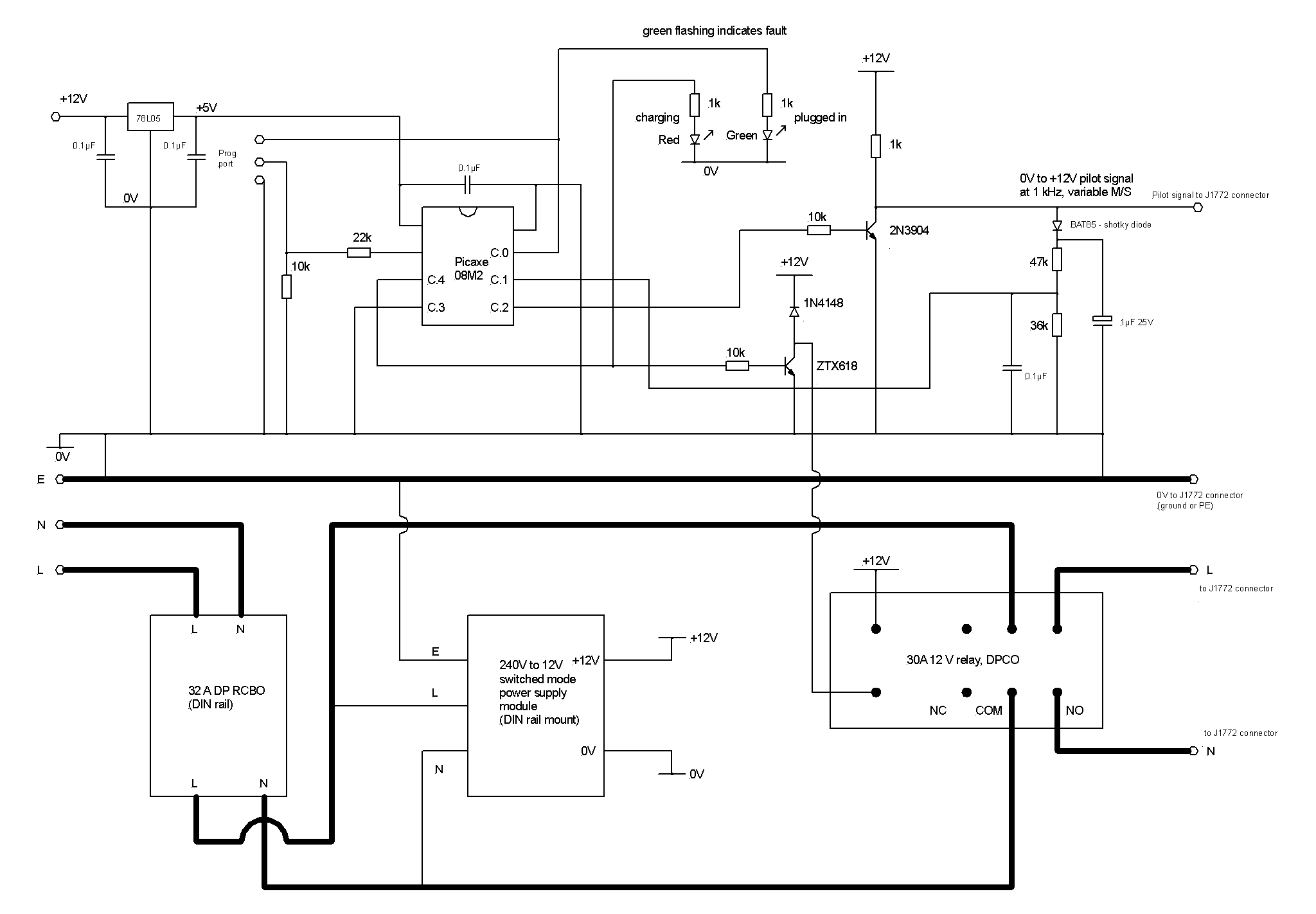

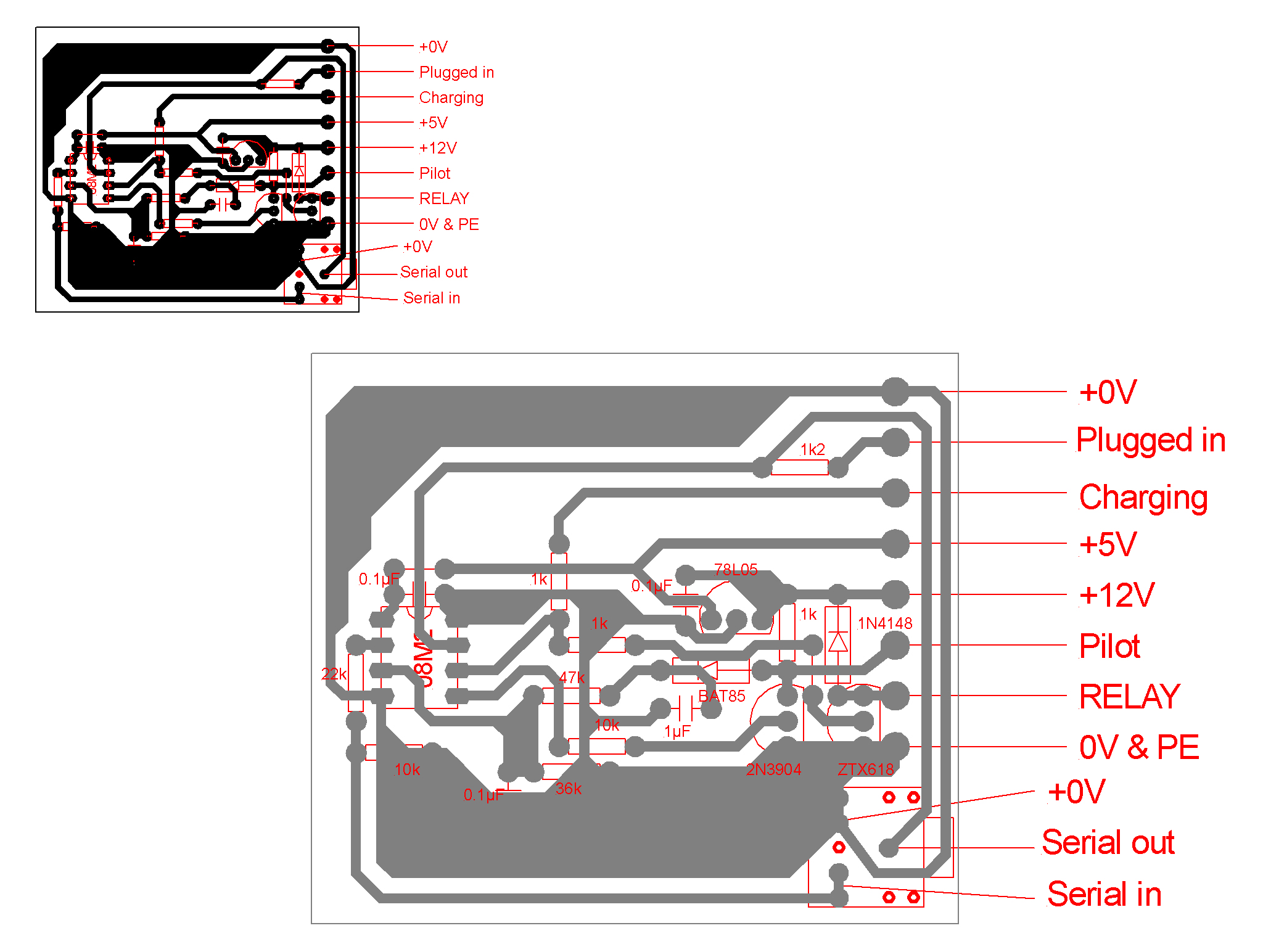

Jeremy Harris Posted October 18, 2017 Posted October 18, 2017 (edited) Here’s some more info on EVSEs, a schematic and generic parts list for my basic 15A/30A version (max current can be changed in firmware – the components are all rated for 30 A). First you need a 32 A capable Type 1 plug: https://evconnectors.com/electric-vehicle-chargers-and-accessories/j1772-32-amp-plug-and-cable-ds1-ev32p-nc, unless you are only looking to install a 15 A EVSE, in which case you could look at getting a 16 A plug: https://evconnectors.com/electric-vehicle-chargers-and-accessories/j1772-16-amp-plug-and-cable-ds1-ev16p-nc You can opt to buy the plug and a special 5 core cable, from the same links, but the cable is a bit expensive and you only actually need 4 cores (I’ve never understood why they run both pilots up the cable, as one is either unused or cut off and terminated at the EVSE plug end, if you go for a cable with a plug on both ends). It’s worth making a decision now as to whether you wish to use public charge points, as you can save some money buy making your home charge cable fir both your home EVSE and a public charge point. This costs more for connectors, but there is an overall saving. A 5m cable will be fine for all public charge points that use an IEC62196-2 socket. I’ll assume for the moment that you just want a 15 A or 30 A home EVSE with a tethered lead. If you want to make up your own lead and connector, then 4 core H07RN-F cable is ideal, as it’s very tough and remains flexible in very cold weather. For a 15 A EVSE you can use 4 core 2.5mm², for a 30 A EVSE you need to go up to 4mm² cable. As a guide, this link shows prices from Quickbit, who are generally fairly competitive: https://quickbit.co.uk/cable/cable-h07rn-f-cable/h07rn-f-cable-4-core Terminating the cable inside the Type 1 connector ideally needs the proper crimp tool, but it is possible to solder the cables to the buckets in the pins with care, and there’s plenty of strain relief, so solder doesn’t present a reliability issue. If you don’t have a big soldering iron (the pins are around 6mm in diameter and do need a powerful iron), or a crimping tool, then it may well be better to just bite the bullet and buy a Type 1 plug with a cable already attached. You will need a waterproof consumer unit type box to fit everything into. I use Italian made boxes that have room for the circuitry, and space to take an IEC62196-2 socket on the front, if you want to go down that option. These are on Ebay: http://www.ebay.co.uk/itm/IP65-MCB-RCD-Enclosure-Caravan-Hook-Up-Distributiobn-enclosure-adaptable-box-/251948088117?hash=item3aa946bb35:g:NpAAAOSwd4tUCdfa from 247 Supply, and have enough room to take a 12V power supply, a 32 A DP RCBO, and the circuitry. The relay is mounted next to the PCB in the blank area of the box at the bottom. You can either fit a cable gland at the base of the box to take the trailing lead, or you can just fit an IEC62196-2 socket on the front if you wish to make an EVSE that works like a public charge point, with no tethered lead. There a pros and cons for each option, and I’ve built one of each, at opposite ends of the drive. 99% of the time I use the one with the tethered lead, as it’s quicker to uncoil and plug in. Rapid electronics can supply all the components. The relays I used were Finder 66.82.012.0000 that are rated at 30 A at 240 V, with a 12 V coil. They are easy to fix down with screws. I used an alloy plate cut to fit the back of the box and mounted the relay and circuit board on that. The power supply I used was a Meanwell 12V DIN rail mount one, that has some spare capacity (one on mine also runs a wireless CCTV camera). The model is their DR-15-12, which has the stepped top needed to fit inside a consumer unit type box. The LEDs can be fitted in holes drilled in the spare spacers to the side of the RCBO and power supply, so they can be seen under the clear cover. The code for the microcontroller needs to be programmed in via the serial port connector at the lower right of the board, and is tweaked depending on whether you want a 15 A or 30 A EVSE. The same basic circuit is used for the variable supply unit, but I feed in serial data from a radio link to the unused input port, C.3, so the PCB is slightly different, with that pin broken out, along with +5V and 0V for the serial data radio module. The firmware is also a lot different, as it constantly polls the receiver to get the current state of excess PV generation (if there is any) and adjusts the mark-space ratio accordingly. I can post the code for the basic EVSE later if you feel up to making one, and can easily make a PCB for you and programme the chip. If not, then there are some good kits around at not far off the same price, that don’t need so much DIY. This is one option: http://evbitz.uk/EVBitz.uk/EVSE_Kit_-_Type_1.html that uses the Viridian EVSE module, that has all the control stuff and contactor already built in. These kits will fit into the enclosure I used, and you can choose to just buy the Viridian EVSE controller (http://evbitz.uk/EVBitz.uk/Viridian_EPC.html) and the Type 1 plug and buy your own cable and box. This is the schematic: And this is the PCB layout: Edited October 18, 2017 by JSHarris 1
