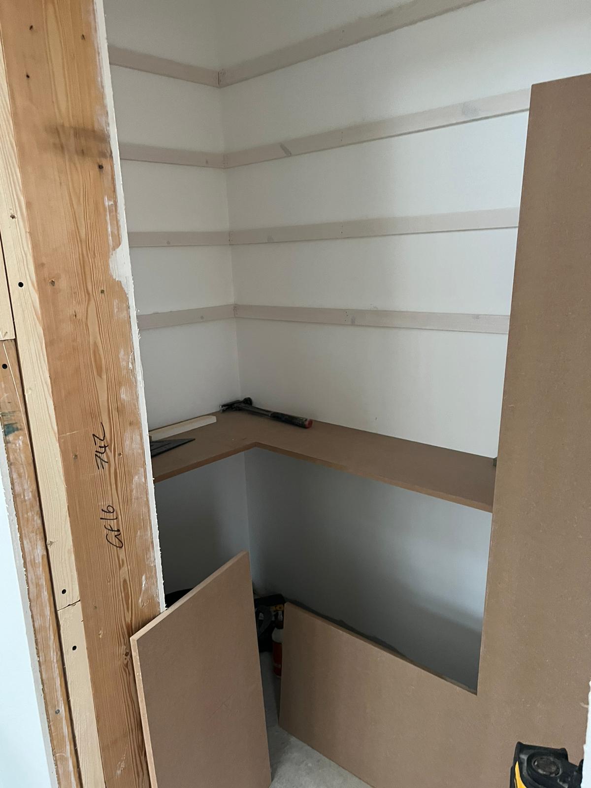

I have just asked my joiners to make shelves for our pantry and all our cupboards.
They were 18mm MDF strapped with 2x1" dressed pine. They will support a load no issues. MDF nowhere near as strong as 18mm ply.
44mm thick seems awfully thick
I didn't take a finished pic tonight but here they are mid process

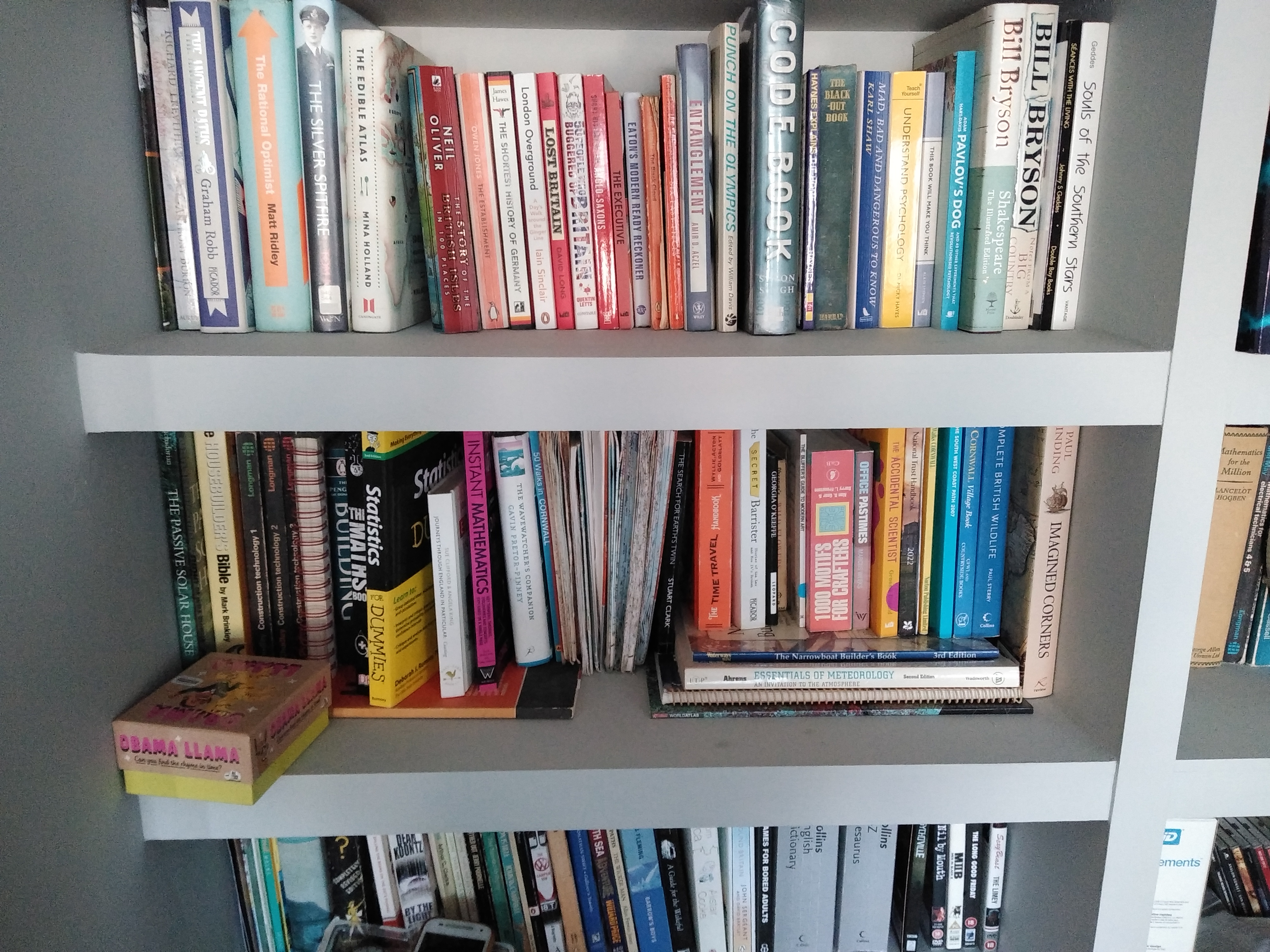

That isn't really how you make MDF shelfs, those brackets are more used for solid timber, like oak or oak mantles. These thick floating shelves are usually made up with a timber frame inside.
I made the stereotypical floating shelves in an alcove unit, first I built a frame in 30x30 pine, fixed that to the wall, then fixed a piece of spray painted 12mm MDF to the bottom, then I created the top of the shelf with 18mm MDF with a return on the front with 12mm MDF, that was all filled/sanded and sprayed to create a seamless finish, that was then simply offered up to the frame and it is held in place just with the caulk - I also incorporated LED lighting into the front edge.
If I just wanted a plain floating shelf, I would build a timber (or metal) frame, fix to the walls. Then make a "sleeve" piece -i.e. 2 pieces of MDF joint with a front piece - fill and prep the whole lot and paint (spray paint for me).

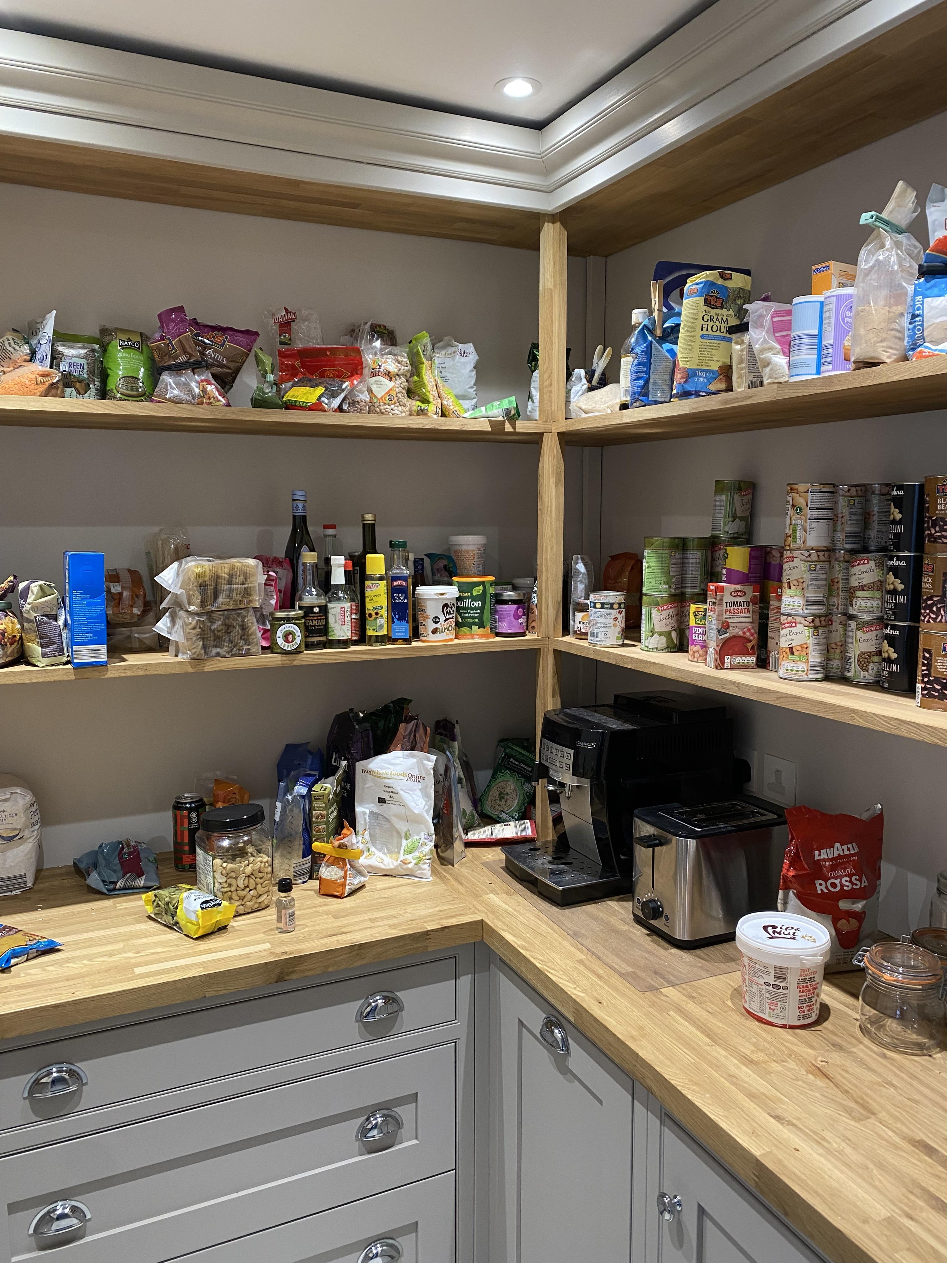

I used oak worktops for my pantry shelves, they come in almost whatever size you want. You could always use laminate worktops if you don't want real wood. Topped them off with cornices to match the kitchen. Pantry needs a tidy up but hopefully you get the idea.                            image.thumb.jpeg.2673a65e90abc80f900bcdb14c2cbf31.jpeg
