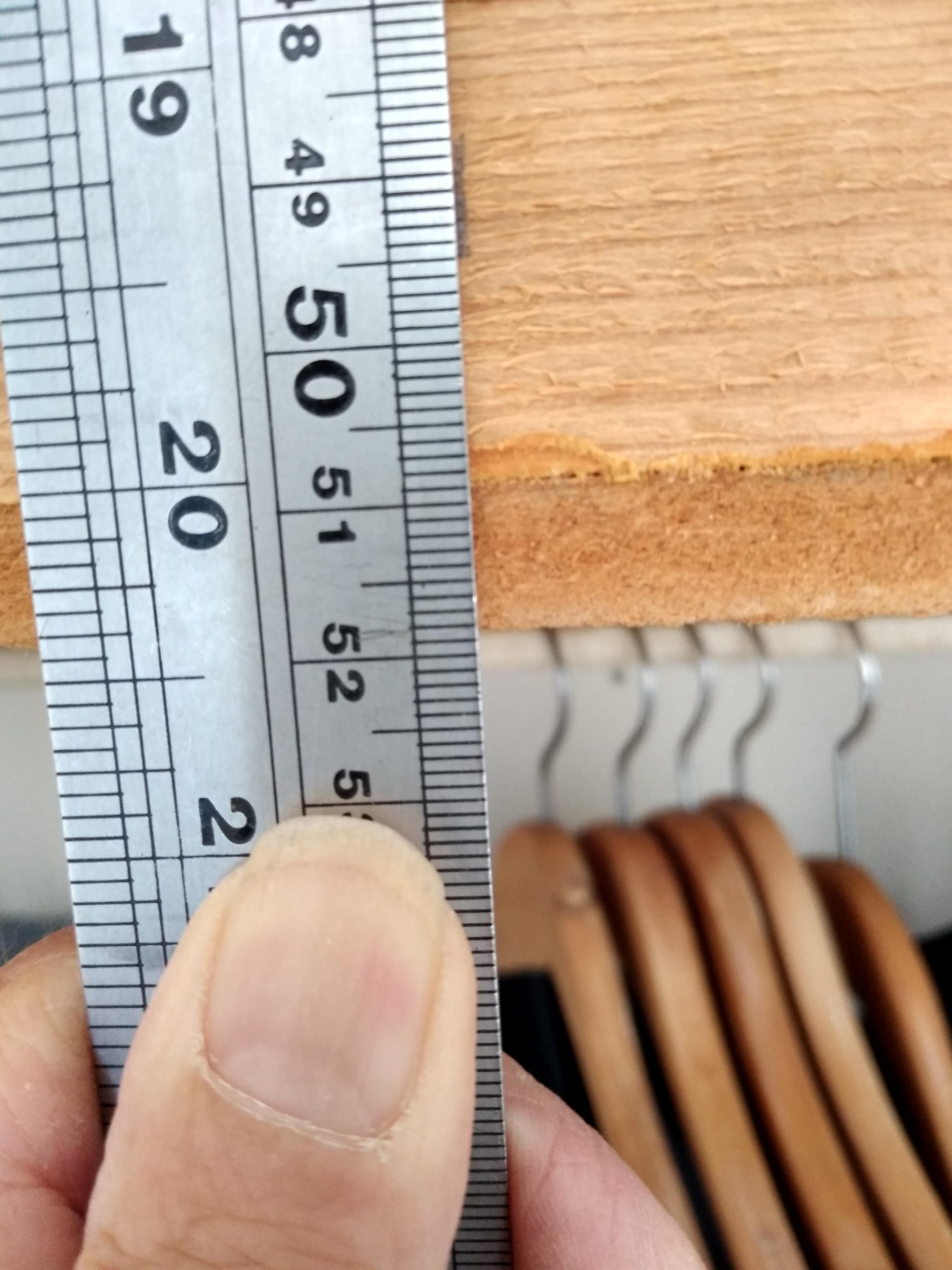

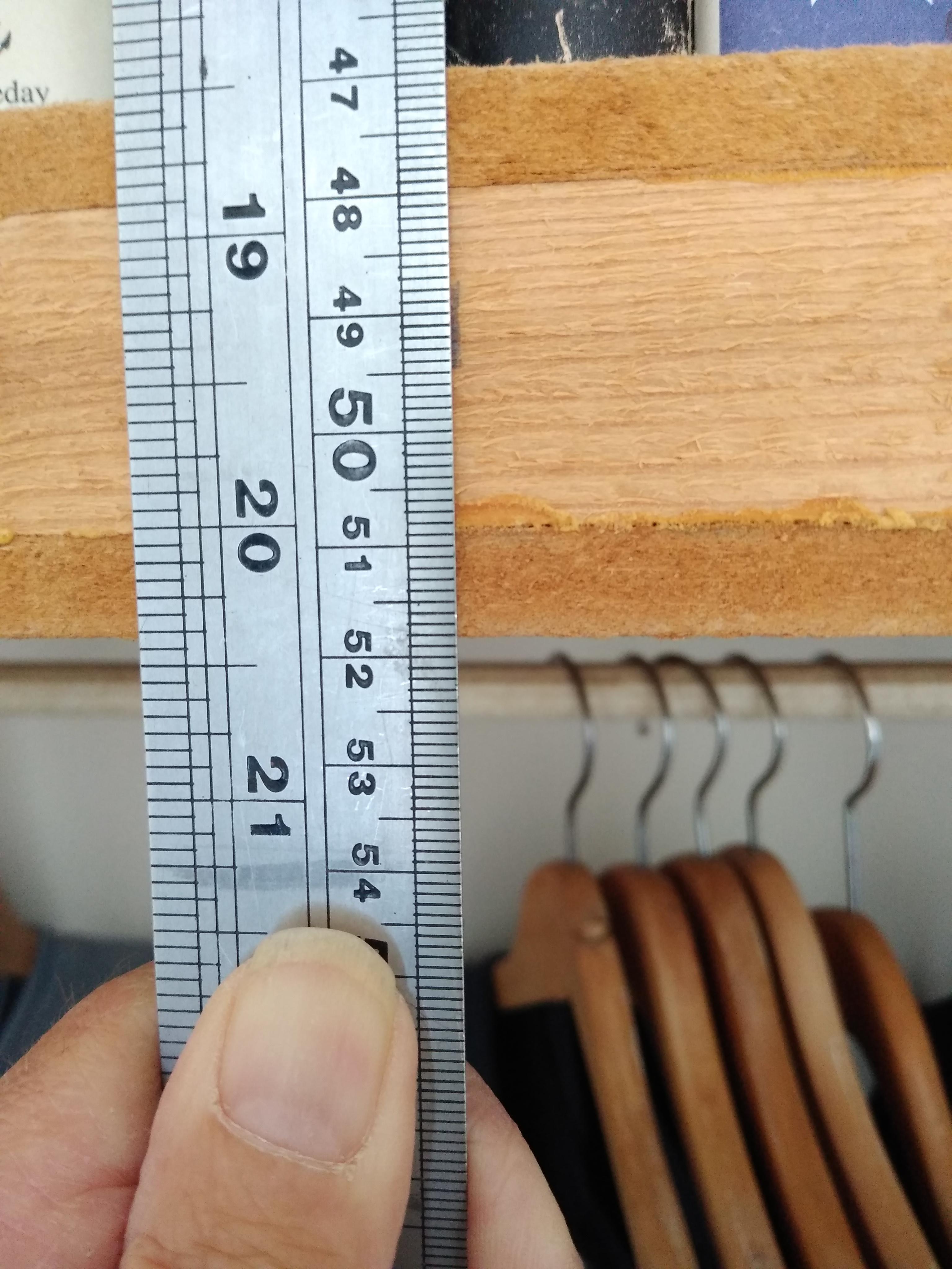

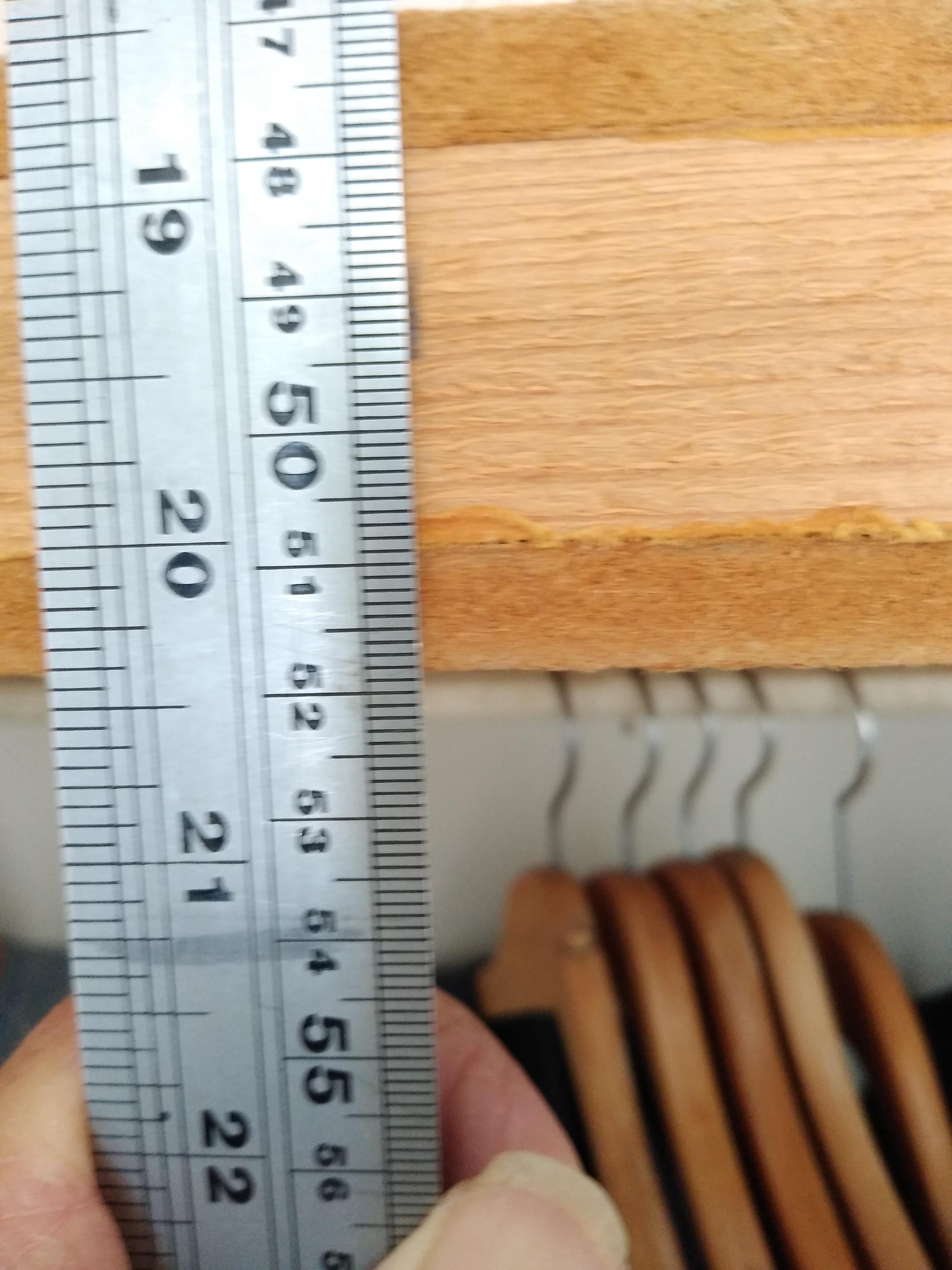

@Adsibob
I made a shelf a while back.
It is 0.88 m wide, 0.47 m deep.
It is made from two sheets of cheap 10 mm MDF, with a bit of 40 mm by 30 mm (I think) rough sawn pine separating them.
The same sized timber strips are screwed into the wall in 3 sides and the shelf slid over them. I think there are 4 timbers inside the shelf, one each side close to the wall supports, and two more evenly spaced.
So to see how much it moved when loaded I measured from the ceiling to the bottom of the shelf at the mid point. 518mm.
Then I stacked it with 10.85 kg of books in the middle, at the front. 519 mm. So 1 mm drop.
I then spread the books out like a proper library, 518.5 mm.
So basically with an 11 kg load, no movement.
I may have the pictures in the wrong order, but as there is so little movement, it don't matter.
No load
Stacked books.
Spread out books.
