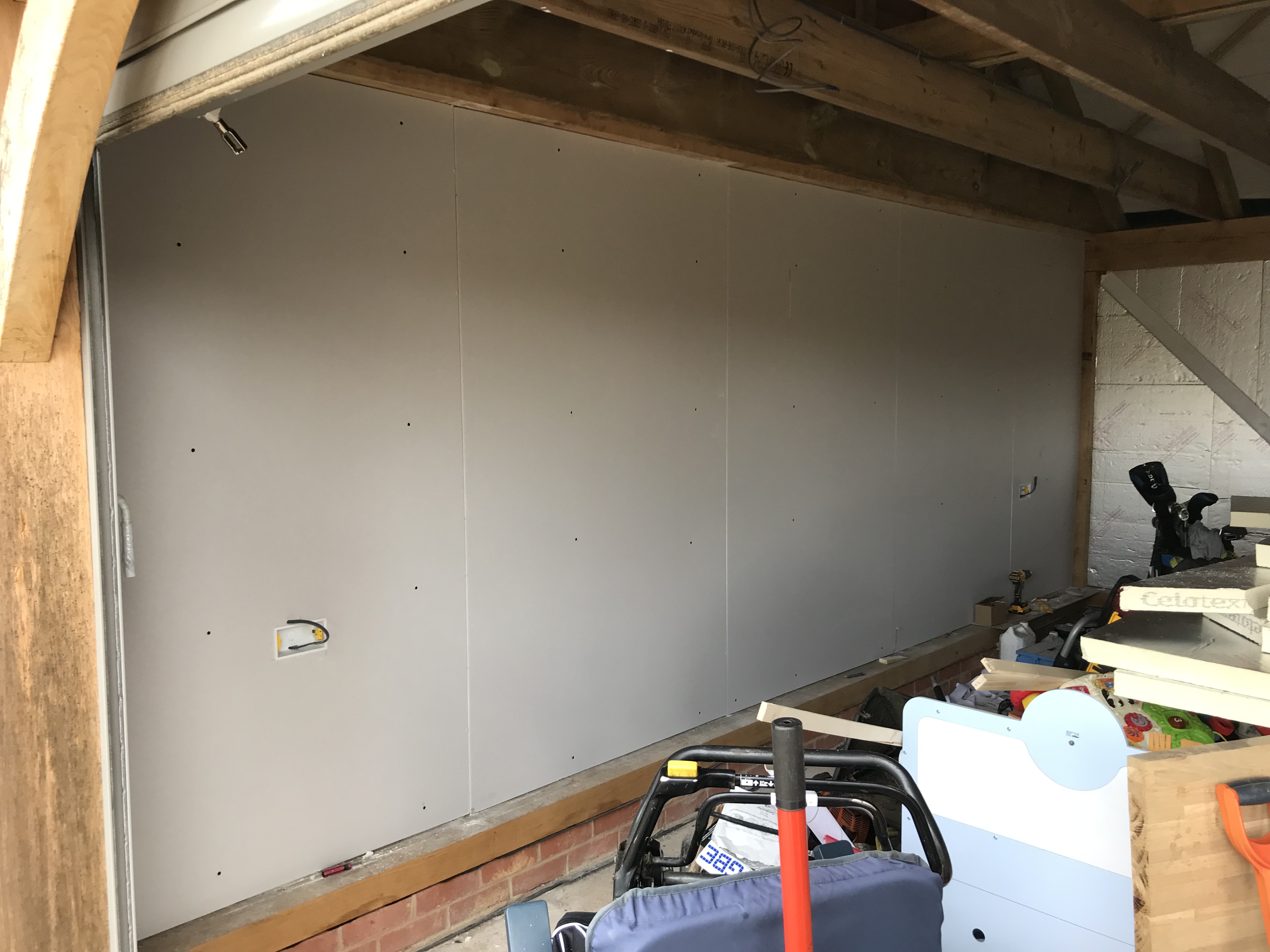

Dan1983 Posted February 23, 2023 Posted February 23, 2023 Evening all, Please could I ask for some advice on plasterboarding. I have started to board out my oak frame/ wood clad garage. It has a breather membrane then 50mm celotex, then 12.5mm plasterboard on top. The uprights I’m fixing to are 600 centers but not really wide enough to fix two boards to. This means I’m ending up with approx 450mm overhang on some boards due to the spacing. There is no movement in the boards as they are hard up against the celotex. Will this cause issues later? Only thing I can think of doing is bonding the unscrewed section of board to the celotex. Thanks for any pointers!
Nickfromwales Posted February 23, 2023 Posted February 23, 2023 Ah, schoolboy error. You have 600mm centres so should have one stud in the centre and one each end of each board ( hence 1200mm boards ). You can get some Knauf board adhesive in tube form, loosen the board off, and bond them onto the PIR and to each other. Use a scraper and a sponge to clean up excess, and don't go mad with the adhesive. 1
Nickfromwales Posted February 23, 2023 Posted February 23, 2023 Something like this will do tbh; https://www.google.com/search?q=gypsum+adhesive&sa=X&rlz=1C1GCEA_enGB860GB860&biw=1536&bih=754&tbm=shop&ei=r933Y46xFI7VgQa0tYmoBQ&ved=0ahUKEwjOxJKTzqz9AhWOasAKHbRaAlUQ4dUDCAg&uact=5&oq=gypsum+adhesive&gs_lcp=Cgtwcm9kdWN0cy1jYxADMgcIABCABBAYMgkIABAeEPEEEBgyCAgAEAUQHhAYMgsIABAIEB4Q8QQQGDILCAAQCBAeEPEEEBgyCwgAEAgQHhDxBBAYMgsIABAIEB4Q8QQQGDILCAAQCBAeEPEEEBgyCwgAEAgQHhDxBBAYMggIABAIEB4QGDoKCAAQgAQQsAMQGDoJCAAQCBAeELADOgkIABAeELADEBg6DggAEAgQHhDxBBCwAxAYOgsIABAIEB4QsAMQGDoJCAAQDRCABBAYOgYIABAHEB46DQgAEAgQHhANEPEEEBg6CggAEAgQHhANEBg6CggAELEDEIMBEEM6CwgAEIAEELEDEIMBOgUIABCABDoLCAAQHhANEPEEEBg6CggAEAUQHhANEBhKBAhBGAFQiRtY7DVgtUFoAXAAeACAAY8BiAHTCZIBBDAuMTGYAQCgAQHIAQrAAQE&sclient=products-cc#spd=9699038899737614391 1
Radian Posted February 23, 2023 Posted February 23, 2023 Or... Small area like that, just bond another staggered layer of PB on top. Increase the fire rating, decrease the sound etc. 1
Dan1983 Posted February 24, 2023 Author Posted February 24, 2023 Thank you guys, Yes error on my part! Glad I’ve learnt this lesson on the walls and not the ceiling! Ive ordered some adhesive and will bond the edges. Think I should stick to my day job!

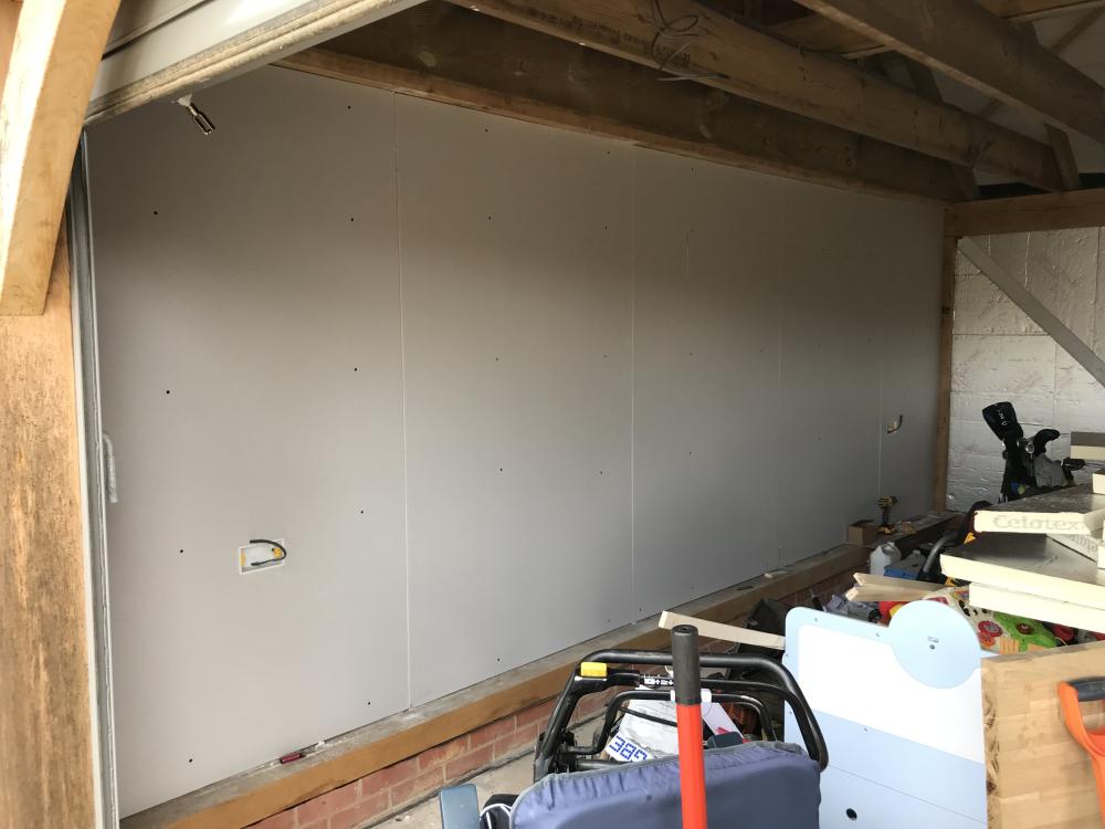

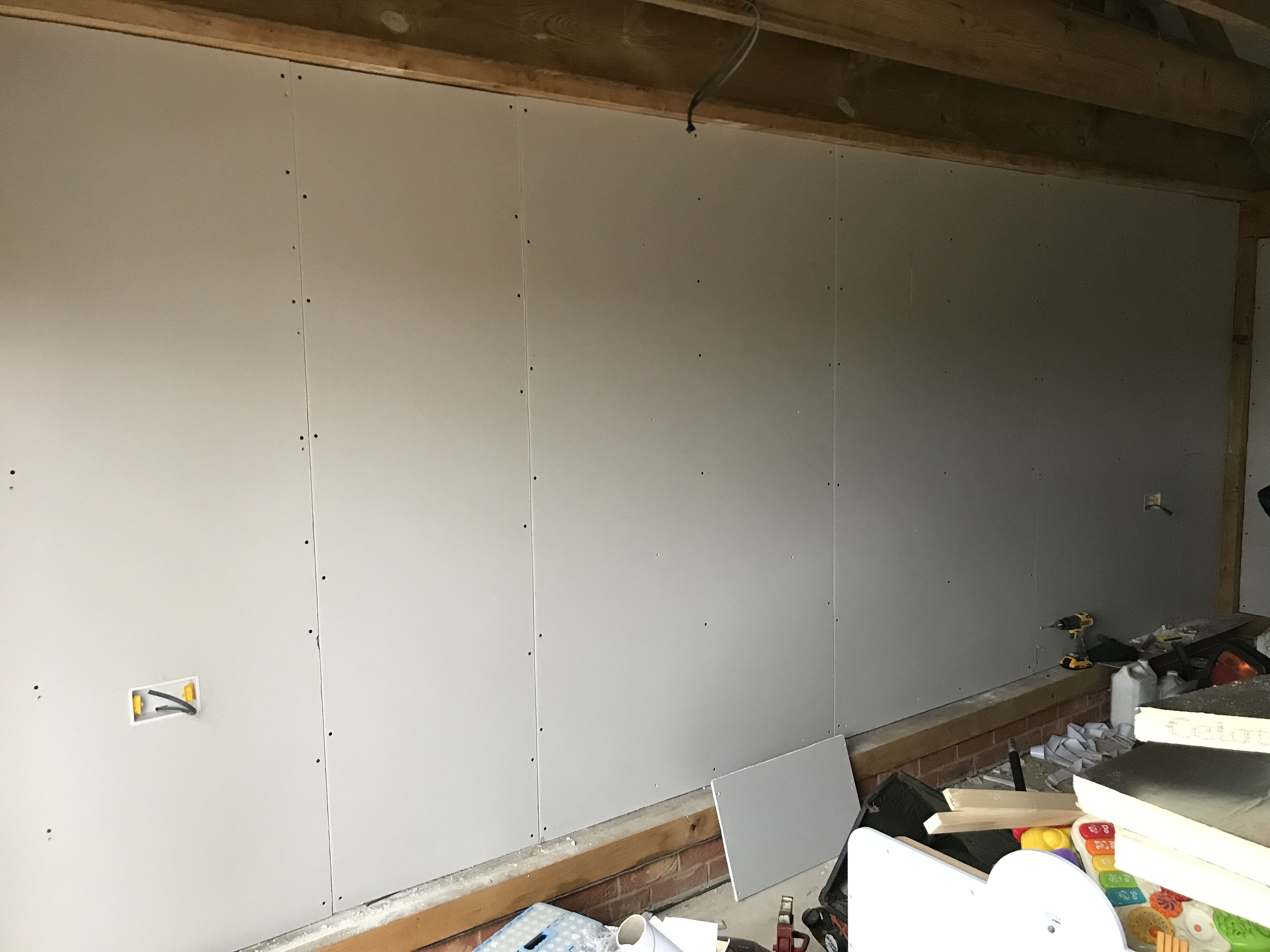

Dan1983 Posted March 3, 2023 Author Posted March 3, 2023 OCD got the better of me and re did the 3 naff walls!
markc Posted March 3, 2023 Posted March 3, 2023 Well done, not enough bullet holes for @pocster tho 😉 1 1 1
Mr Punter Posted March 3, 2023 Posted March 3, 2023 26 minutes ago, Dan1983 said: Nice job. Did that package in the foreground come from @pocster? 1 1
Dan1983 Posted March 3, 2023 Author Posted March 3, 2023 😂 Do I need to fill the bullet holes or just let them be skimmed over? i think the parcel is a lamp post but is a dodgy shape!
markc Posted March 3, 2023 Posted March 3, 2023 1 hour ago, Dan1983 said: 😂 Do I need to fill the bullet holes or just let them be skimmed over? i think the parcel is a lamp post but is a dodgy shape! The skim will sort the screw craters 1

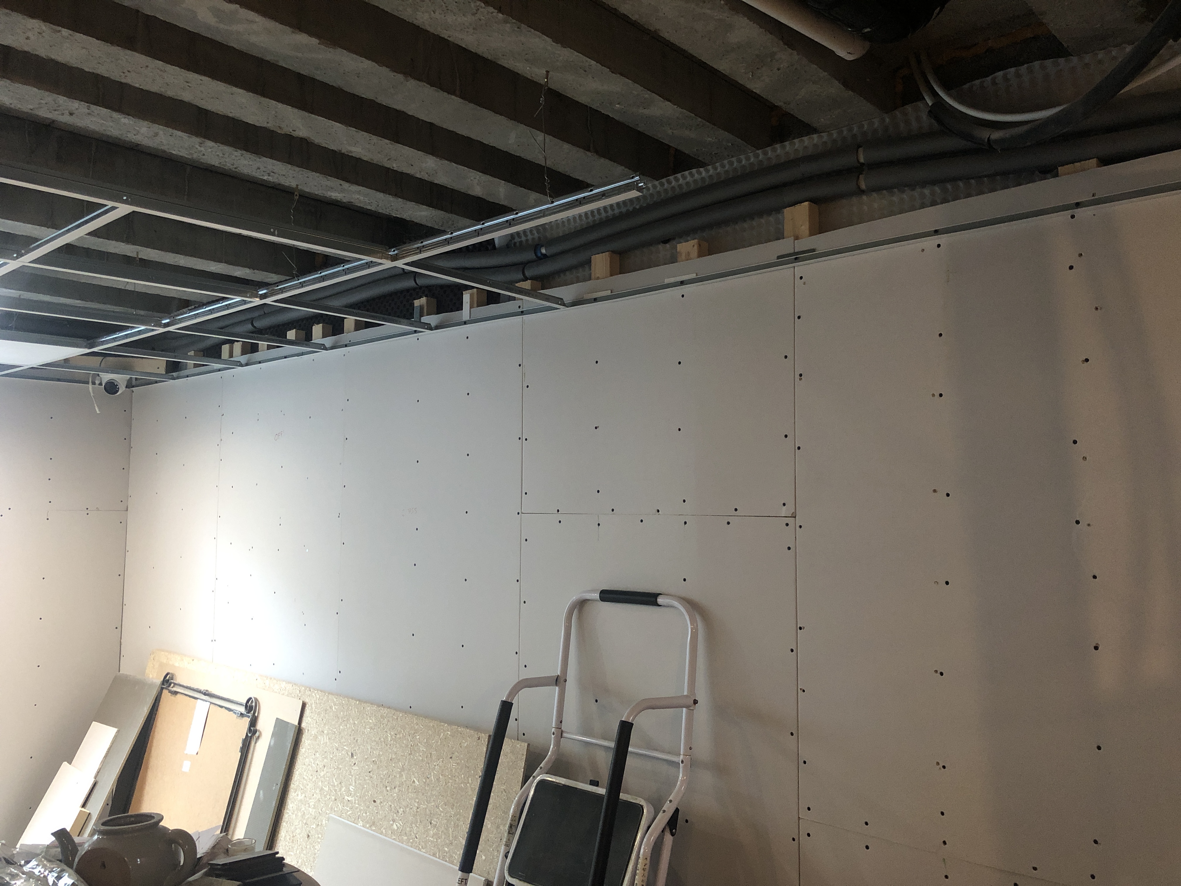

Pocster Posted March 4, 2023 Posted March 4, 2023 3 hours ago, pocster said: Suck on this humans Before you all bitch … 300 centres because plasterboard is only 9.5mm . Short boards as I can’t get full boards down my temporary staircase . So noggins at joins . Timbers deliberately left visible above ceiling line so I can a) fix any ha / electrics to them b) no need to “ hunt the timber “ when I need a wall fixing . So there ! 3
