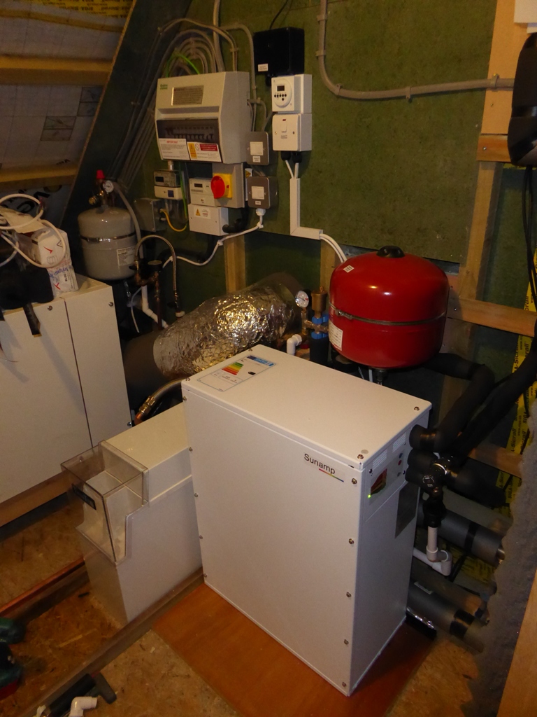

MrMagic Posted July 17, 2019 Posted July 17, 2019 @JSHarris @NSS @PeterStarck - Whats your running costs like on the block salt based systems? Rough £/month or number of blocks used etc. Any tips on where to buy etc. Seeing the picture of the Sunamp heater in the other thread and looking at my kettle... I think I need to do something about it!!

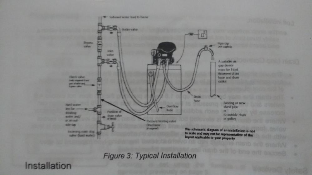

Onoff Posted July 27, 2019 Posted July 27, 2019 (edited) A while back I bought @PeterStarck's Wrekin 367/606 softener. (He has a new one in the new place that I believe doesn't require an electrical connection). I've been put off fitting it as busy with the bathroom for one but mainly because of where to put it. The house layout is a bit odd. On the NE face I've the mains coming into the small, original, cloak WC. That "end" of the house I've the: NORTH WEST - G.floor - Cloak - WC & basin - G.floor - Main bathroom - WC, bath, basin & shower - 1st Fl - Ensuite - WC, basin, shower The cold water mains goes up into the loft, up the side of the dormer, then across the top the dormer to the other end of the house where it drops down on the SW face. On the direct opposite, SW side of the house about 18m from the mains point of entry, I've the kitchen and oil boiler. So: SOUTH WEST G.floor - Boiler, Sink, Washing Machine, Dishwasher 1st Fl - Hot water cylinder, shower pump Above dormer ceiling - CWS tank and header. Do I look to site the softener local to the incoming mains, somewhere accessible for salt dosing etc then just take a "softened" mains feed over to the other side of the house? Only place I can think of is the cupboard in the new bathroom? A bit of space in there though I know SWMBO was hoping to store a linen bin in there! The lagged pipe you see is teed off the incoming mains to feed the Geberit WC in the picture. Edited July 27, 2019 by Onoff
Onoff Posted July 27, 2019 Posted July 27, 2019 I'm lost...can you or can you not drink softened water? Sure on here there was a discussion that you could with no ill effects? What's thrown me is the diagram below where it says "Hard water tee for drinking water and / or an outside tap".
Jeremy Harris Posted July 27, 2019 Posted July 27, 2019 Yes and no. Harvey have an article that makes a lot of sense: https://www.harveywatersofteners.co.uk/water-softener/faqs/how-much-sodium-added-water-during-softening Frankly, we drink softened water and I both regularly monitor my BP and keep track of my daily sodium intake, and it's nowhere near the recommended limit. That does depend a great deal on diet, though, and I've been on a low sodium diet for around 30 years now.
Gone West Posted July 27, 2019 Posted July 27, 2019 On 27/07/2019 at 15:29, Onoff said: I'm lost...can you or can you not drink softened water? Expand We use softened water for hot drinks and cooking but I use filtered hard water for my cold drinks because I have to drink a lot due to kidney stones.
Gone West Posted July 27, 2019 Posted July 27, 2019 On 27/07/2019 at 11:22, Onoff said: I've been put off fitting it as busy with the bathroom for one but mainly because of where to put it. Expand I would tee into the main where it enters the house, if it is possible, and use all the existing pipework in the house. Unless you have a medical reason why you shouldn't drink softened water I wouldn't worry, Wendy is doing well on it and has for more that 20 years.
Onoff Posted July 27, 2019 Posted July 27, 2019 On 27/07/2019 at 15:58, PeterStarck said: I would tee into the main where it enters the house, if it is possible, and use all the existing pipework in the house. Unless you have a medical reason why you shouldn't drink softened water I wouldn't worry, Wendy is doing well on it and has for more that 20 years. Expand Thanks. This is the current set up that I threw in when I replaced the old iron water main. This whole original WC set up will eventually go in favour of a wall mount one. (New bathroom is the other side of the right hand wall). I should, if I do this, take the opportunity to continue the main in 22mm. Also need to sort why the pressure reducing valve isn't working/reading. No idea yet where I'll run the drain to. How much water comes out? Could I ditch it under the suspended floor? Ditto the over flow, where does that go to? Cheers
