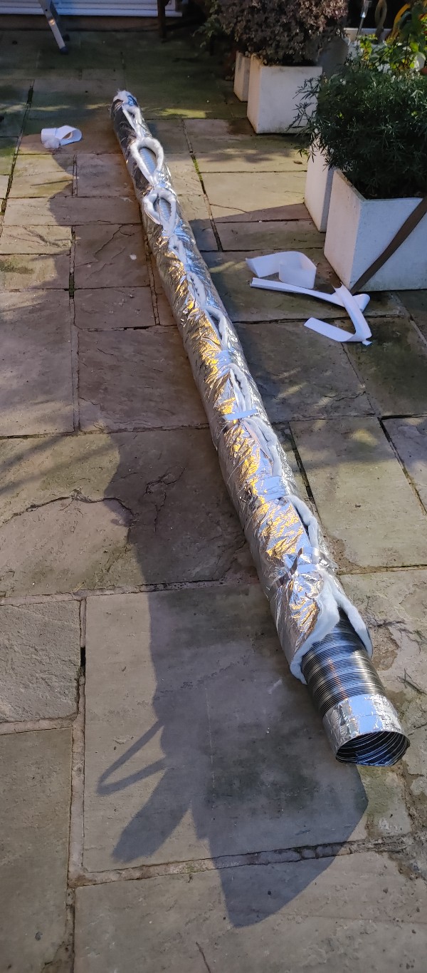

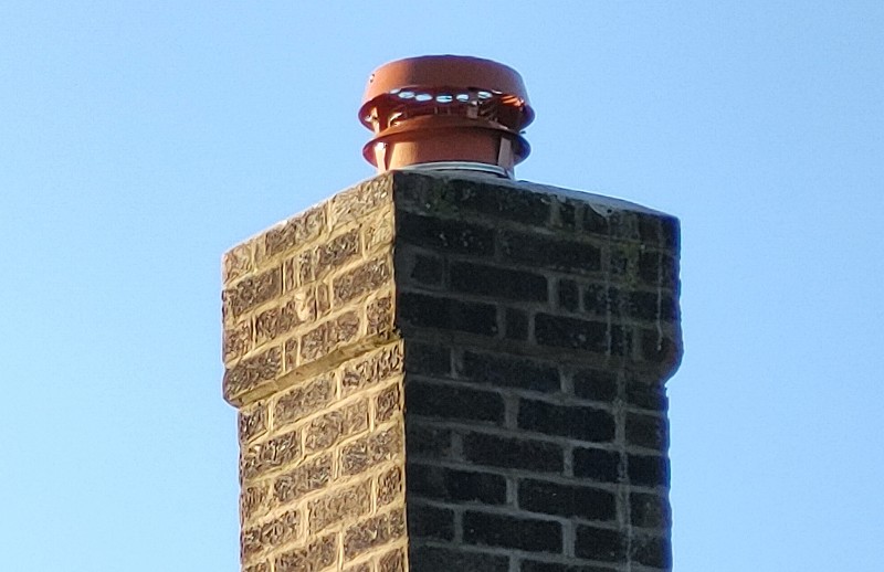

limecc Posted February 19, 2023 Posted February 19, 2023 (edited) Our 5" liner is only 4m long, was not necessary to use insulation wrap but I did in preference top messy vermiculite.  In the few weeks since it was signed off, I've never had a problem with draw and I've two 30° bends. Incidentally gas velocity is higher with a smaller diameter, I imagine a 6" or greater flue would hold a larger plug of cold air when trying to light a fire and be more susceptible to condensation and downdraft.  My main issue is fumes driving down the roof in certain conditions annoying neighbours. I was going to try a spinning cowl but purchased a WindKat instead. Will see how it goes.  P.S. I think it will be hard to burn a smaller fire in a larger stove because you need correct firebox temps to get good efficiency and get the gases away from the roof in cold and still weather. Just my take.  Edited February 19, 2023 by limecc
