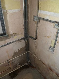

Onoff Posted February 12, 2023 Share Posted February 12, 2023 I have run some 15mm Pex/PB inside 25mm galv electrical conduit. This was in the corner of a wall but that was more for mechanical protection against someone deciding it would be a good spot for a shelf bracket. It'd be a bit moot if someone decides to use a Bosch multi construction bit! Link to comment Share on other sites More sharing options...
