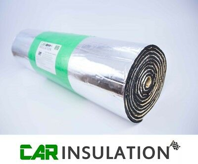

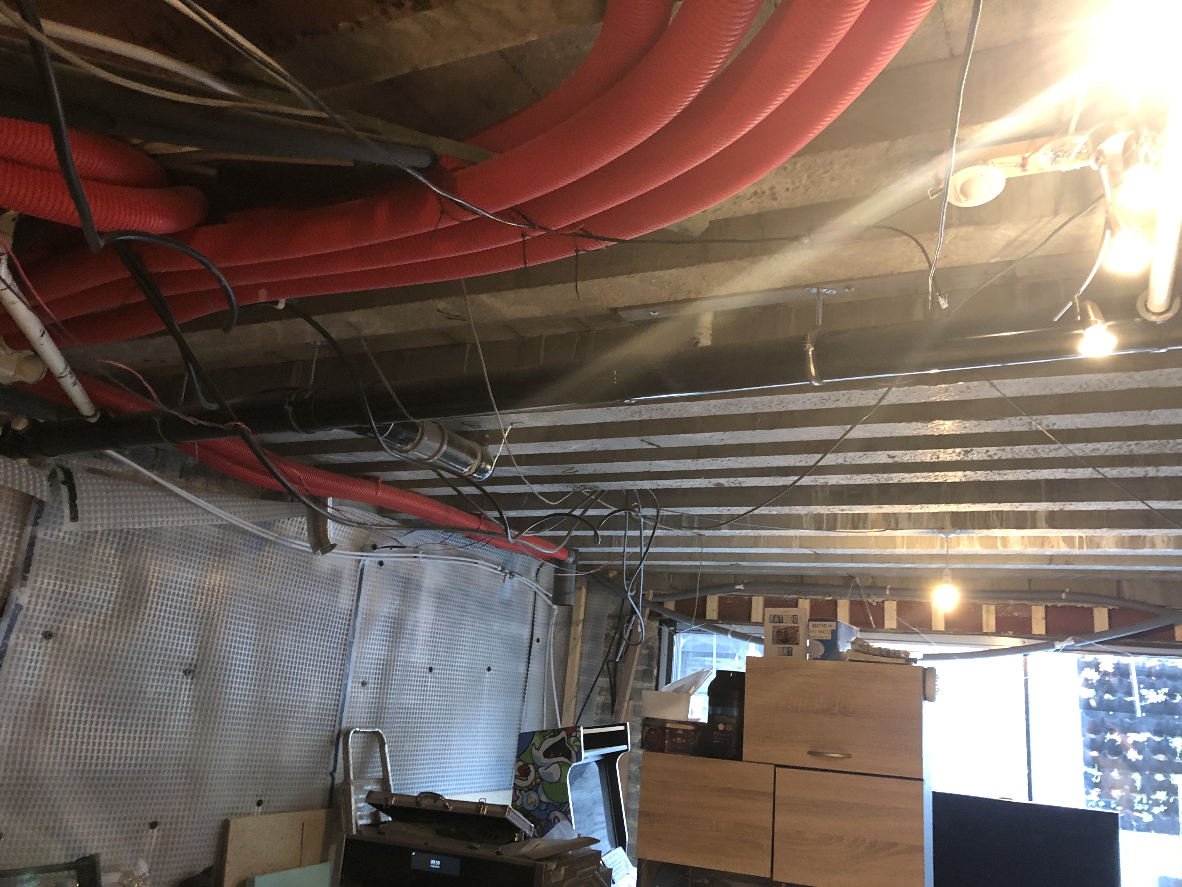

Thorfun Posted February 1, 2023 Share Posted February 1, 2023 @Nickfromwales has previously mentioned using Killmat insulation. here's one such example of a post of his   and was something I was going to look in to for our poo-pipe running across the basement ceiling. 1 Link to comment Share on other sites More sharing options...
Pocster Posted February 1, 2023 Author Share Posted February 1, 2023 (edited) 3 minutes ago, Thorfun said: @Nickfromwales has previously mentioned using Killmat insulation. here's one such example of a post of his   and was something I was going to look in to for our poo-pipe running across the basement ceiling. Yeah that sounds promising. Edited February 1, 2023 by pocster 1 Link to comment Share on other sites More sharing options...

Pocster Posted February 2, 2023 Author Share Posted February 2, 2023 @Thorfun  Spoke to a few companies and decided to go for this:  https://www.soundstop.co.uk/ZTECFT55.php 1 Link to comment Share on other sites More sharing options...
