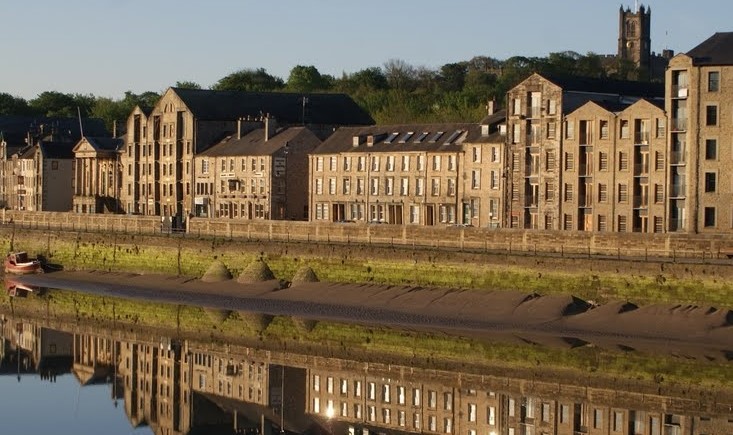

ToughButterCup Posted July 19, 2017 Posted July 19, 2017 @MrsB, in relation to your question: doors. I used to live on quayside in Lancaster, right where the slave trade ships docked. All the shops, pubs and houses along that road have some form of flood defence. Our block of flats had a separate additional flat-bottomed boat shaped GRP 'door' which us residents would put in its seating - a rubber framework on the outside edge of the door. When the threat had passed we just took it off and stored it at the back of the stor room. Never mind what it looks like, it's functionality is the key issue. And while at one level the door was useful, it did nothing to prevent the upswell of water from other sources - especially the drains: even though they had non-return valves (large cast iron one way doors really). You can imagine in a block of flats (sorry sail lofts) how many minds were focused on solving the problem. The best we could come up with was Think of flooding as normal: plan for it Build a high door threshold (but observe Building Regs) Low windows need similarly high thresholds A post flood drainage plan is needed Make sure someone is always on duty looking for flood warnings - all year round For low rooms, make sure all the electrics are high up There were a series of other things which I can't quite remember but I'm sure that somewhere you can get guidance on how to deal with the threat. I seem to remember the Environment Agency distributing fliers about the problem. That was some time ago now. I bet the system is better now than it was then. 1
