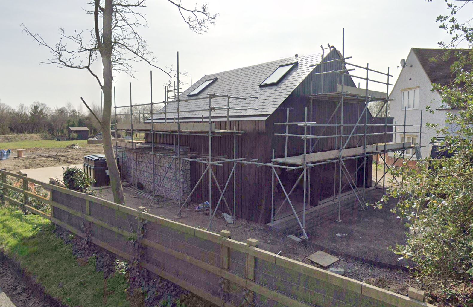

saveasteading Posted January 25, 2023 Posted January 25, 2023 These are all impressions aren't they? Although the first one seems to have some scabby wood cladding so may be real and 'settling in to its rural environment.' 1
SteamyTea Posted January 25, 2023 Posted January 25, 2023 2 minutes ago, saveasteading said: Although the first one seems to have some scabby wood cladding so may be real and 'settling in to its rural environment.' Not when you look at the tree shadow on the scabby cladding, but the sun behind the building. Like most wet dreams, they soon age.

Alan Ambrose Posted January 26, 2023 Author Posted January 26, 2023 >>> Care to expand on the question? I mean - "as none of these buildings have conventional gutters and drainpipes, what kind of arrangements for handling rain do they have?" And is it workable? Actually, there's an outbuilding near me that has an arrangement a bit like this. It does looks good. But, does anyone know what the engineering detail looks like?
