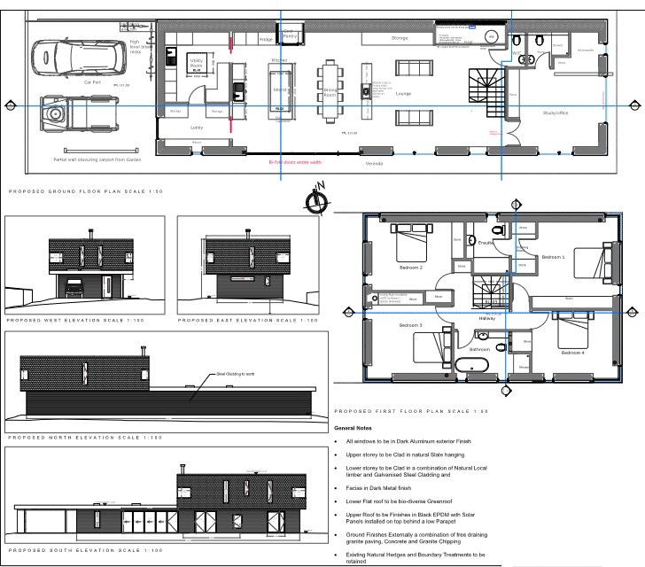

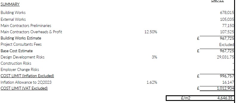

worriedexpat Posted January 25, 2023 Author Posted January 25, 2023 (edited) Hi all, thanks for your thoughts it's appreciated  so to answer a few questions @PeterWYES we did give the architect a budget, then upped it a little based on their indicative price of 2000/m2  I of course am guilty of retail creep, a little extra room here and there... so the final floor space was 218m2 and QS indicates this would cost 4,646/m2 (do the maths.... ouch!!)  The build route was to be a main contractor (as we are a long-haul flight away so really cannot do anything to help!) this was made clear from the beginning  The land is tricky and requires a concrete raft to build on...which is currently estimated to consume a large proportion of the budget. This requirement was known before the architects were commissioned as we already had mining surveys done  Performance is really important to us, not necessarily passivhaus, but close to, as the whole idea is to have something affordable to live in when we leave our overseas jobs (and can't afford to switch on the heating 😉  looking at the plans (and yes this had always been at the back of my mind) I see that the form isn't exactly the most price efficient ... so I would probably prefer to change the shape and size of the building before reducing the spec... But I guess that means going back to planning stage.  All in all I just see a huge amount of money sunk into getting here, and now realizing we can't go ahead with this project as is.  What are my options realistically?  1. go out to tender and hope the architect is right (maybe?!)  2. keep the plans as is but reduce insulation all round/change build materials... can I do this and still retain a well performing home?  3. change the form of the house, choosing the best balance between cost and performance in the build system - and suck up all the costs related to going back to the drawing board. If I do this I don't suppose there is any recompense from the architect? I wouldn't want to work with them on a new iteration unless they re-designed for free...  @ToughButterCupYes, I think being away really hasn't helped.. I was unable to get home for 2.5yrs due to covid restrictions so was never proactive in keeping everything on track  Any recommendations on the way forward would be appreciated!    Edited January 25, 2023 by worriedexpat
PeterW Posted January 25, 2023 Posted January 25, 2023 Your QS is smoking crack  That is the simplest design I’ve seen ..! use an insulated raft (Kore or similar) and you fix a lot of your issues.  nice logical layout with upstairs over service / plant spaces  What are the final finish materials ..? Is that driving the cost ..?

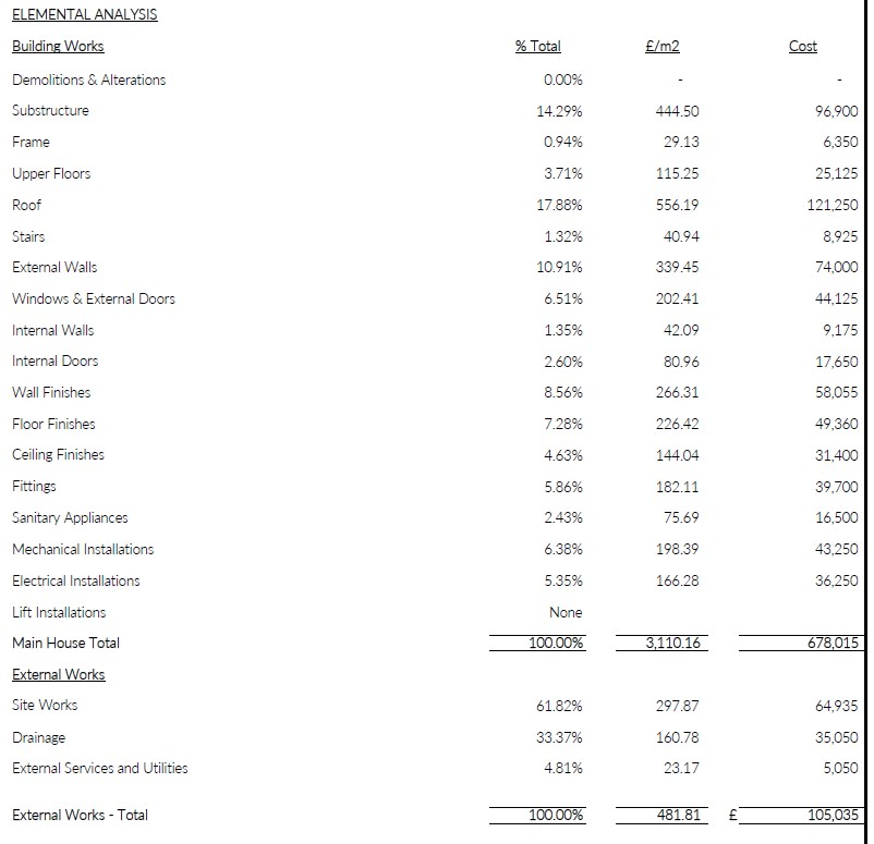

worriedexpat Posted January 25, 2023 Author Posted January 25, 2023 7 hours ago, PeterW said: Your QS is smoking crack  That is the simplest design I’ve seen ..! use an insulated raft (Kore or similar) and you fix a lot of your issues.  nice logical layout with upstairs over service / plant spaces  What are the final finish materials ..? Is that driving the cost ..?  Ok, I really hope so ... he admits hes been cautious on a few things and can reduce some finishes for us... but could he really be that far out? I've included the summary and some breakdown on costings  thanks for the link to Kore - I'll ask them for a quote and see if thats a potential place for savings...  Is a timber building, with lambswool insulation, clad in slate (1st floor) and timber (ground floor). polished reinforced concrete slab for ground floor, engineered hardwood first floor, sedum roof. No fancy kitchen or bathrooms. internal finish quoted for clay plaster. I know there are some things that can be compromised on in finishes.  We want to keep the layout if at all possible, think the key will be to change the build system/spec to something cheaper but what will that be to still perform well?  Â
Kelvin Posted January 25, 2023 Posted January 25, 2023 (edited) That’s mentally expensive.  Our groundsworks, for example, including a 25m retaining wall, large garage foundation, similar sized house, and all drainage is £47k. This is on a slope so needs a bit more levelling and a longish driveway formed.  £17k for internal doors? How many doors are there and what are they made out of? Etc.  You could half this cost I reckon if shopped about a bit without trying too hard. Edited January 25, 2023 by Kelvin
PeterW Posted January 25, 2023 Posted January 25, 2023 Bonkers Numbers !!! How much did you pay him ..?  £43k for mechanical installations ..?? £36k for electrical ..?? You can do those both for less than 20% of that ..!!
ToughButterCup Posted January 25, 2023 Posted January 25, 2023 Something is wrong here. Are you still overseas? Many people think self-builders are made of money. Time to tell it like it is: this is all too expensive to the extent that the p!$$ is being taken.  £4K + per square meter is pure fantasy - nonsense bollocks piss-takery. Many of us are on under £2k per square meter. @nod is on under 1k ish, I'm on just under 2 with my set of ferkups. Most are are roughly in the 1.5, 1.8 region.  Rip it all up, start again. Face to face, sleeves rolled up, and no bloody nonsense.  If you are abroad, get yerself over here for 6 months, and put some stick about: save yersel' £100K.   Â
