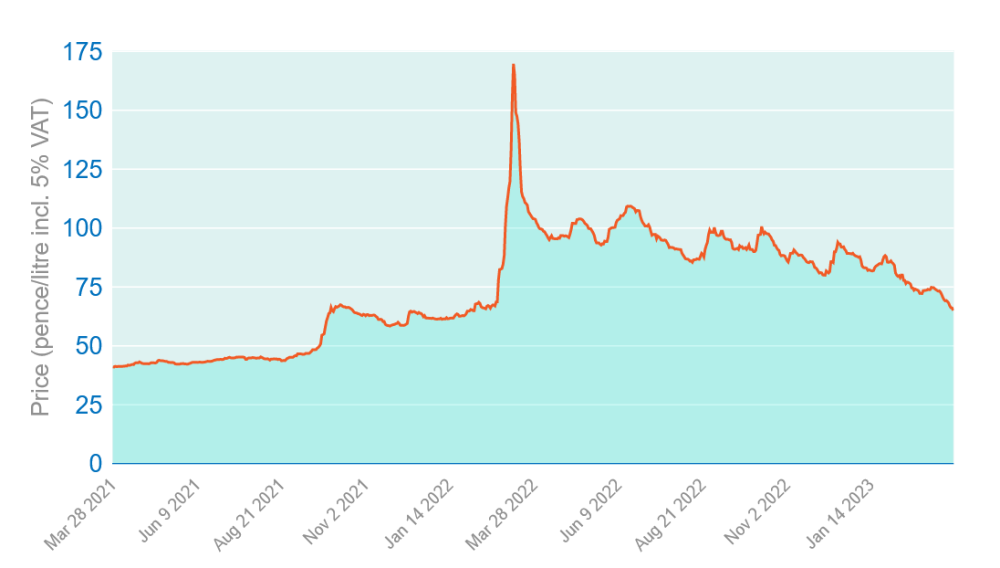

Gone West Posted March 27, 2023 Posted March 27, 2023 On 27/03/2023 at 00:05, Iceverge said: absolute cheapest way to power a house is A2A for space heating Expand Oil in our area has gone from 85.17p/l in January to 68.11p/l today, so a volatile market. At todays price, to match a 90% efficient oil boiler you would need a CoP of over 4 for the A2A HP, so it's close.
Iceverge Posted March 27, 2023 Posted March 27, 2023 (edited) On 27/03/2023 at 02:37, joth said: Just to clarify you're talking combination of capital and running costs based on some assumptions? Expand Yes. An ASHP at very low flow temps have good efficiencies but I don't think as good as an A2A and ESHP combo. Very much correct re the usage patterns. I am assuming a 25 year PV lifespan too. The trouble with heat pumps for water is they start to run out of COP as you approach usable DHW temp, negating much of their benefit. PV + diverter doesn't care and will heat water from 10-20deg the same as 60-70deg. On 27/03/2023 at 07:20, Gone West said: Oil in our area has gone from 85.17p/l in January to 68.11p/l today, so a volatile market. At todays price, to match a 90% efficient oil boiler you would need a CoP of over 4 for the A2A HP, so it's close. Expand Yikes, oil is certainly cheap. I didn't realise it was so much so now. From a carbon point of view I think a new oil boiler at 90% plus efficient isn't the worst way to use fossil fuels. A relatively better use of them than a 30% efficient car. Better still would be tackling some of the heat loss of the building although this isn't always readily achievable. Edited March 27, 2023 by Iceverge

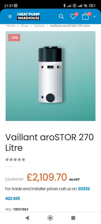

Iceverge Posted March 27, 2023 Posted March 27, 2023 Exhaust source heat pump for DHW. https://www.vaillant.com/home/products/arostor-hot-water-heat-pump-10752.html @Thedreamer has a Joule model. 1
SteamyTea Posted March 27, 2023 Posted March 27, 2023 On 27/03/2023 at 08:21, crispy_wafer said: Please can I ask what is an ESHP? Expand Exhaust air heat pump. It is like a normal air to air heat pump, but extracts the air out of the building to heat water. The problem is, the air in the building has to be heated, so can become very expensive if the heating is electrical resistance. Some on here have used them to good effect though, especially if it is integrated with the ventilation system and DHW usage is relatively low, in proportion to the building volume. DHW usage is really a function of occupancy, more people, more hot water used. 1
billt Posted March 27, 2023 Posted March 27, 2023 On 27/03/2023 at 08:27, SteamyTea said: Exhaust air heat pump. It is like a normal air to air heat pump, but extracts the air out of the building to heat water. The problem is, the air in the building has to be heated, so can become very expensive if the heating is electrical resistance. Some on here have used them to good effect though, especially if it is integrated with the ventilation system and DHW usage is relatively low, in proportion to the building volume. Expand I think that you'ld normally have them ducted so the air comes from outside the building and returns to outside the building.
SteamyTea Posted March 27, 2023 Posted March 27, 2023 On 27/03/2023 at 08:50, billt said: I think that you'ld normally have them ducted so the air comes from outside the building and returns to outside the building. Expand Yes. With a bit of imagination they can be effective. If they cost the same as ten years electricity, about $1640 at my current inflated rate, I would consider one. "Rich man sweating in a sauna bath, poor boy scrubbing in a tub" "Me, I stay gritty up to my ears, sitting in a puddle of mud"
crispy_wafer Posted March 27, 2023 Posted March 27, 2023 So... if you add this to an ASHP A2W system rather than a normal cylinder, then you don't need to interrupt the space heating requirement for DHW generation. Each case is different I guess, but, as a rule is it better to separate the space heating system from the DHW system, or have them combined? At < 2k for a 270l arostor they don't seem beyond the realms of affordability either.
SteamyTea Posted March 27, 2023 Posted March 27, 2023 On 27/03/2023 at 09:08, crispy_wafer said: as a rule is it better to separate the space heating system from the DHW system, or have them combined Expand My feeling is separate is better, Space Heating is at different times, at a different temperature and for a different purpose than DWH heating. Bit like buying a RangeRover and hope that it can pull a plough occationally.
JohnMo Posted March 27, 2023 Posted March 27, 2023 On 27/03/2023 at 07:20, Gone West said: 90% efficient oil boiler Expand Could you run it in the same low temp mode as a heat pump and over 100% efficiency through condensing? Same as a gas boiler?
ReedRichards Posted March 27, 2023 Posted March 27, 2023 What you can't do with most oil boilers is get them to modulate; they're either full-on or off.
Gone West Posted March 27, 2023 Posted March 27, 2023 On 27/03/2023 at 11:21, JohnMo said: Could you run it in the same low temp mode as a heat pump and over 100% efficiency through condensing? Same as a gas boiler? Expand No because IIRC Grant recommend a minimum return temperature of 50C which I think is to prevent corrosion.
SimonD Posted March 27, 2023 Posted March 27, 2023 On 27/03/2023 at 15:35, Gone West said: No because IIRC Grant recommend a minimum return temperature of 50C which I think is to prevent corrosion. Expand It's 40C for ufh on the Vortex exactly as you say to prevent corrosion of the water jacket. For normal rads they recommend 70/50.
