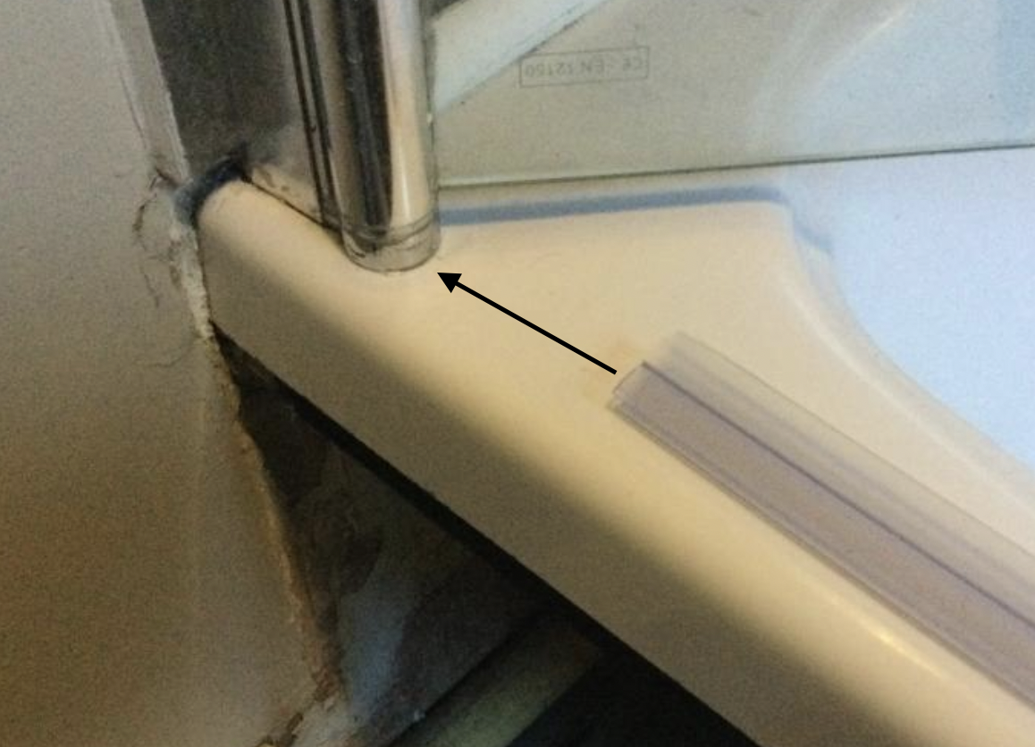

zoothorn Posted January 18, 2023 Share Posted January 18, 2023 Hi chaps, I have a small persistent problem, causing bigger longterm woes & damage. The shower screen seal area, particularly the hinge corner. I've got a new clear 16mm seal strip, with two fins one long one/ other shorter. Firstly- which way round? Long fin bath side, or short fin bath side? (Www info suggests both ways correct!). Secondly- I get an incredibly annoying leak at this area. It's help to ruin the lino, the bottom edge of the bath side section, & creates water ingress to the hardboard underneath the lino. It happens 50% of time I have a shower (leaving me perplexed), & about a good litre+ of water on my lino floor after a shower when it happens. Trouble is I just cannot establish -precisely- where the problem lies. So I can never resolve it. I lay down 2 big sponges on the inside of bath at this corner when I use the shower.. but the leak still happens even so. Driven me absolutely mad for 5 years this. Thanks, Zoot. Link to comment Share on other sites More sharing options...

BotusBuild Posted January 18, 2023 Share Posted January 18, 2023 I presume the clear plastic thing on the top of the bath edge is the new seal? and the perspex panel does meet it in such a way that the water runs off the perspex, onto the seal and then towards the bath itself? If so, then it needs putting right up against the bottom of the hinge (as per the added arrow), so that the above described flow of water happens all the way - at the moment it seems you have an approx 2" gap where the water can run off the perspex and then both ways - into the bath, or over the side and onto the floor!! When you move the seal to butt up against the hinge I would put a little bit of sealant in between the seal and the hinge (belt and braces) Link to comment Share on other sites More sharing options...
Gone West Posted January 18, 2023 Share Posted January 18, 2023 3 hours ago, zoothorn said: Firstly- which way round? I had a similar hinged shower screen on my bath at my last place. IIRC when I fitted it I put the longer fin bath side. 3 hours ago, zoothorn said: I get an incredibly annoying leak at this area. A couple of questions, how is the whole length of the hinge frame, sealed to the wall and how is the bottom of the hinge frame, sealed to the bath. Link to comment Share on other sites More sharing options...

zoothorn Posted January 18, 2023 Author Share Posted January 18, 2023 @BotusBuild Hi there, thanks for the reply- don't think I've had one from yourself before/ appreciated. Sorry my photo makes it seem like I'm more inept than I am. The new seal here is just resting, waiting to be fitted to the glass above. I need to establish which way round this slips onto it, first Q. It seems it's a 50/50 opinion which way round. I just cant think it logical to have the shorter fin outside, as then it serves no function-? I've cut it as best I can perfectly 90* so it butts up against the door hinge, with as minimal a gap as poss... but still there's a tiny gap. Afaict it's a flawed design as the force of door opening bends the big fin a bit, & over a short time this bend is stuck firm, meaning a gap develops at this join (you can barely detect without contorting yourself & to look with a magnifying glass). I'm not sure if ProDave was suggesting an alternate seal strip thing to mine-? Bloody thing Im sick of it, but seems there's no alternative door/ all will have the same inherrant issue surely. Thanks, zoot Link to comment Share on other sites More sharing options...

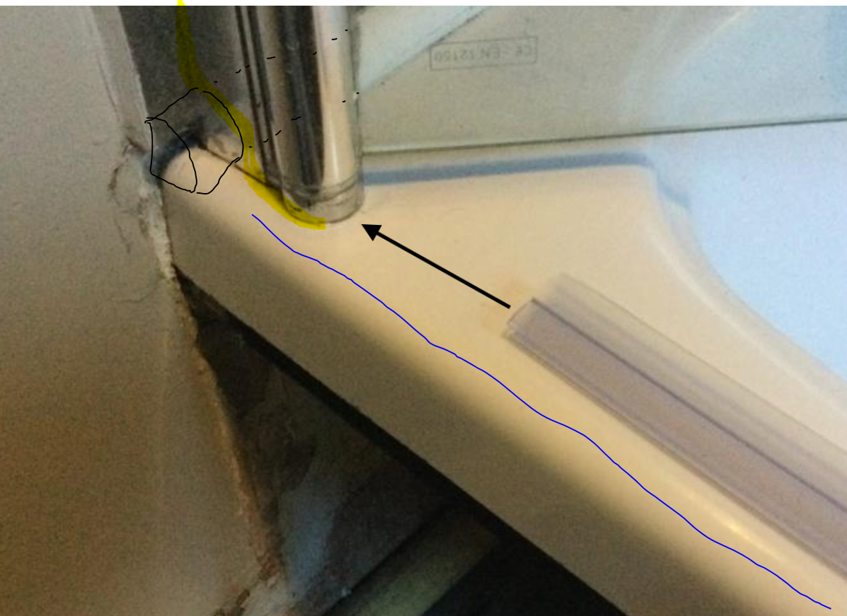

Iceverge Posted January 18, 2023 Share Posted January 18, 2023 These seals are indeed rubbish. I would remove the screen. Make sure the bath to wall seal was continuous right out to the edge of the bath. It may require cutting an arc out of the shower door as shown ( notice my hi-tech 3d renderings!) or doing some inventive siliconing. Then running a band of clear silicone where the yellow is at the outside of the screen only ( ask me how I found this out! Then attach some kind of dam where the blue line is. Maybe a strip of PVC? It may prevent the screen from moving outboard but should help any drips work their way back into the shower. Alternatively those curved shower curtains are actually not too bad. They don't tend to get all damp and clingy like that uninvited affection we've all had with shower curtains of yore. Link to comment Share on other sites More sharing options...

zoothorn Posted January 18, 2023 Author Share Posted January 18, 2023 Hi @Iceverge not sure if I've had a reply from you before too.. grateful for the ideas. I had actually put a big bead of silicone exactly where your 3D block is, & your yellow line/ here I have removed it to redo: but it was firm before, no failings here afaict. So it's he hinge, & forward of this/ the seal strip, which I think the leak happens. Your dam idea is good, but the water might only run along, & exit half way down the bath onto the floor tho. The curtain: you see the bath taps area will still get wet.. resulting in water @ this achilles heel hinge. Hmm. Not easy this. Thanks chaps. Link to comment Share on other sites More sharing options...
Gone West Posted January 19, 2023 Share Posted January 19, 2023 12 hours ago, zoothorn said: It has a vertical outside bead of silicone only That is good, but water can get behind the vertical hinge frame and if the bath isn't well sealed against the wall, water can get down behind the end of the bath. Although all these gaps are very small they will allow a significant amount of water to get onto the floor over a peiod of time. Link to comment Share on other sites More sharing options...
