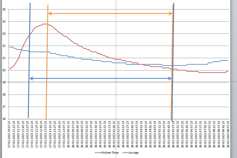

Blooda Posted January 18, 2023 Share Posted January 18, 2023 (edited) Not really looked at this before, but just downloaded the two Elitech loggers, one in the lounge one in the Kitchen Diner. And besides whats it telling me there seems to be another load of questions. House = self build finished last year, insulation better than building regs air tightness around 3.5 - not as good as we wanted but COVID prevented constant survalence and monitoring. ASHP and UFH. Lounge - We had the Log Burner Going, Kitchen Diner - Residual heat over 21 from Cooking etc. Blue Arrow = heating off Set Back time @ 18 degree Orange Arrow - 11pm to 6pm Trial time Outside temp around -2 Kitchen Diner lounge 17-01-2023 23:02:23 21.5 23.8 18-01-2023 06:02:23 20.4 20.1 Drop in 7 Hours 1.1 3.7 Drop Per Hour 0.157 0.529 Edited January 18, 2023 by Blooda Link to comment Share on other sites More sharing options...

Radian Posted January 19, 2023 Share Posted January 19, 2023 9 hours ago, Blooda said: Not really looked at this before, but just downloaded the two Elitech loggers, one in the lounge one in the Kitchen Diner. And besides whats it telling me there seems to be another load of questions. Like why the losses from the lounge are significantly more than from the kitchen? Link to comment Share on other sites More sharing options...

Blooda Posted January 19, 2023 Share Posted January 19, 2023 (edited) 56 minutes ago, Radian said: Like why the losses from the lounge are significantly more than from the kitchen? I am thinking that it might be the big black, heat absorbing lump of iron, with a hole up to the roof. 🔥 Even though the stove is air fed from outside, the air baffles will probably not fully shut for safety reasons, when it is not on. Last night no fire:- The peak in the graph with the star is when I moved them to down load them. Lounge = double heat loss. 53 minutes ago, SteamyTea said: Yes. Why it is such fun. The trick is to ask a question that can be answered, and tested. Back to first principles. Check the data source. The two Loggers are now side by side, and will spend 24 hours in the Kitchen and then 24hours in the lounge to see if they are reading the same. Edited January 19, 2023 by Blooda Link to comment Share on other sites More sharing options...
Radian Posted January 19, 2023 Share Posted January 19, 2023 4 hours ago, Blooda said: Lounge = double heat loss. Not quite. Recall the exponential nature of cooling. Both kitchen and lounge need to be at the same starting temperature WRT outdoor temperature. Notice how your lounge was even hotter to begin with in your first test and the loss you recorded was higher. Link to comment Share on other sites More sharing options...
SteamyTea Posted January 19, 2023 Share Posted January 19, 2023 3 minutes ago, Radian said: Not quite. Recall the exponential nature of cooling. Both kitchen and lounge need to be at the same starting temperature WRT outdoor temperature. Notice how your lounge was even hotter to begin with in your first test and the loss you recorded was higher. May be loosing twice the amount of energy though. Temperature is not heat (the old word for energy). But yes, it is really only worth comparing within the same temperature ranges, and then the energy losses will be the same, one the differences in form have to accounted for. A wood burner will (expletive deleted) it up though, half the time it is so hot the energy is going up the chimney, the other half of the time, it is cold, and draws air back down the chimney. Link to comment Share on other sites More sharing options...
SteamyTea Posted January 19, 2023 Share Posted January 19, 2023 (edited) 4 hours ago, Blooda said: The peak in the graph with the star is when I moved them to down load them. They show lovely cooling curves. May just be an offset. You can use anomalies. Take the mean and subtracted the variables. Was the kitchen extractor left on. Edited January 19, 2023 by SteamyTea Link to comment Share on other sites More sharing options...
Blooda Posted January 19, 2023 Share Posted January 19, 2023 1 hour ago, SteamyTea said: They show lovely cooling curves. May just be an offset. You can use anomalies. Take the mean and subtracted the variables. Was the kitchen extractor left on. Umm . We have MVHR, it drops down at 10pm til 7.30 to around 20%. And thinking about it now the logger could have been placed to near one of the vents. A lot to start to look at. and maybe need some more logging points. What does anyone else use for logging temps ? I currently have a couple of these:- USB Temperature Data Logger, USB Temperature Monitor Manufacturer (elitechlog.com) can't read them remotely and they warm up when I plug them into the laptop. Link to comment Share on other sites More sharing options...
