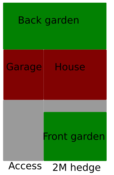

Nick Thomas Posted January 15, 2023 Author Posted January 15, 2023 (edited) 37 minutes ago, PeterW said: you may have to work out how to take a 17 tonne load to make it worthwhile Starting to become convinced this is the issue with pricing. It would be amazing to be able to get a loose load in, but I just don't think it'll work on the site. There's no access to the back at all, and I don't think I could dump into the front garden either. Layout is roughly: Not to scale, obvs. As far as I can see, the only option is to pop it onto the concrete surface in front of the garage (you can park 1½ cars on it, for an idea of scale). A pile of loose anything would spill everywhere and apply pressure to the rickety wall shared with the left-side neighbour, which makes me nervous. I can't see a big truck being able to come in at an angle to dump it onto the garden bit :/, not least because there's a good drop down to the green, but it's also narrow and awkward even if it were level.. However it comes, I'm resigned to barrowing the 15 tonnes required for the back garden through the garage. It'll just be me, so probably a multi-day effort. That means whatever I buy will be sat wherever it gets put for a while as I nibble away at it. 26 minutes ago, Kelvin said: Get a gardener to come in to keep on top of the worst of it. Definitely not :D. Would work for some, I guess. Edited January 15, 2023 by Nick Thomas more detail on access
PeterW Posted January 15, 2023 Posted January 15, 2023 How wide is the access ..? Would need 2.9m for most tippers to be comfortable
Nick Thomas Posted January 15, 2023 Author Posted January 15, 2023 7 minutes ago, PeterW said: How wide is the access ..? 2.5M, or thereabouts. We've not had a discussion about removing the hedge. That could be interesting, but not sure it's worth it to save ~1K on this specific thing. It'd need to be replaced with an antisocial fence if it did go down.

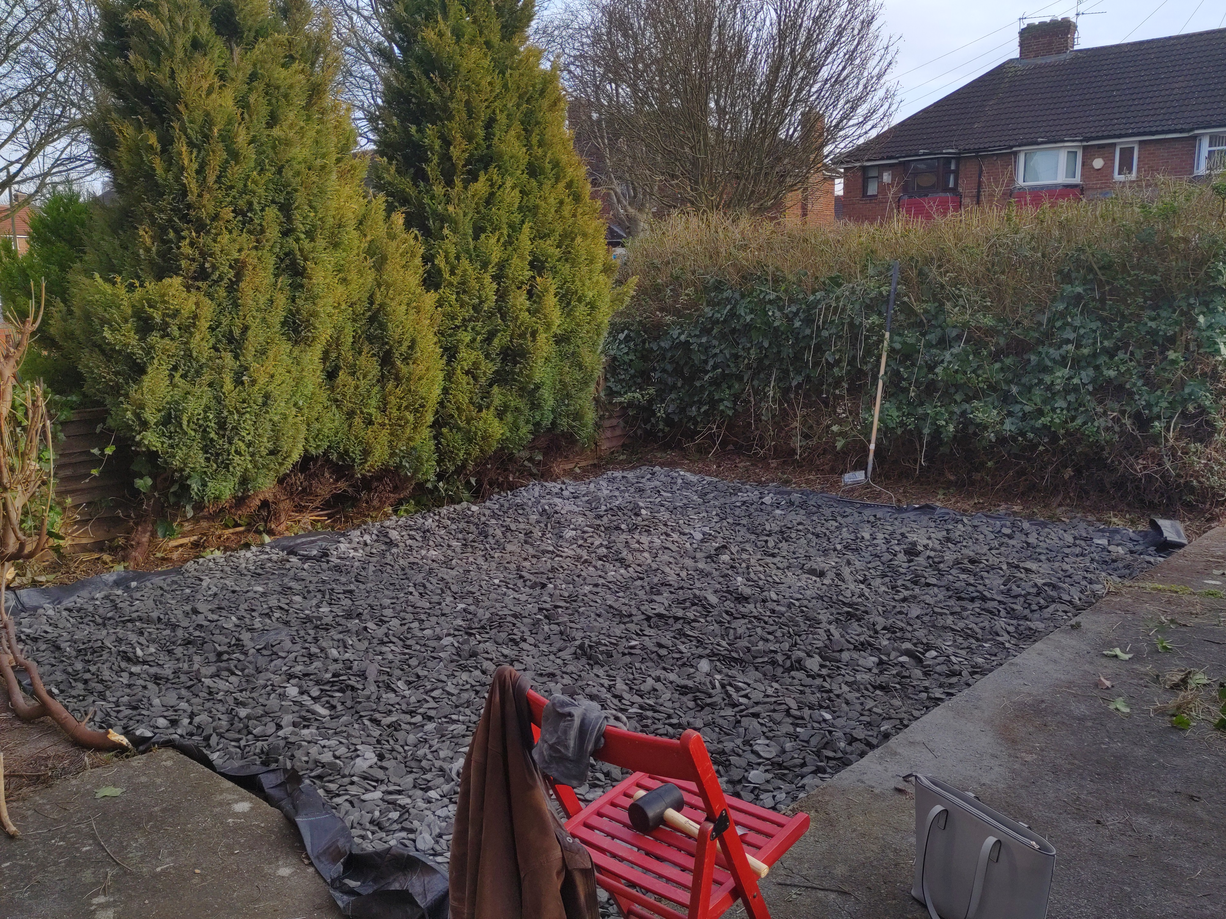

Nick Thomas Posted February 15, 2023 Author Posted February 15, 2023 Turns out three tonnes of slate is really heavy. Who knew ^^. We got some way toward done, but the slate is very unevenly distributed. It wasn't until bag three that we hit on the method of filling buckets from the bulk bag, and emptying them on the far side. Conceptually, this was a battle against friction, and pushing the chips along the ground was not a great way to minimise that. Back again at the weekend to sort out the edges and try to level it out some more; then give the hedge another severe cutback. Half hoping it dies, honestly.

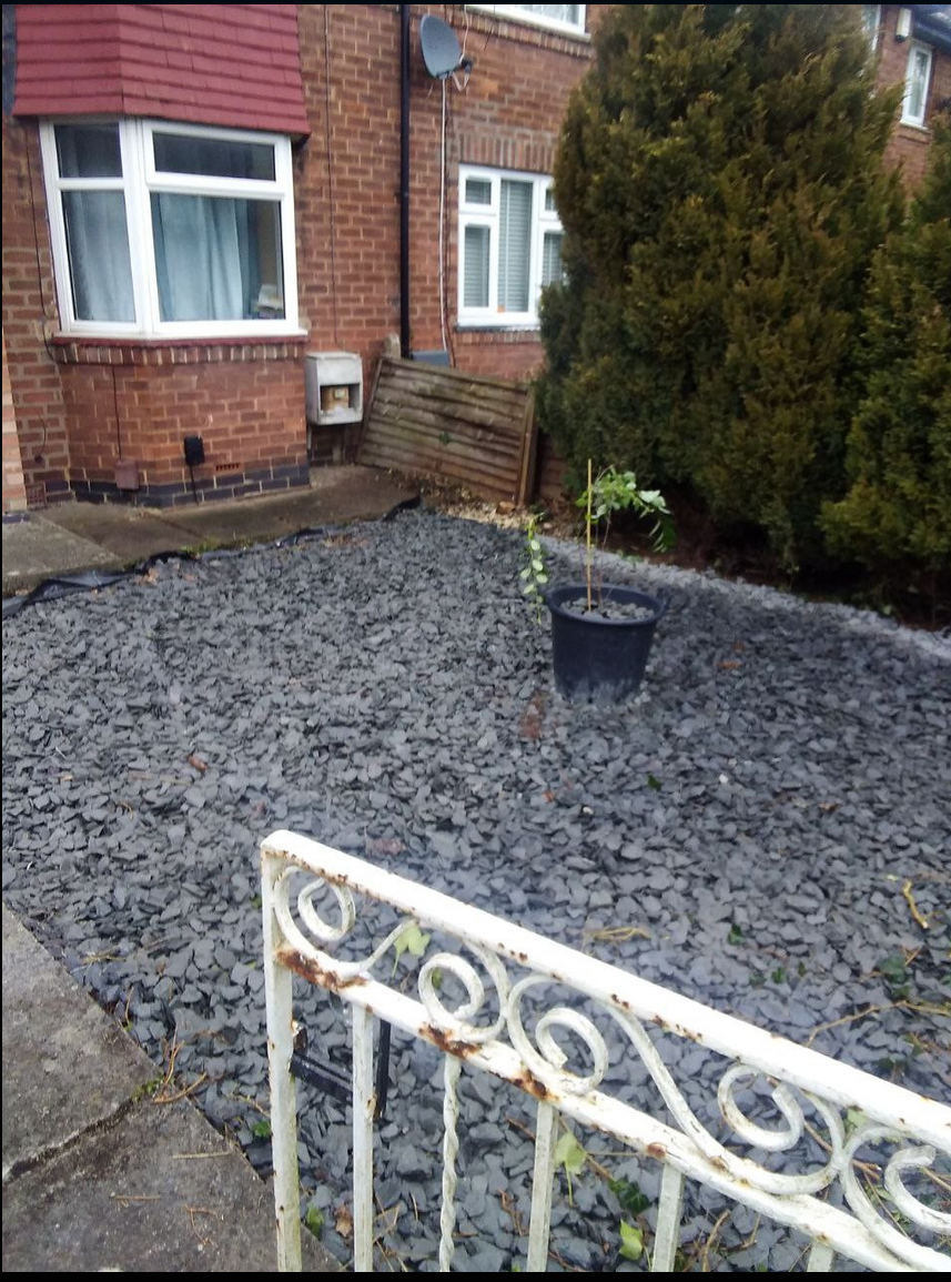

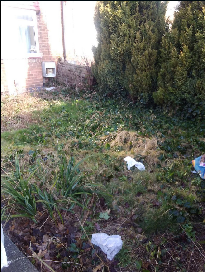

Nick Thomas Posted March 12, 2023 Author Posted March 12, 2023 (edited) Fortunately, this is done now 😅 A bit of a before/after: There was a lot of ivy hiding in that grass. Edited March 12, 2023 by Nick Thomas 1
