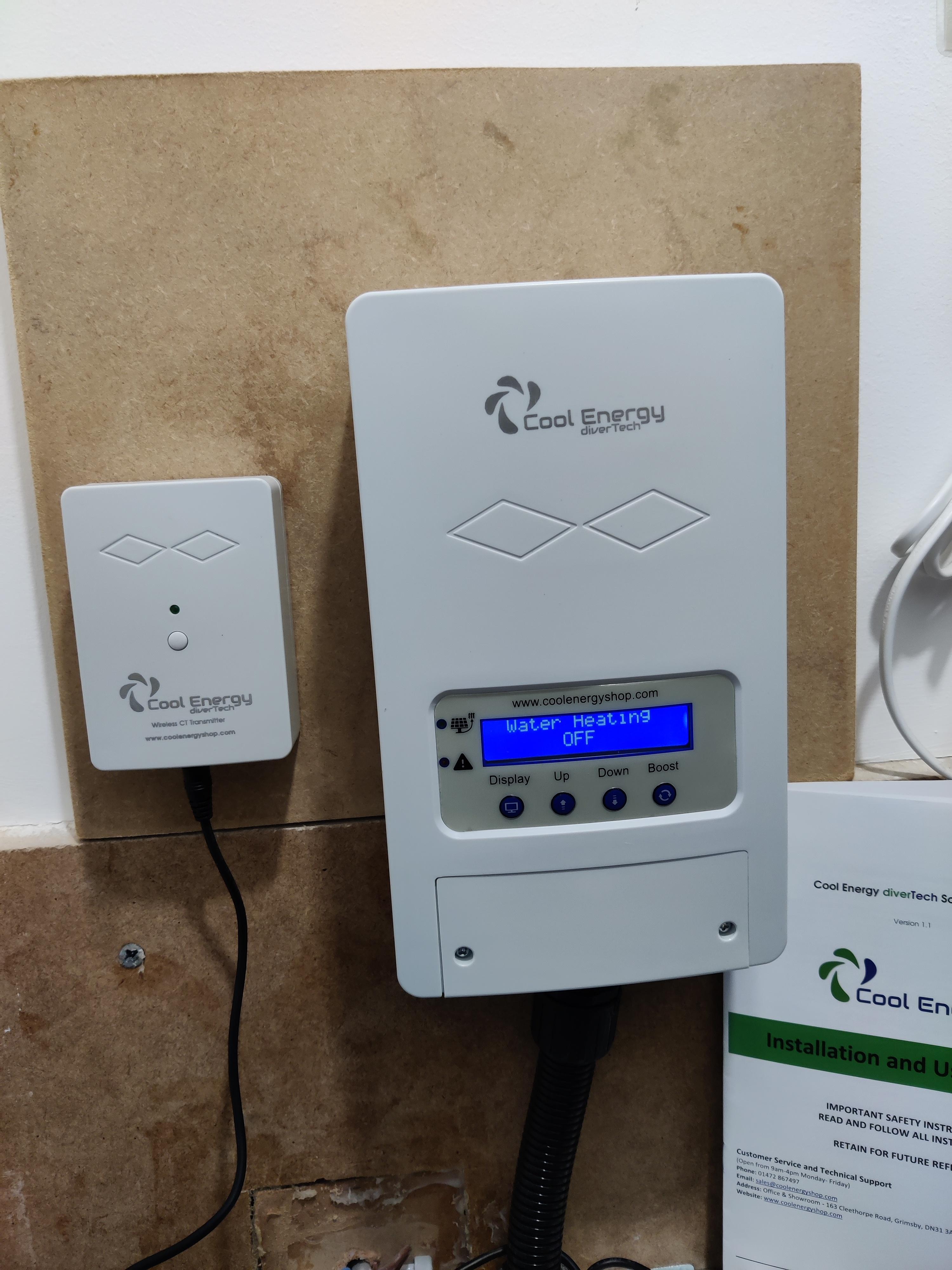

JohnMo Posted May 7, 2023 Share Posted May 7, 2023 Had a similar issue with mine sometimes working, other time lights flashing randomly or going into heat protection mode at 8am, when next to nothing being generated by PV. So just bought and installed a Cool Energy PV diverter. It actually tells you what's going, how much energy is going to immersion at that point in time and over the day etc. You can also set immersion boost times if you need to. It also has an internal fan to keep it cool. Only downside is it has a fan and it a little noisy. Link to comment Share on other sites More sharing options...
dpmiller Posted May 7, 2023 Share Posted May 7, 2023 2 hours ago, JohnMo said: Only downside is it has a fan and it a little noisy. Any chance of an audio clip of the fan sometime please and pics of same? We've an iBoost and the tiny fan in it is a. noisy and b. only barely copes with the heat. The CE unit looks like a virtual clone of the iBoost except for the case being bigger so I wonder if they've improved the cooling Link to comment Share on other sites More sharing options...
JohnMo Posted May 10, 2023 Share Posted May 10, 2023 On 07/05/2023 at 18:11, dpmiller said: Any chance of an audio clip of the fan sometime please and pics of same? We've an iBoost and the tiny fan in it is a. noisy and b. only barely copes with the heat. The CE unit looks like a virtual clone of the iBoost except for the case being bigger so I wonder if they've improved the cooling Sorry no vid, not much sun here for the last few days, so diverter isn't having to work very hard. Once you go over a couple kW the fan kicks in Photo attached Link to comment Share on other sites More sharing options...
dpmiller Posted May 10, 2023 Share Posted May 10, 2023 22 minutes ago, JohnMo said: Once you go over a couple kW the fan kicks in that's interesting. As the iBoost's tiny fan runs during all diversion they've definitely done something. Mahoosive heatsink maybe... Link to comment Share on other sites More sharing options...
Radian Posted May 10, 2023 Share Posted May 10, 2023 2 hours ago, dpmiller said: Mahoosive heatsink maybe... 😉 Wot? Like this... (People laughed at how big a heatsink I used but it basically just runs at ambient - which is hot enough already in an airing cupboard) Link to comment Share on other sites More sharing options...
