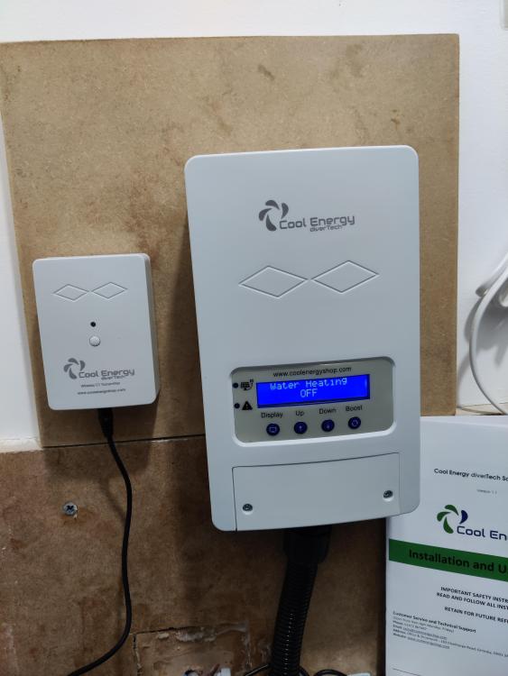

February 12, 20242 yr Best thing I ever did was to through my Solic 200 in to the bin and get Cool Energy diverter. It has timers so you can time boosts if you want, can control two immersions if that's what you have and also tells you what its doing and has done in the past.

February 12, 20242 yr 3 hours ago, JohnMo said: Best thing I ever did was to through my Solic 200 in to the bin and get Cool Energy diverter. It has timers so you can time boosts if you want, can control two immersions if that's what you have and also tells you what its doing and has done in the past. But that’s another £300+ which will need to be spent. Then I have a few years before I break even. I’m already there with the four year old Solic - which has been brilliant to be fair.
