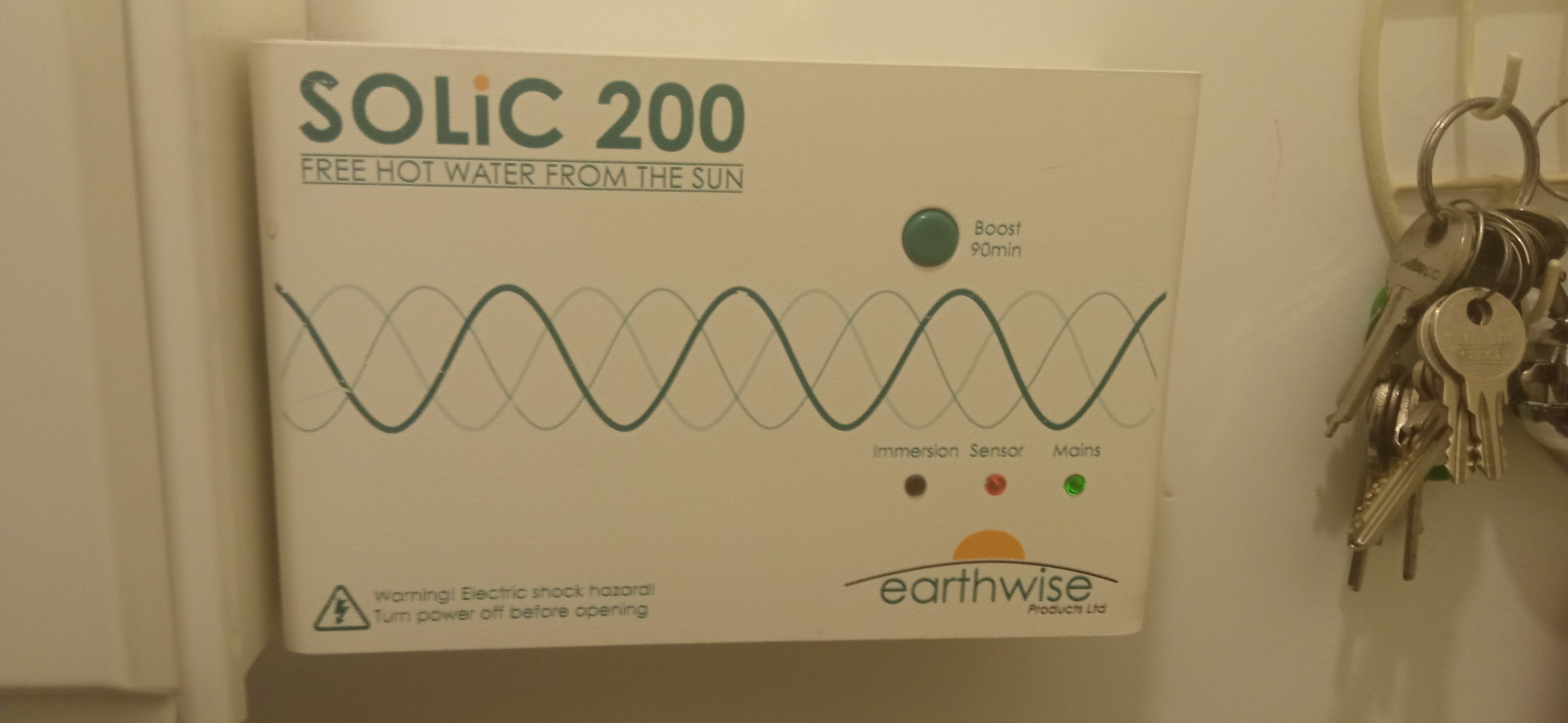

canalsiderenovation Posted January 12, 2023 Share Posted January 12, 2023 It's worked fine for 12 months but today has lots of lights. I've followed the instructions in the manual as below. Ensure the water in the immersion tank requires heating. Ensure house is drawing at least 200W power. Ensure that the immersion electrical circuit is on Turn off the solar inverter and turn on immersion circuit breaker Allow 20 seconds for calibration: - The Mains light should be green and Sensor light should be red. Everything is fine until the point where it says. Turn the solar invertor on and wait three minutes. This is when I the get the flashing lights when I turn the invertor on! The cycle on the video keeps repeating. Any ideas? I've messaged Earthwise but they are off until next week! VID_20230112_124838.mp4 Link to comment Share on other sites More sharing options...

Radian Posted January 12, 2023 Share Posted January 12, 2023 Hmm, from this manual Lights table Mains Light Green Power is on Red The unit is in standby mode. Check troubleshooting suggestions. Sensor light Green Surplus power is available Red The house is drawing grid power Flashing red/green ALL available surplus power is being offered to the immersion heater circuit Immersion light Green Power is being offered to the immersion Off No power is being offered to the (?) Flashing red Boost function is operating No mention of amber anywhere. But that's what it seems to show at times in your video? Link to comment Share on other sites More sharing options...
canalsiderenovation Posted January 12, 2023 Author Share Posted January 12, 2023 1 hour ago, Radian said: Hmm, from this manual Lights table Mains Light Green Power is on Red The unit is in standby mode. Check troubleshooting suggestions. Sensor light Green Surplus power is available Red The house is drawing grid power Flashing red/green ALL available surplus power is being offered to the immersion heater circuit Immersion light Green Power is being offered to the immersion Off No power is being offered to the (?) Flashing red Boost function is operating No mention of amber anywhere. But that's what it seems to show at times in your video? Yes, it seems we have amber lights although it could be a mixture of red and green! Strangely now no solar it is back to 'normal' with the mains light green and sensor red and immersion off. Whatever is wrong, it's only happening when the solar is on! Link to comment Share on other sites More sharing options...

canalsiderenovation Posted January 12, 2023 Author Share Posted January 12, 2023 1 hour ago, ProDave said: What does it no now it's getting dark and no PV generation? It's in it's normal state as pic below. When it was sunny it had the mixture of all lights as per the video. When I tried to recalibrate it (when we had solar), and turned everything off at fuse, it was fine until I turned the solar inverter fuse on. Link to comment Share on other sites More sharing options...
Radian Posted January 12, 2023 Share Posted January 12, 2023 3 hours ago, canalsiderenovation said: Yes, it seems we have amber lights although it could be a mixture of red and green! That's all it can be, as those LED's have just red and green diodes. They're either both on together or rapidly switching from one to the other. Sometimes the LED can only light one colour at a time (inverse parallel diodes) but from this photo of the Solic200 PCB, I can see they're three-terminal LEDs so can indeed both be on at the same time. Seems like a fault. (Like @ProDave said 😃) Link to comment Share on other sites More sharing options...
canalsiderenovation Posted January 12, 2023 Author Share Posted January 12, 2023 1 hour ago, Radian said: That's all it can be, as those LED's have just red and green diodes. They're either both on together or rapidly switching from one to the other. Sometimes the LED can only light one colour at a time (inverse parallel diodes) but from this photo of the Solic200 PCB, I can see they're three-terminal LEDs so can indeed both be on at the same time. Seems like a fault. (Like @ProDave said 😃) Thanks I think it most certainly is a fault as none of the troubleshooting on Earthwise website or options to rectify it are working and the light errors aren't anything consistent either. The invertor is working as I checked this throughout the day and we were getting solar but obviously any excess isn't being diverted at the moment to the tank (granted there won't be much anyway as we would normally use most we generate at the moment and the forecast for the next few days is miserable). I've messaged Segen who the unit was purchased from and Earthwise too, as I'm unsure who will honour the warranty. Earthwise aren't back in the office til Monday so nothing can be done at the moment. Link to comment Share on other sites More sharing options...

canalsiderenovation Posted January 17, 2023 Author Share Posted January 17, 2023 Finally had a response. Unit has failed!! They do offer a 10 year warranty but this seems to only be if it was registered which I'm sure I did as I had many emails and telephone conversations when it was being fitted and general instruction on setting it up. I've sent a pic of the serial number and now awaiting them coming back to me - likely to try and get out of the warranty! Link to comment Share on other sites More sharing options...
canalsiderenovation Posted January 17, 2023 Author Share Posted January 17, 2023 What the hell! I am sorry to hear that there are problems with your SOLiC and re-commissioning the unit has not sorted it out, they are normally very reliable and we have tens of thousands installed. If there is ever a problem with the unit a simple re-commissioning works in the majority of cases. I have checked via your Name, address and Serial number and unfortunately it is no longer under warranty as we have not record of it ever being registered with us. As your unit has not stayed restarted there are two either or alternative options I can offer you they are: Return the unit to and we will then test, repair and return it to you for £100 including VAT and return delivery. You will need to arrange uninstalling and then reinstallation of the unit in this case and we need up to 4 weeks to test, repair and return the unit to you. Alternatively you can buy a new unit without a sensor, as you can use your existing sensor, for £125 including the VAT and delivery. The new unit price is normally £215 but I have discounted it as it may be a more cost effective option as the new unit could simply be switched over meaning only one visit from an electrician as opposed to 2 for visits for a repair. The new unit will give you a new 10-year RTB warranty, the latest firmware and hardware, which you should register with us. I do apologise for an inconvenience caused and would like to get it sorted out for you as easily and quickly as possible. Please let us know what you would like to do? Best regards Link to comment Share on other sites More sharing options...
