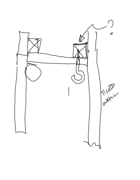

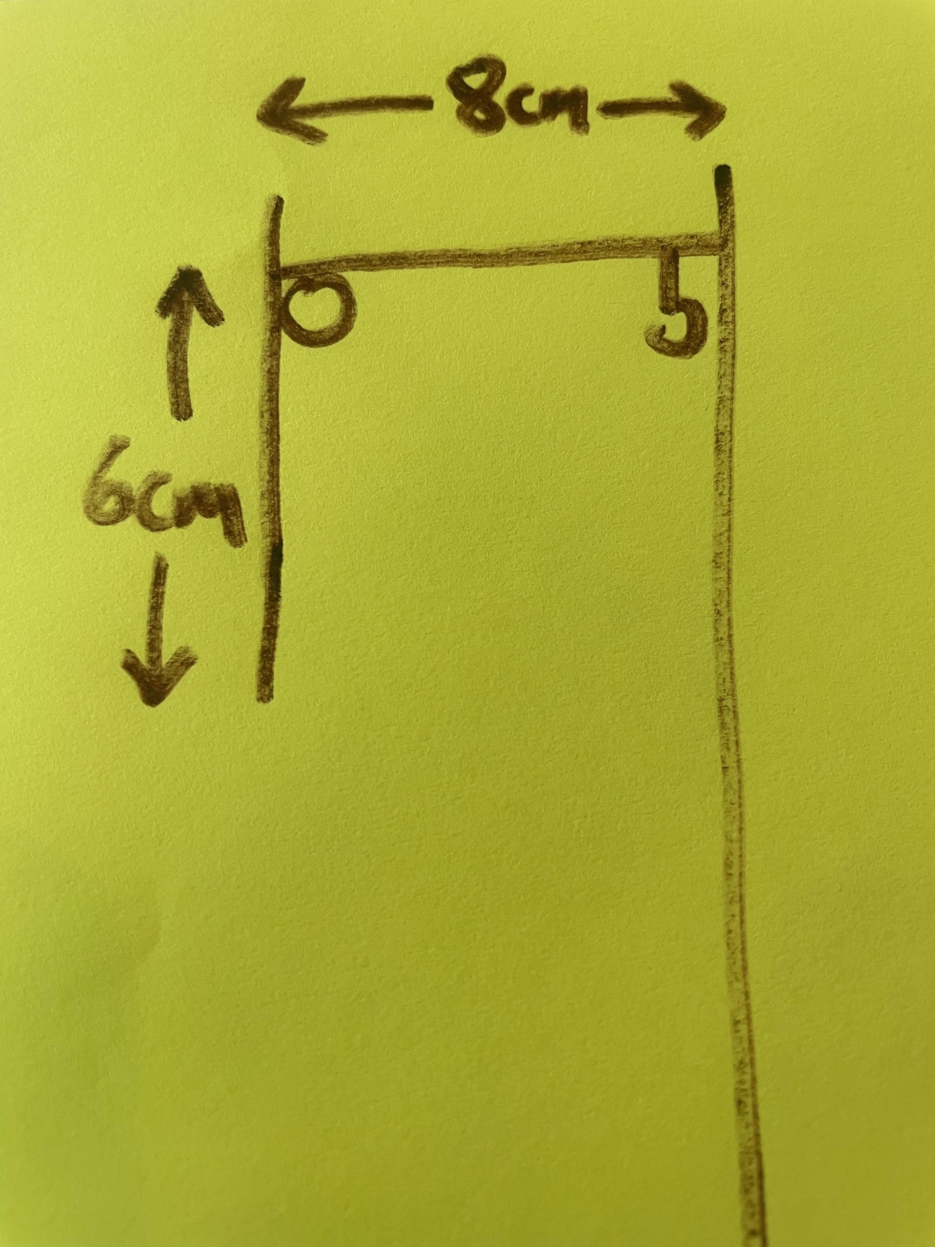

Adsibob Posted January 8, 2023 Author Share Posted January 8, 2023 Thanks everyone for your responses. I agree it would be better to attach to a vertical wall, rather than a horizontal ceiling, but unfortunately, unless anyone knows of a tiny drill that can be used for awkward angles, that’s not a possibility. Here is a cross section of the recessed LED light: in the top left of the cross section is an LED tube. In the top right is where we want the hook. Functionally, the hook would still do the same job if fixed to the wall, rather than the ceiling, but I very much doubt there is a drill that can get into that awkward angle? I would like the hook hidden, so I can’t go down any lower down on the wall, without it becoming visible in the room. 12kg is me over estimating. These hooks will mostly be used to hang hanging pot plants and paintings, so more likely in the 6kg to 9kg range, but always worth over engineering these things. Link to comment Share on other sites More sharing options...
MikeSharp01 Posted January 8, 2023 Share Posted January 8, 2023 Ok so what is the wall made of? You could drill through, and afterwards make good, the 6cm pelmet so as to drill into the wall square then fit a rawl plug, or similar then screw in the hook 80mm should be enough room to do that. Link to comment Share on other sites More sharing options...
Adsibob Posted January 8, 2023 Author Share Posted January 8, 2023 Wall is tiled, I have the drill bit to drill through into it. That’s not the issue, it’s just access, although I’ve just seen online that there are right angled drill bit adaptors that might help convert my drill into a right angled drill. The pelmet is plasterboard that has been plastered in a special clay based plaster from Clayworks. In theory could be patched up, but I rather not as it was a special finish that I’m unlikely to be able to recreate. I raised this issue with the guys on site before the installed the pelmet, and was told “don’t worry, you can hang stuff from the ceiling part”. Link to comment Share on other sites More sharing options...
MikeSharp01 Posted January 8, 2023 Share Posted January 8, 2023 any chance the plaster board is supported as shown? Link to comment Share on other sites More sharing options...
