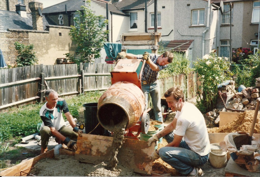

Onoff Posted July 14, 2017 Share Posted July 14, 2017 Take one duct down and bring it up in the rough corner of the first building. Put the second duct alongside and run down to wherever. My very first shed base circa 1990? I wasn't silly, rope in the FiL and a couple of mates and get behind the camera! IIRC the SWA was buried under the lawn and came up thru the slab in a bit of 3" plastic pipe. You can just see it on the left: Link to comment Share on other sites More sharing options...
