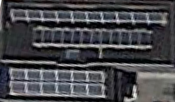

jack Posted January 20, 2023 Posted January 20, 2023 On 20/01/2023 at 07:32, Drellingore said: We need a 22kWp system to cover our own usage ... Expand Is there any particular reason to specifically target "covering our own usage"? I get why it's a target conceptually, but it's actually pretty arbitrary - there's no logical reason to assume that this is the optimal target when you take costs into account. I assume you're going for batteries too. Have you modelled how changing battery and array capacity changes the numbers? Is it possible that a smaller array with more battery capacity allows better usage? Where are you going to put the array? 22 kW is physically huge. For comparison, we have 8.5 kW and this is what it looks like on the (flat) roof of our house. For reference, the house footprint is roughly 160 m2: I assume have three phase? If not, you'll struggle to get approval to connect an array that big to the grid. Apologies if you've already worked through all of these questions, but 22 kW is the largest domestic array I've ever heard of! 2

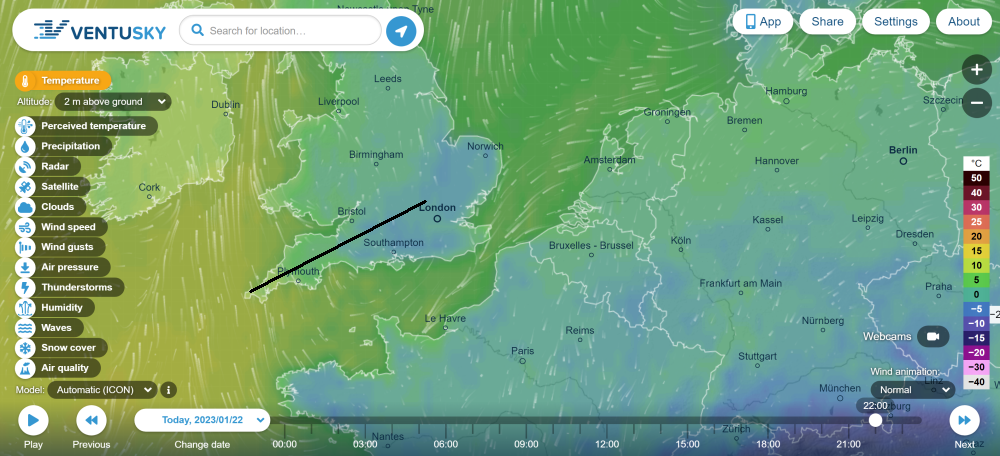

Marvin Posted January 20, 2023 Posted January 20, 2023 Hi @Drellingore Daily results for our 5.12kW system this January: Date energy 01/01/2023 1.36 02/01/2023 12.24 03/01/2023 0.45 04/01/2023 1.07 05/01/2023 3.00 06/01/2023 2.52 07/01/2023 3.00 08/01/2023 1.54 09/01/2023 8.42 10/01/2023 0.22 11/01/2023 4.33 12/01/2023 0.00 13/01/2023 12.31 14/01/2023 2.17 15/01/2023 7.52 16/01/2023 6.63 17/01/2023 2.62 18/01/2023 11.80 19/01/2023 14.16 So as @jack points out: its not a constant flow of energy. We looked at off grid and keeping our lifestyle... ho ho! Forget it without massive storage. If we covered all the roof both sides, the front and back garden and everything there would still be inadequate panel surface to supply what we require in the winter. I am with @Radian and wait for decentralised generation and more importantly decentralised storage. I also agree with @ProDave philosophy about self use being king. 1
tuftythesquirrel Posted January 20, 2023 Posted January 20, 2023 On 20/01/2023 at 09:43, jack said: For comparison, we have 8.5 kW and this is what it looks like on the (flat) roof of our house. Expand Sorry, have you got a better picture?
jack Posted January 20, 2023 Posted January 20, 2023 On 20/01/2023 at 10:11, tuftythesquirrel said: Sorry, have you got a better picture? Expand No, sorry. That's just a grab from Google maps. Bing is no better. I really just posted it to roughly show that an 8.5 kW array takes up more than 50% of a large flat roof. On 20/01/2023 at 10:05, Marvin said: I am with @Radian and wait for decentralised generation and more importantly decentralised storage. Expand We're tantalisingly close to having vehicle batteries form part of the grid. Our EV has only a 38 kWh battery, but that's nearly three times the capacity of the Tesla Powerwall 2. I know you wouldn't use it in the same way, but when EV batteries eventually come with two or even three times that as standard, that's a lot of energy on tap. My main concern is complexity. We have PV, an EV, an immersion diverter, an ASHP doing DHW and heating, FiTs, and a cheap overnight rate. The complexity involved with optimising that lot is already bewildering. What happens when we move to a more complex situation where you have all that lot, plus batteries, plus vehicle to grid, plus variable half-hour pricing both in and out?
tuftythesquirrel Posted January 20, 2023 Posted January 20, 2023 On 20/01/2023 at 10:41, jack said: No, sorry. That's just a grab from Google maps. Bing is no better. I really just posted it to roughly show that an 8.5 kW array takes up more than 50% of a large flat roof. Expand Sorry, thought you had splashed out on a drone😁
jack Posted January 20, 2023 Posted January 20, 2023 On 20/01/2023 at 10:43, tuftythesquirrel said: Sorry, thought you had splashed out on a drone😁 Expand Ha, no, but my neighbour is a cameraman and has a massive drone he uses for work. Might ask him to get some shots next time he has it out in the garden.
SteamyTea Posted January 20, 2023 Posted January 20, 2023 On 20/01/2023 at 10:05, Marvin said: 12/01/2023 0.00 Expand What happen?
Drellingore Posted January 20, 2023 Author Posted January 20, 2023 On 20/01/2023 at 09:43, jack said: Is there any particular reason to specifically target "covering our own usage"? Expand Nah, not really. It's an emotional starting point. We don't want to be off-grid, but we'd like to not need it. We've got a 3 acre field next door to try and provide as much permaculture food security too. Part of the rationale is to do my best to leave something to the kids and descendants that will be a 'safety net' of sorts - so they don't need to pay for rent, electricity, very basic foods, etcetera. On 20/01/2023 at 09:43, jack said: I assume you're going for batteries too Expand Yep. I'm just at the start of figuring everything out, but I was figuring a few powerwalls or equivalents. Annoyingly we've got 112kWh of storage in the two cars, but neither does V2H On 20/01/2023 at 09:43, jack said: Where are you going to put the array? Expand It's a 22m long barn with a south-facing roof - that's also ignoring the other building, which is on a north/south alignment. On 20/01/2023 at 09:43, jack said: I assume have three phase? Expand Yeah, there's already a three phase supply to the property. I'll need to figure out what goes on what phases, and all that jazz. I'm just at the beginning, really. On 20/01/2023 at 09:43, jack said: 22 kW is the largest domestic array I've ever heard of! Expand Yeah, we might have to register as a power plant (I can't remember what the technical term is). On 20/01/2023 at 09:44, Marvin said: Have you considered the distribution network operator (DNO) requirement for such a large system? Expand It's something we'll need to think about, for sure. On 20/01/2023 at 10:41, jack said: My main concern is complexity. Expand Agreed. Asking on a Tesla forum, others have done similarly complex systems, and unfortunately there's no decent book on the subject. 1
Marvin Posted January 20, 2023 Posted January 20, 2023 On 20/01/2023 at 10:49, SteamyTea said: What happen? Expand very cloudy
