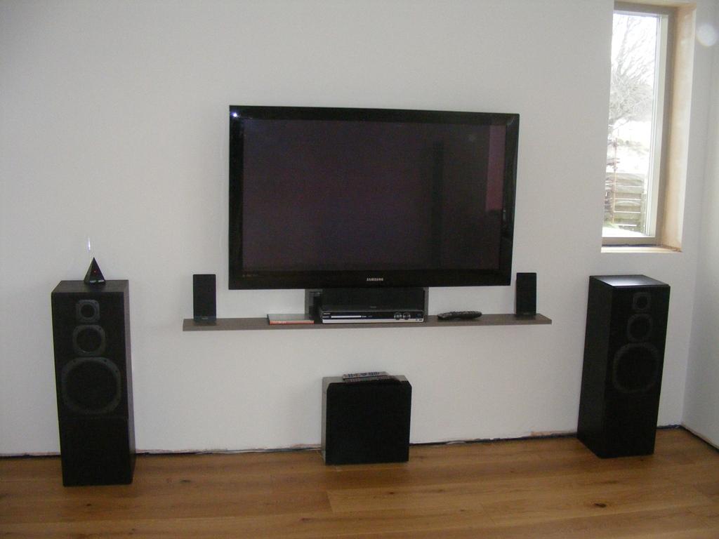

MortarThePoint Posted January 4, 2023 Author Share Posted January 4, 2023 5 minutes ago, ProDave said: Are you happy with the generally lousy sound from most inbuilt speakers in tv's or would you like a nice surround sound system? I would probably have speakers at the back of the room and a soundbar would be nice, but might be hard to keep it clean looking. Can you put a sound bar in a coffee table? Link to comment Share on other sites More sharing options...

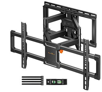

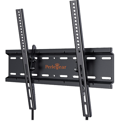

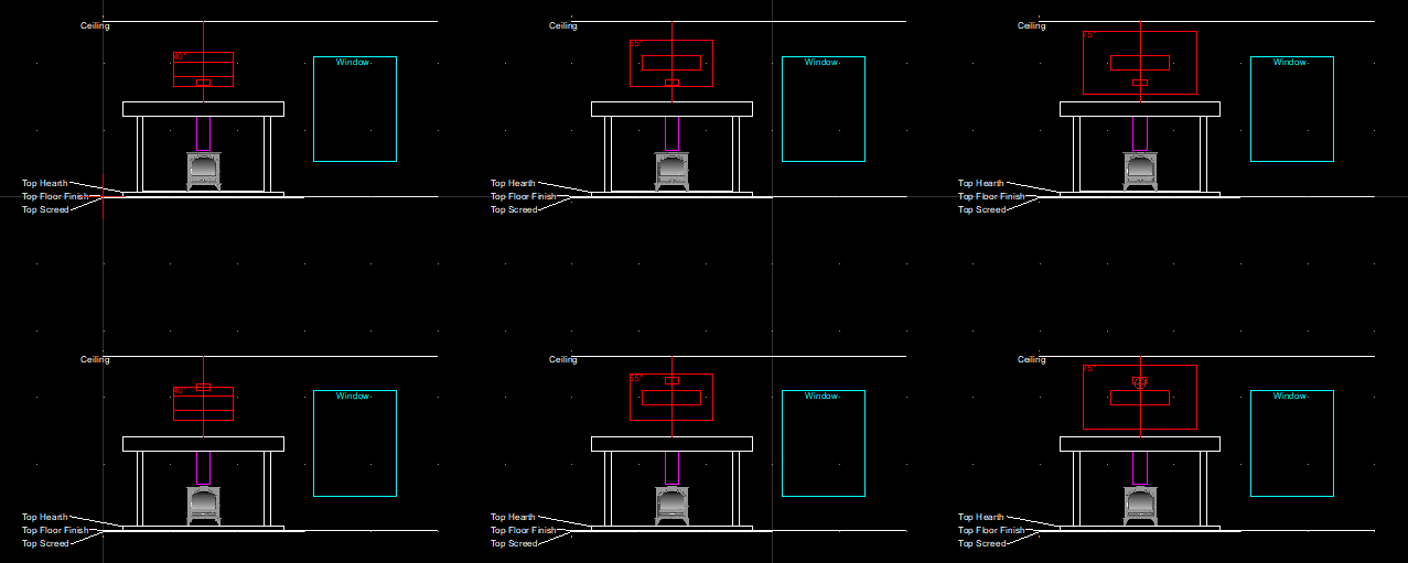

MortarThePoint Posted January 4, 2023 Author Share Posted January 4, 2023 These things are huge! A 55" TV is probably considered the minimum for a new TV and they start at around £250, Wow. Below are some layouts with the connections below the mount and above the mount as @ProDave suggests. In reality, the 40" TV would get raised up slightly. The mount shown is the Tilt one in the original post. The 55" and 75" options look more in proportion. Perhaps the 75" dominates the space a bit? The mantel piece shown is actually the Concrete lintel (215mm high) which I had thought to dress with something, but I guess it doesn't have to be exactly the same height. Link to comment Share on other sites More sharing options...

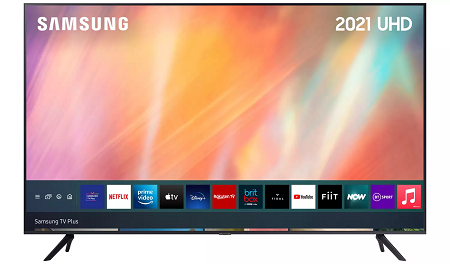

MortarThePoint Posted January 4, 2023 Author Share Posted January 4, 2023 (edited) Looks like you can get a lot for your money (£379), this includes all sorts. Last year's model but I plan to have it for more than a year 🙂 Under connectivity, it says "Optical connection". Is that for audio, i.e. SPDIF? EDIT: Seems to be https://www.argos.co.uk/product/9336342?clickPR=plp:2:74 Edited January 4, 2023 by MortarThePoint Link to comment Share on other sites More sharing options...

ProDave Posted January 4, 2023 Share Posted January 4, 2023 I dislike a television that high up the wall. It's a personal thing. Mine is at eye height. We have a clock above the tv now and I would hate to sit for hours looking up at the height of the clock. All the wiring hidden for various feeds (from the AV cupboard under the stairs) and for the surround sound speakers. Thats the surround sound amp in a pocket built into the wall under the tv. That's a 50" plasma. Takes 2 to lift it. Link to comment Share on other sites More sharing options...

Adsibob Posted January 5, 2023 Share Posted January 5, 2023 3 hours ago, ProDave said: I dislike a television that high up the wall. It's a personal thing. Mine is at eye height. We have a clock above the tv now and I would hate to sit for hours looking up at the height of the clock. I couldn’t agree more. I would really try to reconfigure your set up so that your tv is not above the fireplace. Ruins a fireplace as well! Link to comment Share on other sites More sharing options...
MortarThePoint Posted January 5, 2023 Author Share Posted January 5, 2023 10 hours ago, ProDave said: I dislike a television that high up the wall. It's a personal thing. Mine is at eye height. 7 hours ago, Adsibob said: I couldn’t agree more. I would really try to reconfigure your set up so that your tv is not above the fireplace. Ruins a fireplace as well! I agree, but it is a common choice these days. I was wondering if you could get an articulating backet that would allow the TV to be lowered by a couple of feet. I could make such a thing, but that would become a project in itself. Perhaps I should have a sofa that jacks up on stilts 🤣 Link to comment Share on other sites More sharing options...
Adsibob Posted January 5, 2023 Share Posted January 5, 2023 Why don't you put the tv to one side of the chimney breast, usually such rooms have alcoves either side, so it would go in one of those alcoves. We have just built some cupboards either side of our chimney breast and the one where the TV is, is angled so that the when the TV sits on it, it faces the centre of the room. We will then have a corner sofa on the opposite corner and still enough space for an armchair, coffee table etc. This way your TV and main sofa face each other down a central diagonal of the room, allowing you to place satellite speakers in the other corners (if you want) and allowing the fireplace to have its own space and the TV to have its own space, with neither affecting the other. Link to comment Share on other sites More sharing options...

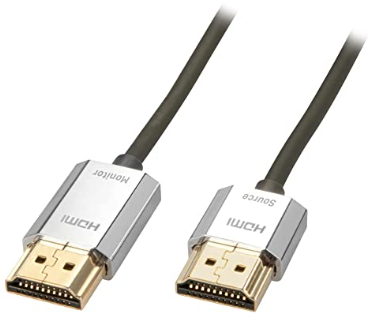

MortarThePoint Posted January 5, 2023 Author Share Posted January 5, 2023 These HDMI cables from Lindy are slim but importantly have a compact connector (7mm x 16mm apparently) that should fit through 25mm conduit. Up to 4.5m long. Not cheap at ~£10/m. Connector: Dimensions (approx.) WxDxH: 19x16x7mm (0.75x0.63x0.28in) 21x16x7mm (0.83x0.63x0.28in) for connector with chipset Cable: Jacket Diameter: 3.2mm (0.13in) Spec: Supported Bandwidth: 10.2 Gbps [so not 18Gbps] Maximum Resolution: 3840x2160@60Hz 4:2:0 8bit https://www.lindy.co.uk/cables-adapters-c1/audio-video-c107/4-5m-cromo-slim-high-speed-hdmi-cable-with-ethernet-p11688 https://www.amazon.co.uk/0-5m-CROMO-Speed-Cable-Ethernet-Black/dp/B01ANI2ICQ Link to comment Share on other sites More sharing options...

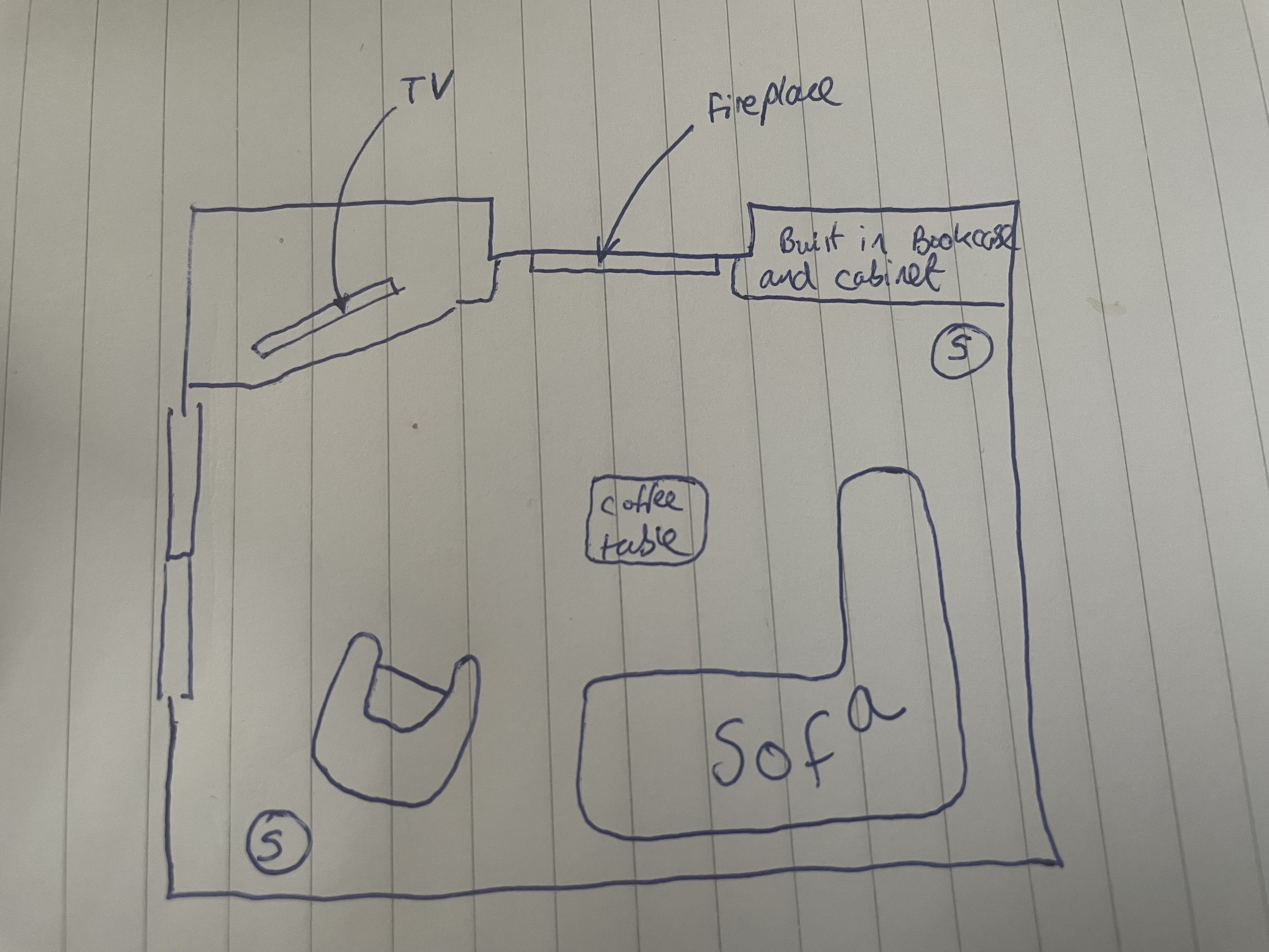

MortarThePoint Posted January 5, 2023 Author Share Posted January 5, 2023 6 minutes ago, Adsibob said: Why don't you put the tv to one side of the chimney breast, usually such rooms have alcoves either side, so it would go in one of those alcoves. We have just built some cupboards either side of our chimney breast and the one where the TV is, is angled so that the when the TV sits on it, it faces the centre of the room. We will then have a corner sofa on the opposite corner and still enough space for an armchair, coffee table etc. This way your TV and main sofa face each other down a central diagonal of the room, allowing you to place satellite speakers in the other corners (if you want) and allowing the fireplace to have its own space and the TV to have its own space, with neither affecting the other. I was wondering about to the side, but the room will be centred around the fireplace as the focal point. The fireplace is recessed as well. Link to comment Share on other sites More sharing options...
Adsibob Posted January 5, 2023 Share Posted January 5, 2023 (edited) 7 minutes ago, MortarThePoint said: I was wondering about to the side, but the room will be centred around the fireplace as the focal point. The fireplace is recessed as well. Can you post a drawing of the room shape/layout? Here is mine: The projections of the cabinets is initially equal, it’s just that the second then goes out at an angle to make a corner unit. I haven’t drawn it very well here. The Ss are potential spots for satellite L and R speakers. The corner sofa could also be curved, and the armchair could be angled towards the TV when you are watching TV or towards the fireplace. Edited January 5, 2023 by Adsibob Link to comment Share on other sites More sharing options...
Kelvin Posted January 5, 2023 Share Posted January 5, 2023 (edited) 22 minutes ago, MortarThePoint said: I was wondering about to the side, but the room will be centred around the fireplace as the focal point. The fireplace is recessed as well. TVs above fireplaces don’t work in my opinion as they tend to be too high. Fit a large picture above your fireplace to mimic a TV and then sit where the sofa will be. It’ll give you a better idea what viewing a TV will be like. If you have the space on the left of the fireplace put it there on a nice TV table. The house we’re renting has a large fireplace and a TV above it would ruin the look of it and be too high on the wall so we have our TV to the left of it and it looks fine. Our TV is a 12 year old Panasonic 42” Plasma TV which has a wide surround so it’s about the size of a modern 48” TV I guess. I think it’s about as big a TV we could get away with in the corner so placing it here will limit the size. Edited January 5, 2023 by Kelvin Link to comment Share on other sites More sharing options...

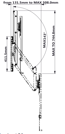

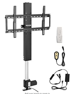

MortarThePoint Posted January 5, 2023 Author Share Posted January 5, 2023 (edited) I was just mentally designing a lowering mount and there they are: https://www.tranquilmount.co.uk/mounts/pull-down-tv-mount-uk/ https://www.amazon.co.uk/dp/B09Y2ZN3LH Here is a motorised pillar type: https://www.amazon.co.uk/dp/B08B1NT8M5?th=1 It is designed to raise a TV from behind a unit, doesn't look like you could turn it upside down and use it to lower a TV though. Perhaps it could be modified. Both stick out quite a bit though. There are all sorts of ceiling swing down mounts but that's not what I am after. Edited January 5, 2023 by MortarThePoint Link to comment Share on other sites More sharing options...

MortarThePoint Posted January 5, 2023 Author Share Posted January 5, 2023 (edited) I'll stop posting mounts, but here is a motorised one which is cool and allows about 580mm of lowing: https://vivo-us.com/products/mount-e-mm070 Reality is I'll probably not do it but wanted to collect the info here. Edited January 5, 2023 by MortarThePoint Link to comment Share on other sites More sharing options...
