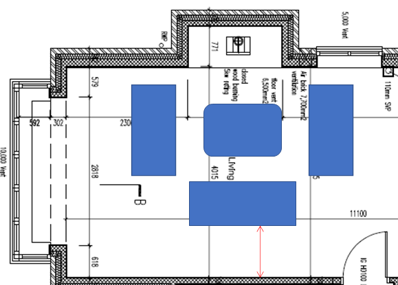

Here is a layout I have thrown together with two 2-seaters and a 3-seater targeting the closest I think a sofa may get to the fireplace. I doubt we would have that layout, but it is helpful to understand options. It has a 1m passage behind the 3-seater and the front of the 3-seater is 2.15m (7ft) from the fireplace. Your head would be about 2.7m (9ft) I guess.

11 hours ago, MortarThePoint said:
Can I ask, is the glass structure to the left of this drawing a window, or openable doors? Because if it is a window, I’m struggling to see why you couldn’t place a long sofa 1m or so in front of it, and place the tv on the wall at the bottom of the drawing (ie opposite the fireplace)? That still leaves room for the sofa you already have drawn to the right of the drawing and an arm chair somewhere in between the big window sofa and the fireplace. That arm chair can be angled towards the fireplace or towards the tv as and when needed.

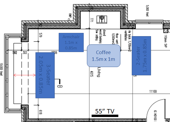

It's a bay window with a seat around its inside. Is the layout below what you have in mind? I wasn't sure which orientation you were suggesting for the sofa nearest the bay window. The TV could be on a swivel-able mount to allow it to turn towards the sofa.
More or less, yes this is what i had in mind. There are endless series of optimisations you can make to this layout by tweaking the sizes, shapes and styles of the sofas and then moving them around slightly, but I think placing the tv on the wall opposite, either within a media unit or on a media unit, is a very good start. For example the sofa by the bay window could be a chaise long style that is open on both sides, so as not to close off the window seat, e.g. like this:

Many TVs actually come on a swivable stand. My Sony Bravia 55" did, for example, allowing about 40 degrees in each direction.
