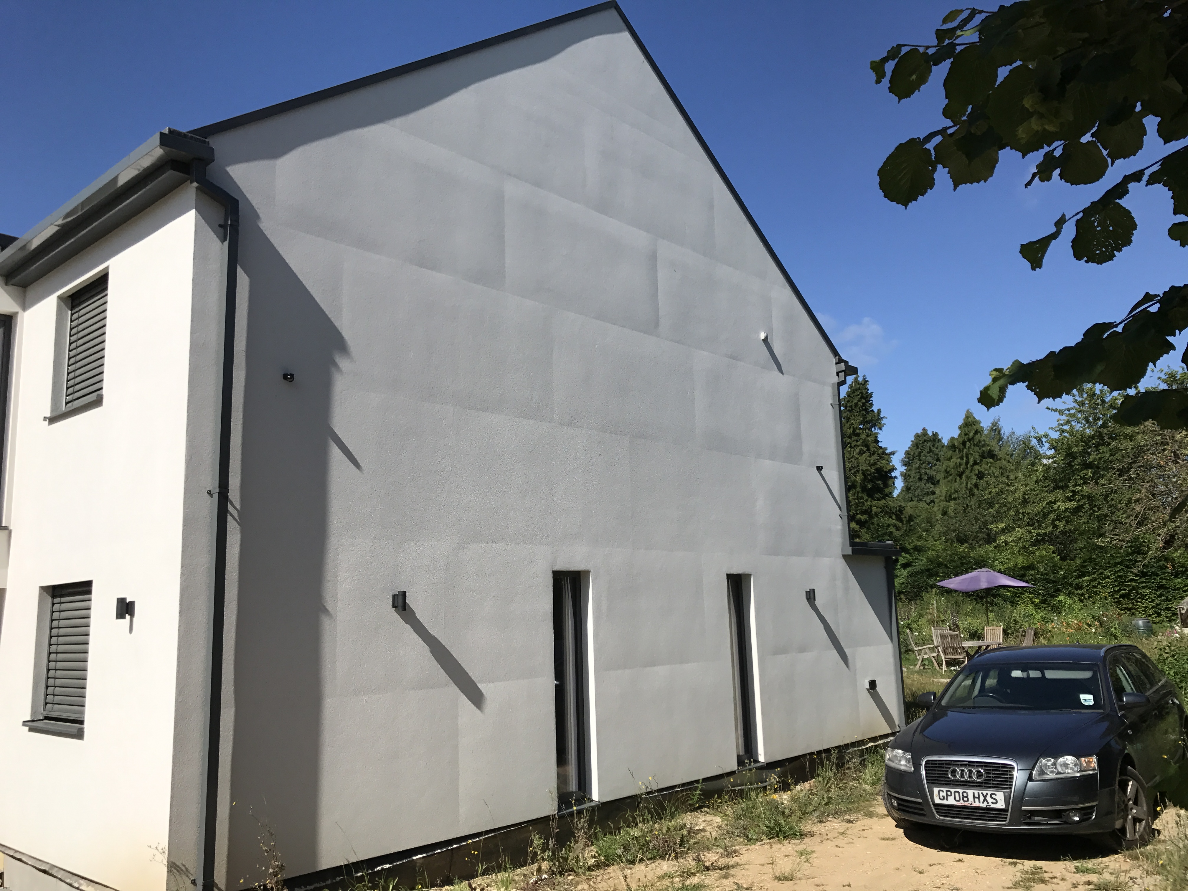

Bitpipe Posted July 12, 2017 Share Posted July 12, 2017 We had the frame renderd back in Dec 15 / Jan 16 just after the frame was erected. System is 25mm battens onto the MBC exterior panel, 12.5mm Gtec Render board, 4mm Parex Maite undercoat with mesh reinforcement, 4mm Parex Maite second coat and 1mm Parex DPR topcoat. Application went well, they were very diligent, only working when the conditions were suitable and the finish looked superb when complete. They were back a few months ago to do the garage and some other areas originally inaccessible. However this last few weeks I've really noticed the outlines of the underlying boards, especially in direct sunlight and wondering why this is only now obvious and how to remedy. Want to get some wisdom here before engaging with the contractor (who I've always found fair to deal with). I'm wondering if it's just the accumulation of dust on the render or something more serious. Have to stress, there are no cracks or blown areas etc and the problem is consistent across the house. Link to comment Share on other sites More sharing options...
Onoff Posted July 12, 2017 Share Posted July 12, 2017 Do you like the Tudor look? You could paint all those lines black.....I'll get me coat! Gently wash an area and see if it looks different? Link to comment Share on other sites More sharing options...
dogman Posted July 12, 2017 Share Posted July 12, 2017 Did they counter batten and were the battens kiln dried. Several manufactures say counter battening is a no no Also some boards need the joints taping before the first coat, were they taped? To me it looks like the board had a tapered edge have you a bit left to see Link to comment Share on other sites More sharing options...
Barney12 Posted July 12, 2017 Share Posted July 12, 2017 It looks to me as though the boards have shrunk at the edges or the render has pulled into the joints as its dried (and contracted). A bit like pulling a balloon tight over an uneven surface. You often see this type of result in an area that has been painted over and filled area. Its caused by the filler shrinking back over time and also the paint pulling into a differing substrate. Sorry, I have no idea if that's helpful as I know nothing about render systems. Link to comment Share on other sites More sharing options...
Bitpipe Posted July 12, 2017 Author Share Posted July 12, 2017 Thanks all. No counter batten, just batten onto the external panel of the TF. Boards were square cut, not taped but tightly butted up and the render process was pretty thorough, acres of green poly mesh between coats etc. I'll try and clean a bit to see if there's any difference - running my hand over its amost completely smooth, no noticeable depression. Strange thing is why it's only noticeable now - I'd have been straight on it even a few months ago when they came back to do the garage. Link to comment Share on other sites More sharing options...

Onoff Posted July 12, 2017 Share Posted July 12, 2017 How about some faux stitching and it'd look like a quilt / puffer jacket? Is this like the leopard spotting I've seen with some EWI? I'd be well peed off tbh. It's not to do with heat is it? (A weird analogy but the old Fibre Sports bonded on X-packs on Capris were ace from the Ford dealers. Aftermarket jobs affixed with pop rivets improperly, used to show up where the pop rivets got hot in the sun and showed thru the paint). Link to comment Share on other sites More sharing options...
Russell griffiths Posted July 12, 2017 Share Posted July 12, 2017 I think it is to do with a big flat panel the angle of the sun and the light colour. I bet if you put a straight edge on it, it will look really good with hardly any gaps behind the straight edge, but to the eye with that white you will pick it out. Have you ever looked at a poor spray job on a car? You can spot it a mile away in the right light, but at other times you would never know. Link to comment Share on other sites More sharing options...
Bitpipe Posted July 13, 2017 Author Share Posted July 13, 2017 Talking to Joe from MBC, he thinks its lack of expansion joints in the render board. Have taken it up with the contractor, will see what they say. I think the recent warm spell has exacerbated what ever the underlying issue is. Link to comment Share on other sites More sharing options...
jack Posted July 13, 2017 Share Posted July 13, 2017 11 minutes ago, Bitpipe said: Talking to Joe from MBC, he thinks its lack of expansion joints in the render board. 15 hours ago, Bitpipe said: Boards were square cut, not taped but tightly butted up Seems plausible. Hope you get the right answer from the contractor. Link to comment Share on other sites More sharing options...
Jeremy Harris Posted July 13, 2017 Share Posted July 13, 2017 That explanation sounds like the right one - the heat causes the boards to expand, and as they are constrained at the edges that expansion causes them to bow out. Once they've bowed out they may well have pulled the fastenings out a bit, probably the batten fastenings rather than the panel ones. That then stops the panels going flat again when they cool down. Link to comment Share on other sites More sharing options...
bassanclan Posted July 13, 2017 Share Posted July 13, 2017 Start with the contractor, they will get in touch with Parex, who will send a rep out who will know what has caused the problem and suggest a fix. 1 Link to comment Share on other sites More sharing options...
dogman Posted July 14, 2017 Share Posted July 14, 2017 Both the specifications that i had prepared by the manufacturers specified a movement joint at 1st floor joist level. They also stated a 3-5mm gap must be left between the boards for expansion. ProRend did not require taping but Knaff did Link to comment Share on other sites More sharing options...
Bitpipe Posted July 25, 2017 Author Share Posted July 25, 2017 Have had an email exchange with Parex rep (kindly supplied by PM) who confirm that the render board expansion gap is the likely issue, further compounded by the render board used not being one of their approved types. I need to review the site video and photos to see if I can determine the render board expansion gapping. My error was accepting the installer's spec and not knowing that I could/should have checked it with Parex first. So, installer is coming out to survey but feels like the remedy is to take it back to batten and re-do, which will be significantly expensive for them (especially when scaff etc is included) so I can't imagine them offering that willingly. Any suggestions on how to take the next steps to ensure that it's put right? Link to comment Share on other sites More sharing options...

Bitpipe Posted July 27, 2017 Author Share Posted July 27, 2017 Installer's site manager came out and straight away agreed that it's not right. He's bringing Parex rep (who I've also been talking to) on site and will discuss remediation with them. Best case is if they determine that the boards have moved as much as they will, in which case it's a re-application of a base and top coat. More serious if the boards themselves need attention. Stay tuned, must say I'm a bit more relaxed now that they're not running away from the problem. Link to comment Share on other sites More sharing options...
