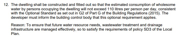

Dave and Helen Posted January 3, 2023 Author Share Posted January 3, 2023 Many thanks for all the feedback on this topic, and especially for the two of you who have provided me with some feedback on the company in question. To provide a bit more background, the main reason for investigating and seriously considering RWH is for two reasons. We can't install soakaways due to heavy clay soil, the lane that runs past our plot is called Bog Lane for a good reason. We also have a planning condition, that states that each person occupying the dwelling will not exceed 110 litres of water per day and then quotes a associated building regulation (copy of the exact working attached). We're also looking to run all the remaining surface water, and the output from our proposed water treatment plant into a ditch that runs alongside the plot, and across a couple of field before it enters a local reservoir. Despite our project being based around the refurbishment of an old Severn Trent pump house and water tank, we had to pay Severn Trent to install a water supply, which is metered. To be honest, I've not idea what the water charges in our area are like, but knowing we're on a meter and that we're required to be mindful of how much water we use, seems like reason enough to consider RWH seriously. I seem to remember Severn Trent also offering to pay us the installation cost back, if we could commit to reducing our water usage by the same amount, so that would be an additional bonus. The additional plumbing complexity is a concern, reading the company's Trusted Reviews has highlighted an issue with their pumps, but they've explained this as 90% down to the installation and the fact the pumps are having to work much harder than they should due to leaks, and that recent changes to the pump's 'programming' now enable the pump to switch off and require a reset if a leak is detected. I guess this is something to be mindful of. I would agree, a larger tank would be preferable, but their 7500l tank is the largest shallow dig tank they offer. I guess we could look at installing a larger one, but I guess this would mean more muck away. Thanks for all the comments! Dave C Link to comment Share on other sites More sharing options...
Thorfun Posted January 3, 2023 Share Posted January 3, 2023 4 minutes ago, Dave and Helen said: I would agree, a larger tank would be preferable, but their 7500l tank is the largest shallow dig tank they offer. I guess we could look at installing a larger one, but I guess this would mean more muck away. be careful about sizing the tank too big though as I was told by 2 separate RWH suppliers that the tank needs to overflow to get rid of 'stale' (if that's the correct word) water from at the top of the tank. if the tank is too big then it may never fill and never overflow. Rob @ rainwater harvesting did the calculations for me and suggested a 5000l tank for our roof size fitted the bill. Link to comment Share on other sites More sharing options...
