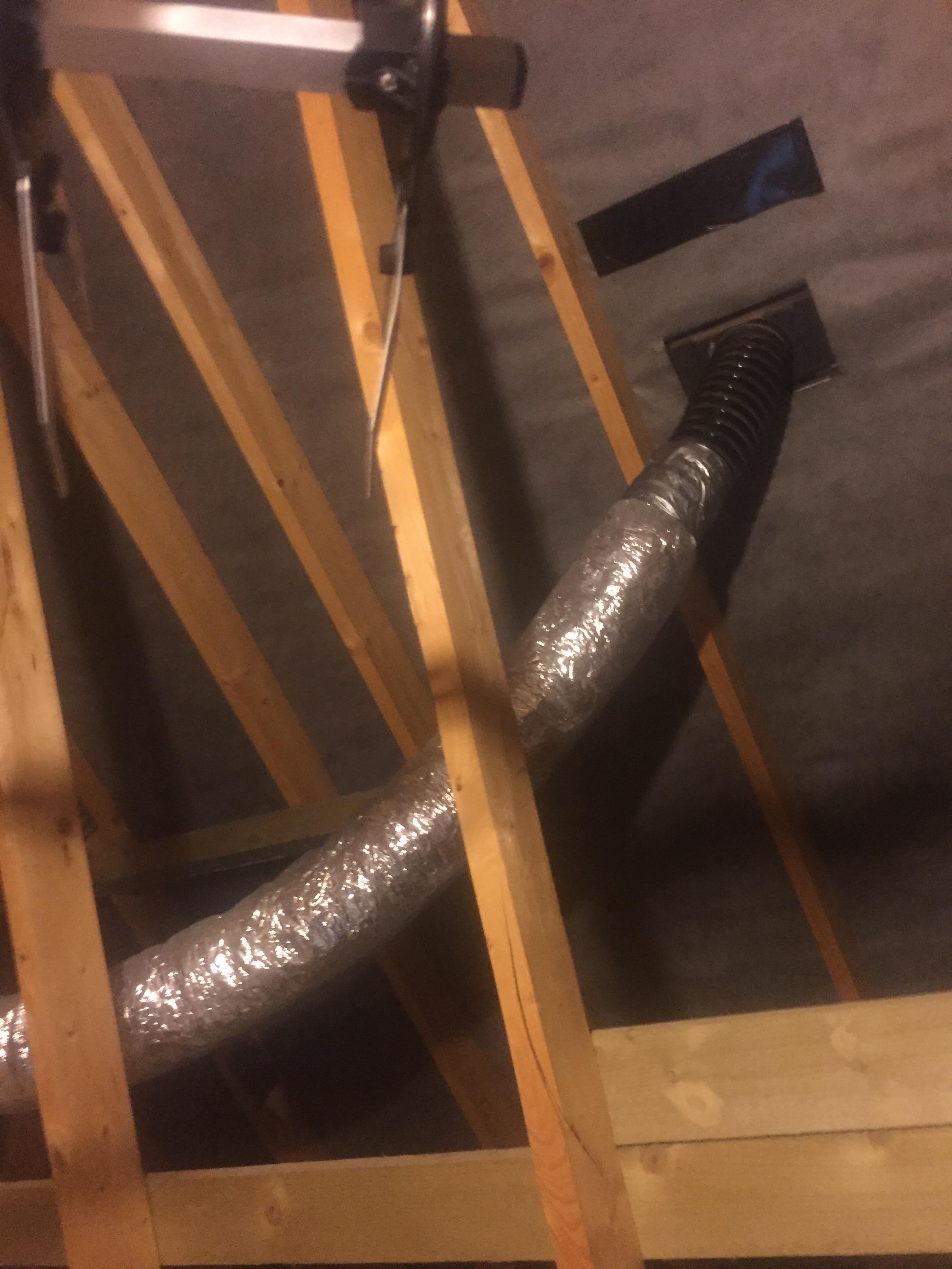

Thanks for the tips, the ducting used has the concertina effect on the inside. The guy rebalanced the air-flow but it made little difference. I clean the filters every 6 months, but I haven't checked the inlet and outlet for blockages though.
Could we see a photo of the ducting?

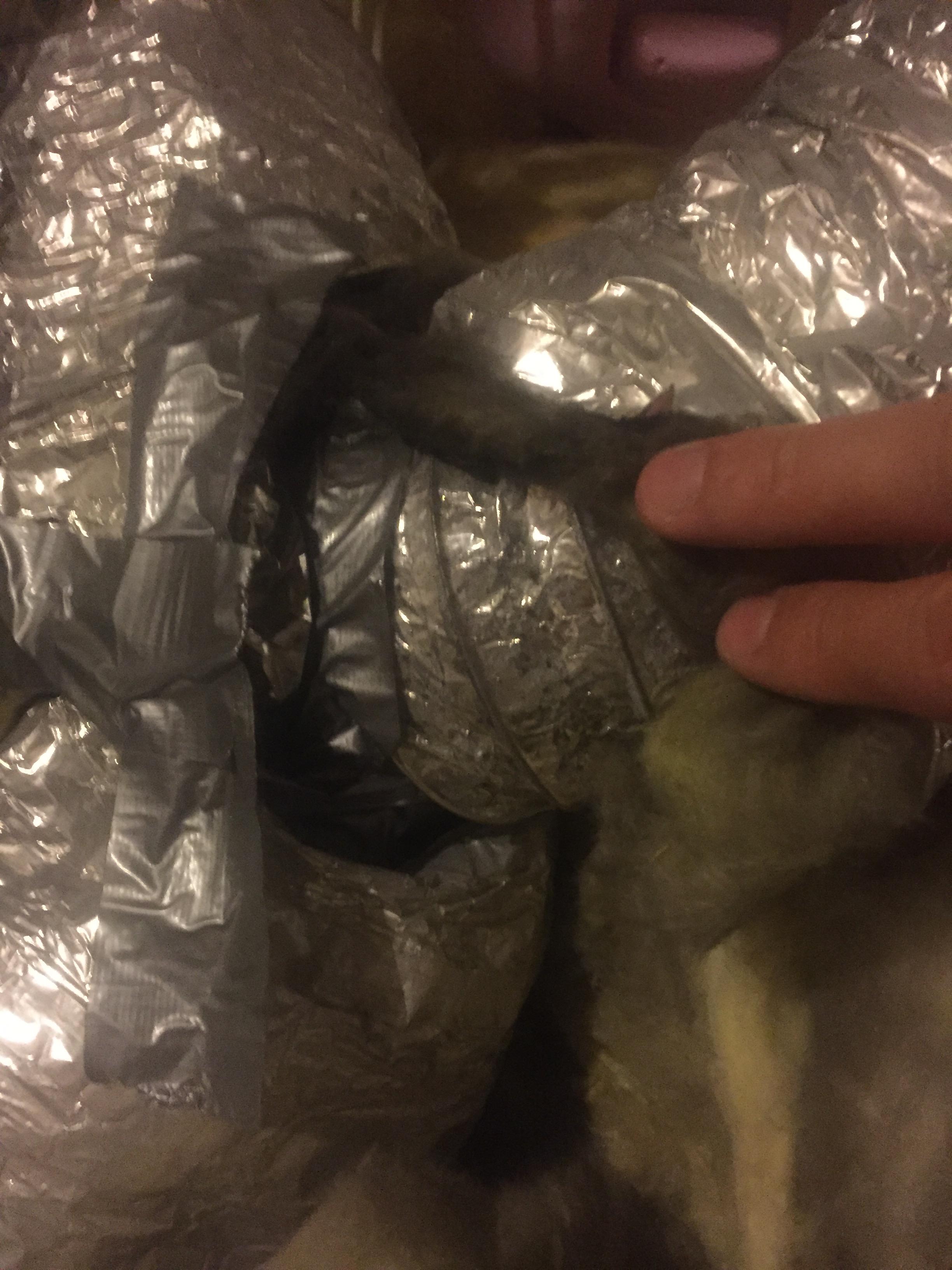

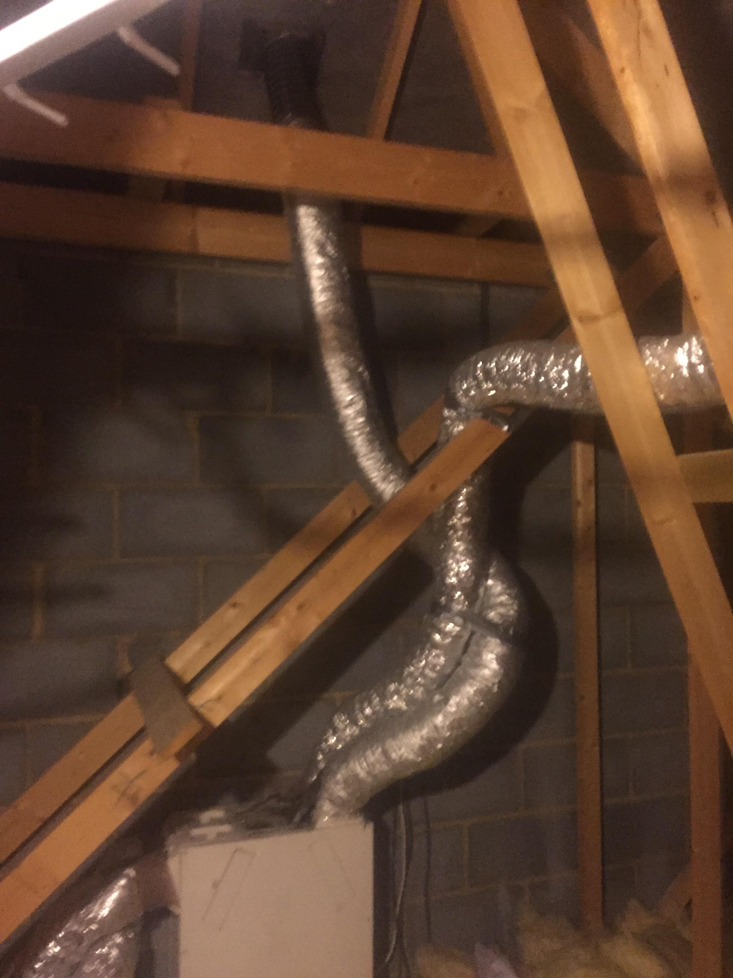

I haven't time to post on the calamity that is the ducting you've shown, but a base rate of 35L/second seems high to me. We have ~290m2 4 bed house, and from memory our unboosted flow rate is something like 20 L/second.  We regularly run it at less than that with no ill effects.

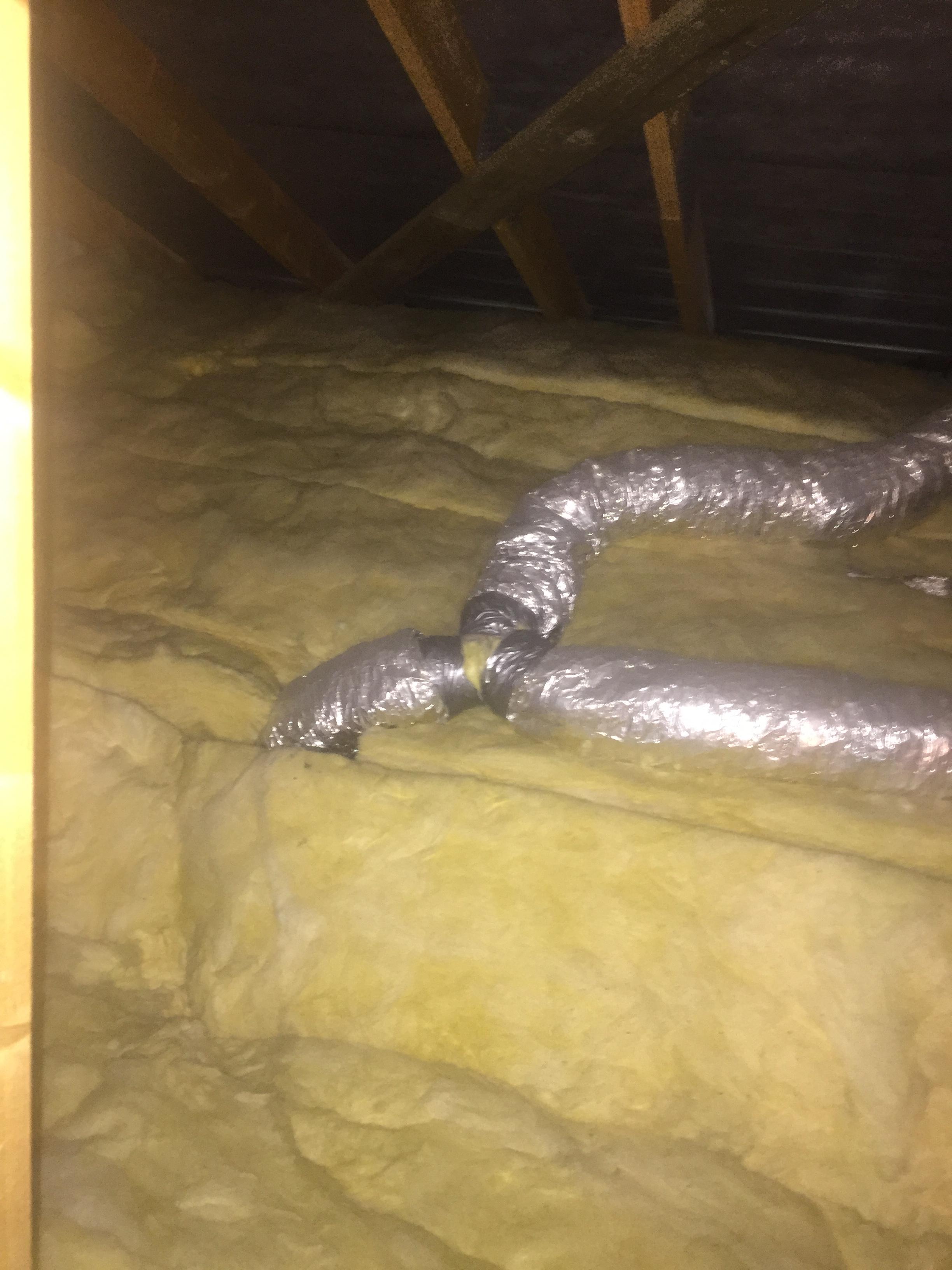

That ain't a pretty setup. As your unit is installed in a cold roof all them ducts should have insulation over them at the very least. The inlet and and outlet are fine without it but any duct serving a room needs to be covered or you will get condensation in it.
Can you show a pic of the distribution box where all the ducts join up???
The actual unit would need wrapping in insulation as well.
What is the Y connector doing in that pic??
They look like they're all 100mm nominal vs 150mm with insulation to me. Strange that the inlet and outlet aren't 150/200mm eg upsized.
The junctions should have been insulated and it looks like the branches tee off from the first runs, not good. Probably either not balanced or will be difficult to do so whilst keeping the noise levels down.
Hmmm ... I don't even think that is installed to the MIs to be honest ..!! If not you could tell NHBC to sort as it is a defect that should have been corrected.
Lots to sort there - but not difficult with a bit of effort if you are handy.
That is indeed as expected, totally crap ducting - the cheapest, nastiest possible way of doing the job.  That stuff is technically "insulated", but frankly the insulation is a bit of a joke, and the airflow resistance is high.

Thanks for the replies, I don't believe there is a distribution box, everything is run off the ducting coming from the unit. The Y connector is feeds off the first runs going to different rooms. It looks horrendous in comparison to other setups i've seen on here. If I get no where with the builders I think I may have a go at a refit myself...

It looks as if the system could be properly re-installed easily enough, using rigid ducting, and with much better duct insulation, plus insulation around the MVHR unit.  Ideally, the MVHR and as much of the ducting as possible should be inside the heated envelope of the house, but failing that it needs to be very well insulated.
