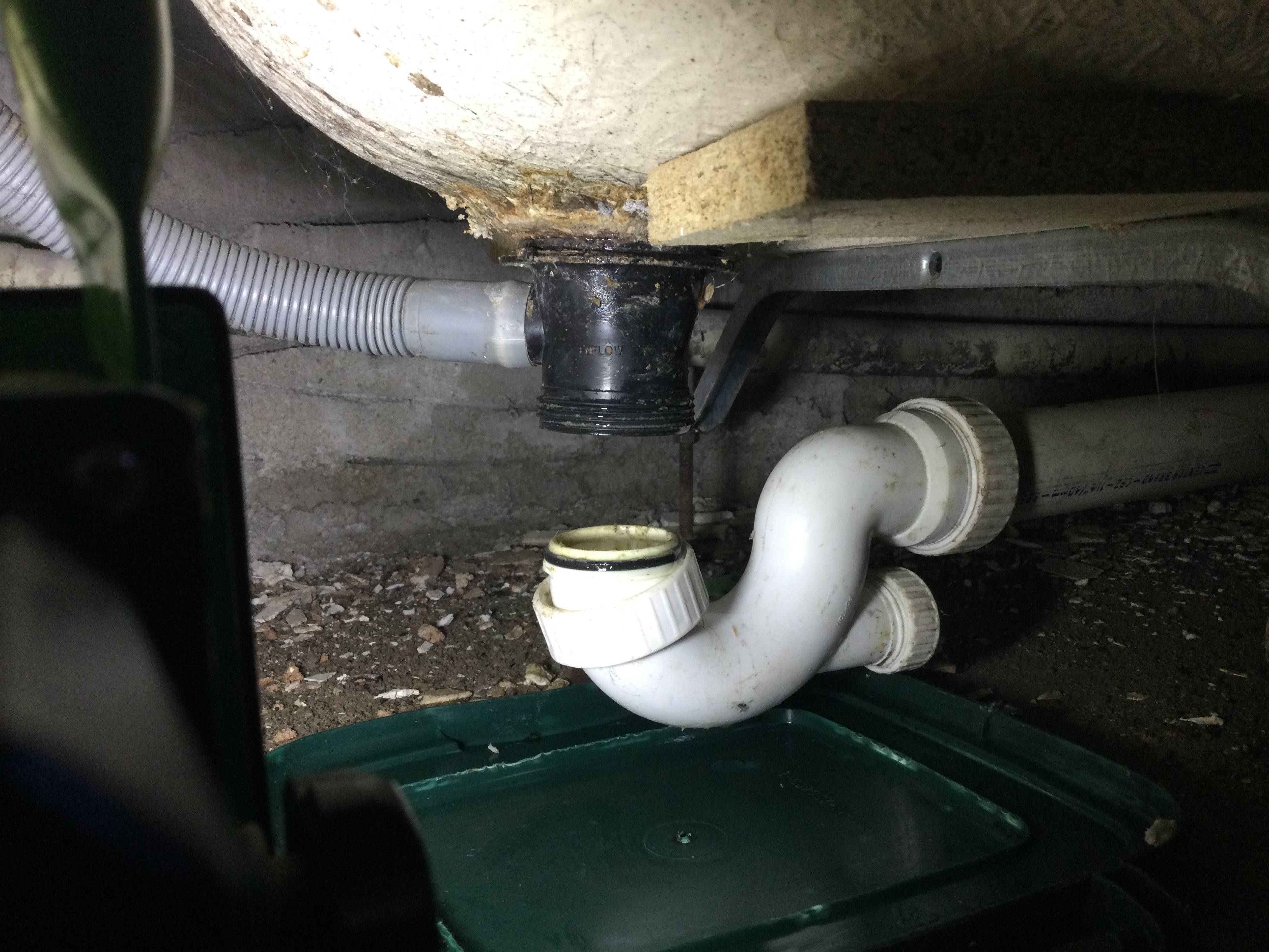

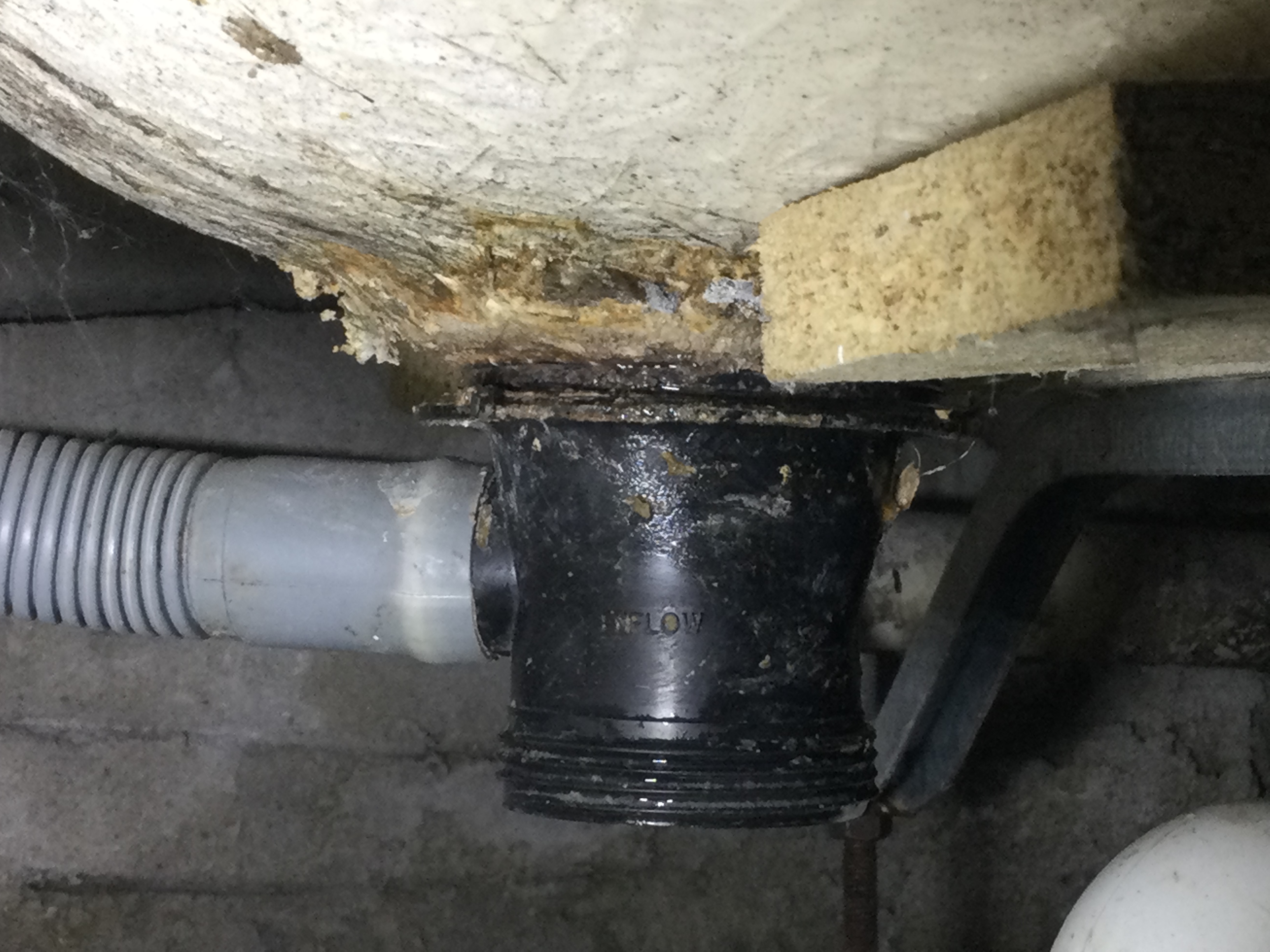

zoothorn Posted December 16, 2022 Posted December 16, 2022 Hi chaps, on this corner of BH. My full bath wouldn't drain, I now suspect related to the freezing temps (IE outside section blocked solid seems likeliest). Stupidly beforehand, I plunged the plughole assuming it was just debris-blocked. Water just exited via the overflow vent, back into bath, & water then started draining slowly.. but.. flooding my lino floor instead. Urgh. So the pressure I daftly rammed own, has surely failed a drain plumbing part below plughole area. So. Bucketed out water, removed side panel. I notice the leak is @ the black plastic collar immediatly below. To confirm this: I undid U-bend section below. This is full of water ( expected? I think so).. but drips from underside have stopped. The black collar seems made in 2 parts, as I can rotate the main body (with the overflow grey pipe on) around, leaving the top part fixed to the tub. It seems THIS junction is the leak @ rotation junction. And there's old orange seal stuff here too. I've looked at tubs, to try establish if they come with this 2-part black collar section, but can't find the answer. Could you advise on what to do? Thanks for reading, Zoothorn

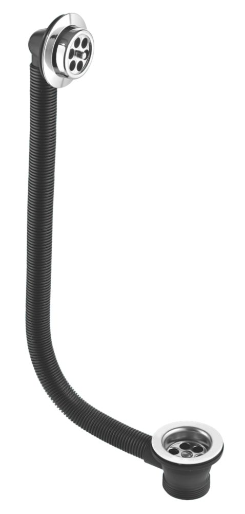

ProDave Posted December 16, 2022 Posted December 16, 2022 It looks like one of these https://www.screwfix.com/p/mcalpine-bath-waste-overflow-16/1236p As @PeterW says in the centre of the chrome bit the plug fits into should be a screw, which you undo the separate the two parts. A common mistake is over tightening. The "nut" in the bottom part is on a plastic web and over tightening can crack and weaken that.

zoothorn Posted December 16, 2022 Author Posted December 16, 2022 56 minutes ago, ProDave said: It looks like one of these https://www.screwfix.com/p/mcalpine-bath-waste-overflow-16/1236p As @PeterW says in the centre of the chrome bit the plug fits into should be a screw, which you undo the separate the two parts. A common mistake is over tightening. The "nut" in the bottom part is on a plastic web and over tightening can crack and weaken that. Hi ProDave, aha right. So essentially is this whole unit in your photo is bought as one, & I just need to buy a new one? Thanks, zoot

zoothorn Posted December 16, 2022 Author Posted December 16, 2022 17 minutes ago, ProDave said: Sometimes the whole outer chrome bit of the overflow unscrews like a big nut threaded onto the plastic bit. Got it/ jeepers hard work that. Ok the removed black main bit has ENFLOW enscribed. Can I just assume the new screwfix one will be the correct diameter thread, to join my U-Bend below ? I mean Enflow suggests its mfr was reasonably recent, I think?
zoothorn Posted December 16, 2022 Author Posted December 16, 2022 Ok I need help on the lower thread diameter. No screwfix type ^ available. I find a similar one @ Toolstation, but says " 1-1/2" " . I measure across my old thread= 1-7/8". Urgh. So I wonder if this 1-1/2" figure is relevant to the thread at all. Maybe just the body width. Anyone know what the dim I'm aiming for is? Surely these u-bend sections have an industry-standard-size thread?? Am I measuring across -this- thread on the u-bend? And across the very outer part? Thanks, Zoot

ProDave Posted December 16, 2022 Posted December 16, 2022 Just buy it, it will fit, in the UK there are really only 2 sizes, bath and basin. You would be very unlucky of you had a non UK bath waste and trap fitted. UK waste pipe sizes annoy me, just look at how many different sized "40mm" pipes there are available. but at least the screw thread fittings for wastes and traps is pretty standard.
Onoff Posted December 16, 2022 Posted December 16, 2022 The basin size is usually 1 1/4", bath is "1 1/2".
zoothorn Posted December 16, 2022 Author Posted December 16, 2022 1 minute ago, ProDave said: Just buy it, it will fit, in the UK there are really only 2 sizes, bath and basin. You would be very unlucky of you had a non UK bath waste and trap fitted. Well this is kinda what logic tells me too.
zoothorn Posted December 16, 2022 Author Posted December 16, 2022 1 minute ago, Onoff said: The basin size is usually 1 1/4", bath is "1 1/2". But my 3rd photo can't possibly be considered a 1-1/2" pipe.. this is strange.
zoothorn Posted December 16, 2022 Author Posted December 16, 2022 Page 13.. out of.. 88?! Omg I feel so vindicated!
ProDave Posted December 16, 2022 Posted December 16, 2022 That is not where the pipe fits, that is where the trap screws on, it is not intended to take a pipe int there. the outlet of a trap is a compression fitting with a rubber seal with enough flex to accommodate the different sizes of "40mm" pipes
