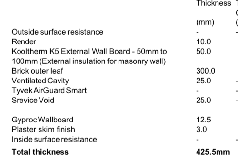

Adsibob Posted December 16, 2022 Posted December 16, 2022 Wall has been bordered up and partially plastered. Lost the photo showing location of copper gas pipe. Need to know fairly precise location as wall is to be covered with wall mounted cabinets. I know roughly where the pipe comes into the house from the outside. I also recall it then travels upwards in a vertical line, before making a right angle and travelling horizontally across the wall. But I don’t know the point on the wall where that right angle is. The relevant wall construction is i think the copper pipe is in the ventilated cavity, rather than in the service void. So from the inside of the house, it is behind the aluminium. Potentially complicating matters, we used metal (I presume steel) studwork, directly behind the 12.5mm plasterboard, so a metal detector might not be able to distinguish between the studs and the vertical pipe. I say “potentially” because I’m hoping there are metal detectors which can detect non-ferrous metals such as copper, whilst ignoring ferrous ones such as steel. Are there such metal detectors? Any other tricks of the trade to locate a hidden pipe?

Adsibob Posted December 16, 2022 Author Posted December 16, 2022 1 hour ago, joth said: Smash a long masonry nail through the wall in the place you least think the pipe will be. Guaranteed to locate it. You could try running the gas appliances on max and then using a thermal camera. It may show a cold line. If you're covering the walls in cabinets you have scope to make some exploratory holes through the finishes to locate it. It'll all be covered up anyway. Love how electrics have safe zones that ban random 90° bends but a gas pipe you can put wherever you want. I don't suppose there are any sockets on that wall and they're lined up to share safe zones of the pipe? Not sure if that'd be legal but on one level it does make sense. Thanks. There is one socket on the wall, but it is nowhere near the pipe. The plasterboard is mostly unplastered so pretty easy to cut into it to explore, problem is that i think the pipe is behind the Tyvek foil and I don’t want to compromise that. I guess the thermal imaging camera could work, but would prefer a metal detection solution.
